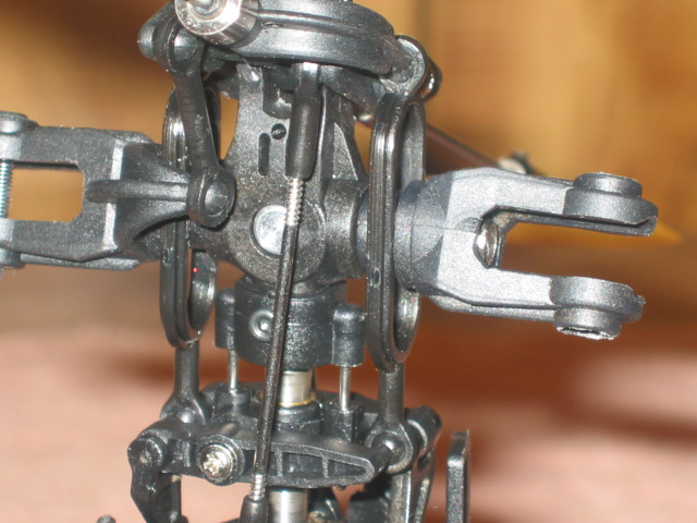

Crashcrash,
Your lucky and so is the son. The son IS paying you back, that's lucky. And your son's lucky that he has a father that takes the time and interest with him, plus your knowledge base, he's got a win win situation with the helis.
Gyro plug, I never would have notice that it was loose, if I hadn't posted that picture. So much for my DETAILED P-M. LOL! Man learn stuff everyday, my sad part is, I work slowly on the heli all the time, so it is just perfect.

J-MICHAEL,
The cold weather is tuff on the helis. Makes all the parts start to contract after awhile and can give all sorts or wierd problems. Soo, when flying in the cold weather and it starts acting stupid on ya. Don't blame the heli or yourself, just old man winter.
As far as the rotor head, if you move the flybar paddle up and down, thru it's full range. And there's no binding and no hard resistance, you fine and dandy. Oh, that's in the house, not in the cold.

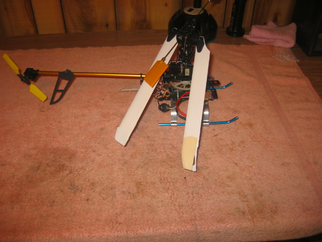

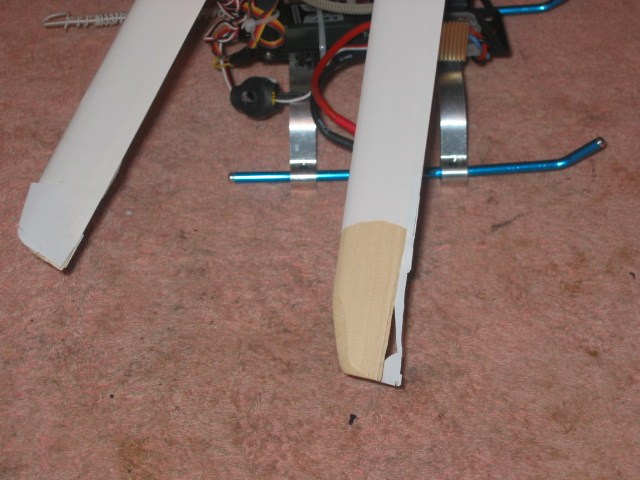

Lookyj,
I'm trying to keep up with ya!
Yep, broke another set of blades. NOT on the POOL table. It was the DARN bookcase!
Big hunk of wood out of one of the blades.
Soo, the GY401 test, on the HBK2, is off for a couple days, till I get some blades.

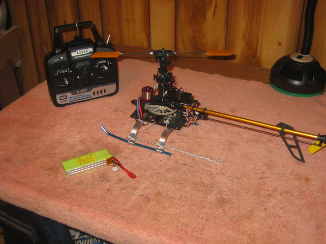

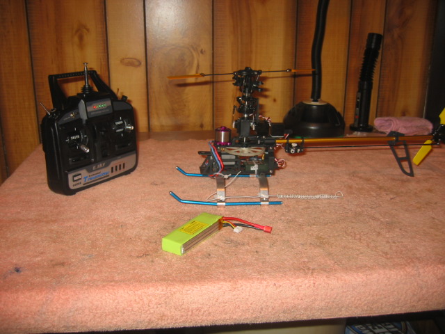

Here I am, NEEDING HELP
Flew both the HBK 2 s with the 1500 mAh and did real well with both. RUSTY ROBERTSON strongly suggested that the batteries are a tad TOO HEAVY and if I returned to the 1100 mAh the flight would get MUCH BETTER.
So I changed back to 1100 on the White HBK 2.......and experienced something NEW and TROUBLESOME..... when the Heli gets AIRBORNE it goes into a SHAKING in the longitudinal sense, something like a BUCKING HORSE !!!!
to explain further, it seems to dip forward and flip backwards in quick movements, like shaking. Can't find better words to explain. If this is NEW to y'all I may do a TAPE of this problem.
ANYBODY KNOW WHAT THIS IS ABOUT ? Today is DEAD CALM and I am going to try the Yellow one, both with the 1500 AND the 1100 after that.

.........hello to all the BOBs ..... RICK hereIT's BEEN A QUIET WEEK AT LAKE WOEBEHOUSTON !
XMAS rolled around and the LADY FRIEND ! ( my age...can't be a* GIRL* FRIEND, right?) .... decided to spring for one MOSQUITO, in the case my own broke, and needed replacing. Well.... RADIO SHACK gave her a heavy discount ( sold it for $ 20.00 ) and added one more for good measure, to get rid of all the stock of toys, then threw in two boxes of replacement blades. Like a bandit ! see pic.
Mosquito are really just a TOY, but the are TOTALLY CONTROLLABLE and very responsive. They lack nothing in maneuverability, compared to any others.
Now I APOLOGIZE for the poor piloting I am showing in the tape....I have been OFF practicing for more than one month and it PLAINLY SHOWS. The real purpose of the tape is to show just how bad the white HBK2 "shakes".....
Now I NEED TO FIGURE out how to stop the shakes.... somebody HELP ???
HERE'S THE TAPE : http://www.youtube.com/watch?v=7bJTctUKwTc
I am always WITH Y'all and AMAZED at the advancements made. I am being left a CENTURY behind. J MICHAEL is truly amazing. LOOKYJ is now out of our SCOPE. He is a PRO

Great videos and yes you have "tail bobbing" pretty bad. Love the picture of you and your lovely young grand-daughter.
I've attached a couple pictues of the rotor head. As mentioned by ArrowNaugtic and Cx2cp+, try the lube first and give it a quick test flight. You should be able to move the flybar paddle, up and down, by hand, through it's whole range with no binding whatsoever.
If there is binding, you will have to back off the 5.5 mm (I'd try 1/8 of a turn, then retest) nut in the grip(see picture).Check all those tiny links on the rotor head and make sure none of them have popped off. If all that checks out, it may be due to a bent feathering shaft/spindle. I don't think weather was a culprint here, the other HBK2 flew great, and the kids in the background going down the street weren't all bundled up.
Dave / Choppersrule
Dave / Choppersrule

Agreed Dave.......I honestly think its either no lube in the blade grips/feathering shaft or the grips being too tight. That is a classic example of grips " catching" and causing the tail bob.
Rick........ I gotta laugh....... that dog that come by when you were hovering the white one......... had to be one of the heavier doggies I have seen in awhile. The kid at the beginning of the video.....hauling a bike on his handlebars of his bicycle..... Is he another one of those that lives by the standard "always carry a spare"?
Dave and cx2cp+ hit the nail on the head, they gave you the 2 classic fixes for your issue.

It's suggested to use a Teflon Spray for the rotor head, due to the fact of the rubber, that oil may soften the "O-Ring" in the rotor head.
WD-40 won't due, it's not a lubricant, it's a penetrating fluid and water displacement agent. Hmmmm, however, I've used Tru-Oil and never had a problem with "O-Rings" getting soft. Sewing machine oil, 3n1 oil, something light. Before you oil stuff up. Did you move the flybar up and down to see if it's binding or has alot of resistance. Lubing up, still wouldn't be a bad idea. To do it 100% properly, you have to remove the blades and remove the grips. Cuz, there is a bearing and a thrust washer inside the grip.
Or you can cheat the system and apply the oil a little heavy, move things around and wipe off the excess with a cotton ball or Q-tip.
I never do that!!!!(Yes, I do
) If you don't take the rotor head assembly apart, just oil, generously, where the blade grip contacts the main rotor head. And Dribble
, some into the blade grip, where the blade grip nut is. Dave / Choppersrule
