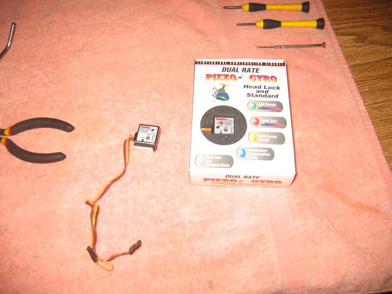

Got a tiny problem on the HBK2. I think it's either a tail servo going sour on me. or the telebee gyro.
There is absolutely no binding anywhere. You know me on SET-UP. At take off and in a solid hover, everything is okay. If I make a snap 90 degree turn, left or right. The tail will pulse back and forth for about 2 seconds and then be solid again.. Not a tail wobble all the time. The pulsing of the tail is only 1/2 inch in each direction at most. Happens too, on a piro.. I've adjusted the gyro screw/srew(JAY)
left and right to no avail. Hmmm, what's your best guess, gyro or servo, has to be one of them suckers.

Dave, did you check the gain adjustment screw?
I'd bet Gyro. I have the telebee and I have the same issue but only when coming out of FFF into a hover the tail wags back and forth like a happy dog. I've tried all adjustments and to no avail. When you find it please let me no, it drives me nuts[&:] I haven't noticed it when doing piros though.

I've adjusted the gyro srew(
) numerous times and had no effect. I'll go with your gut feeling and install a new gyro. Just happen to have one..

BTW, I'm betting on Gyro too. Let us know how you make out.

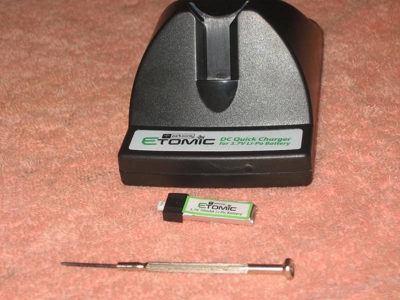

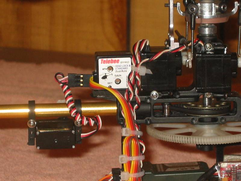

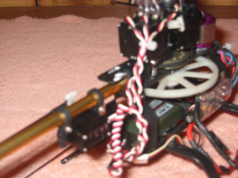

Jim and Jay,
You both hit the nail on the head... It was the GYRO. I installed my spare, made a test flight/hover, with snap 90's and piros in the basement and all is well and fine. I can't complain, the gyro is about a year old and has a zillion flights on it, and a lot of crashes too. With that in mind, the telebee is still a great Gryo.. A ten minute job and you have a new heli.
Pictures: 1: old and new gyro 2: gyro off (bad pic) 3: new gyro on 4: My Vapor battery charger and battey. The batt. is tiny little.

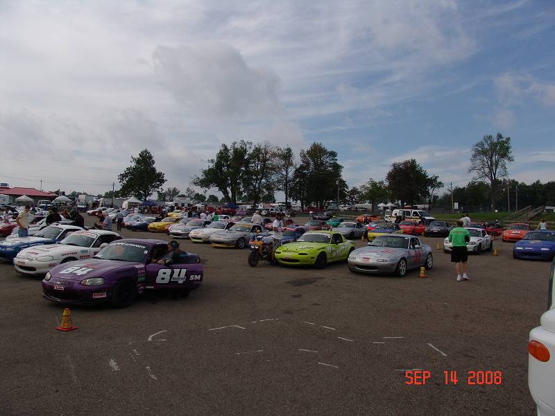

Here are some more weekend racing photos
1st one is the Spec Miata grid(63 cars racing at once) 2nd is a Mustang from the American Iron class. The last 2 are from the team I worked on(last one is a crazy fast RX-7)
