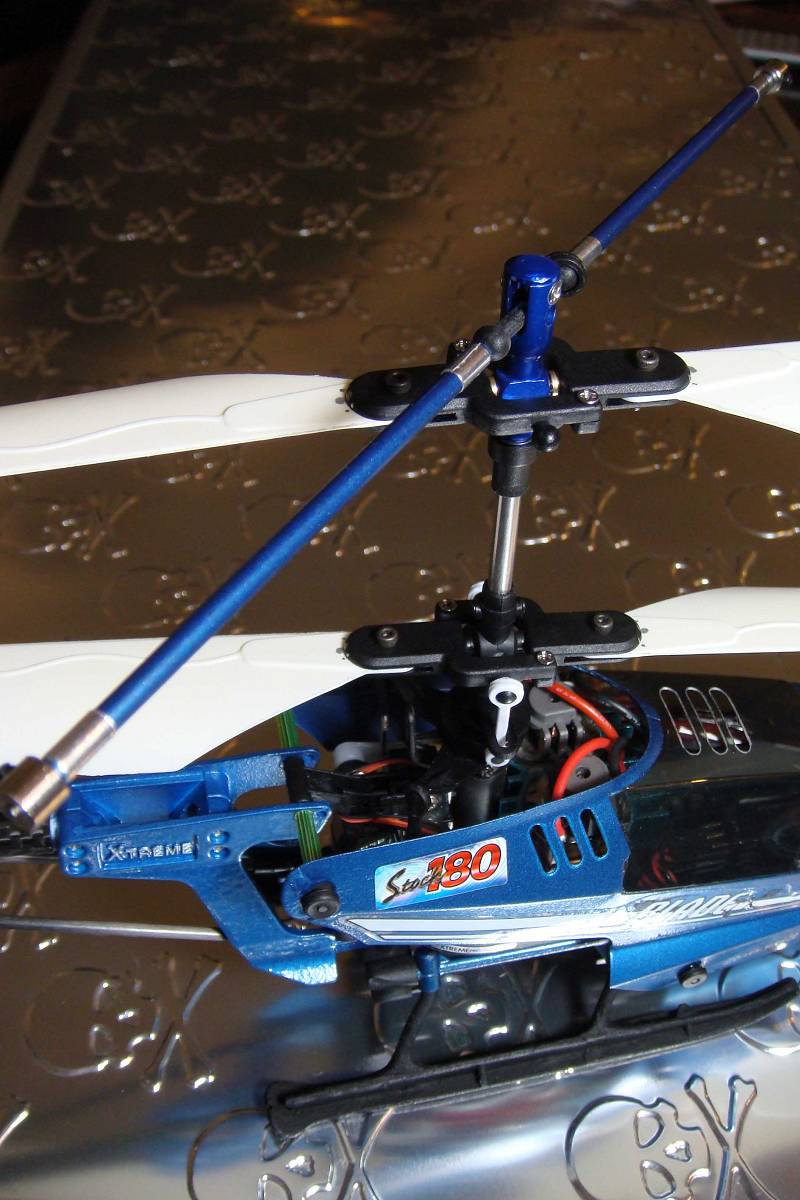

Hope these come out ok. I have attached some pics of the installation as well as crappy instuctions. Note it says to not use a upper bearing holder but nothing is provided to make up for that. They say to use washers with arrows pointing to places but one arrow is marked out.
I have never disassembled this bird lower then the lower head. The swash plate has never been removed since new. I have crashed it to the point of blades and heads brakin but not much more. The heli flew fine before mod . It is right now all apart again, being a aircraft mechanic I will figure this out but only with your help.[img]

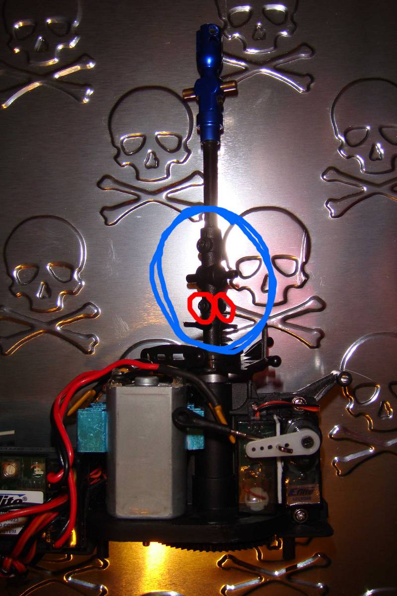

From the description of your problem is sounds like you have a seperated swash plate which will cause unknown and random control just like you described.
Thanks to the picture you posted I can clearly see that your swash plate has seperated. If you squeze the swash plate back together it should fix the problem.
-jamie
boomtownhobbies
-jamie
boomtownhobbies

I cropped one of your pictures and circled the problem area. Normally the swash plate does not look like that. It has become seperated. A seperated swash plate will casue random control.
jamie

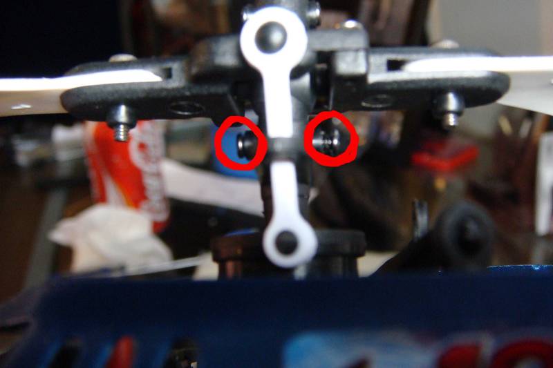

There are two things that will help.
1. Your swashplate is way off you need to get that leveled and check to make sure that its not seperated like what stersman says. This thread will help http://www.rcgroups.com/forums/showthread.php?t=642401
2. Once leveled you need to adjust you lower assembly head bottom screws. Make sure that the top screws are in the inner shaft holes and just readjusted the two screws on the bottom.
Step 1. Mark one of the bottom screws with a marker. So that you can tell them apart.
2. loosen one screw with a 1/2 turn.
3. tighten the opposite screw with 1/2 turn.
4. test fly and see if it got better or worse.
5. if its better then repeat steps 2-4.
6. if its worse then tighten and loosen the oppsite screws starting with a one full turn. then restart at step 4.
I've marked the screws that need to be adjusted in the picture below.

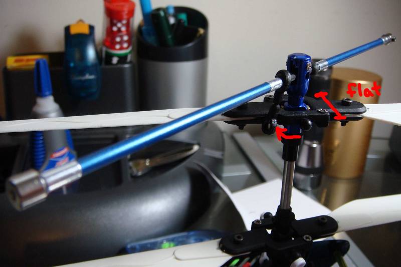

flick the flybar off, and put the link the other side, it has to "lead" the blades. When using stock blades, then changing to the xtreme knock backs, its the only way my bird will fly. It will take about 5 mins to do, are you sure the top blades are tracked, there seems to be a lot of thread visible compared to mine on the rod?
Either way you put the flybar link it will always lead the blades
but pamdevlin is right about being a bad flybar link
With the extreme setup the stock flybar link is too thick and has to be shaved flat and the link also has to be extended till it will "see-saw" evenly.
That problem was causing my heli to drop when I make sharp moves. It restricts the flybar from tilting fully one way. Taven, tilt your flybar both ways and you'll see what I mean.

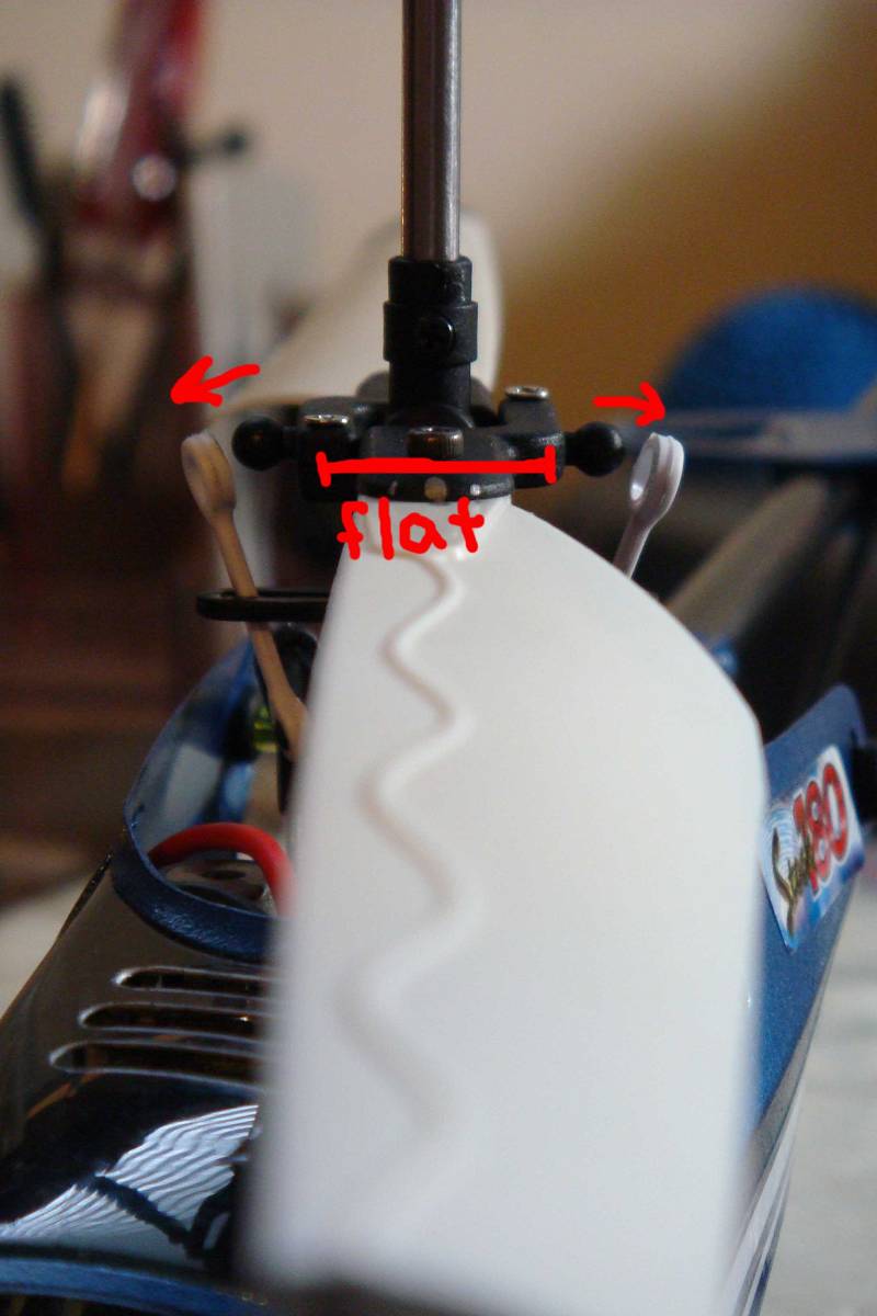

Here are the pictures of the flybar link.
You need to shave one end flat so that the link has more free play.
The grips are much wider then the stock blades. It causes the link to hit it.
Make sure you adjust the length of the link so that it extends far enough to push the flybar up (opposite end down). Adjust the link till both ends of the flybar have about the same see-saw distance between it.

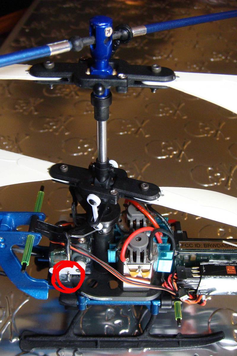

I reset my servo control arm back to the frist hole and moved the (foward and back) servo arm two holes from the center.
Anything more then that I can't control or the heli can't handle it and goes crashing down.
The third picture is just to show off [8D].
Thats all I got for now, I'm still having problems with TBE, but after all these adjustments, I don't want to take my heli apart to find the problem. Its probably in my inner shaft.

Day 3 with extremes [
].............well I can get it flying good and get a desent hover. Its got great power, but overall stablility performance is poor. Either its me and my setup or its just too much for the cx to handle. I have to always fly cautiously and continually give slight counter adjustments while in flight. Any sudden response will send the heli into an unrecoverable dart [:@].
I spoke with the dealer (bladecx2.com) about my issues and he stated to me that I need the whole extreme assembly core. He told me the blades/grips are just spares for the core. He was very polite and understanding and would accept my return if I requested.
Taven, I'm not sure if you can spare that kind of time. I would strongly consider getting the whole Extreme core setup or try different blade/grips maybe Xtreme. I've spent over 8 hours working installing/tunning/adjusting/replacing/repairing. Since I'm all out of heli funds for this month I think I'll have to return to stock blades.
Keep me posted
].............well I can get it flying good and get a desent hover. Its got great power, but overall stablility performance is poor. Either its me and my setup or its just too much for the cx to handle. I have to always fly cautiously and continually give slight counter adjustments while in flight. Any sudden response will send the heli into an unrecoverable dart [:@].I spoke with the dealer (bladecx2.com) about my issues and he stated to me that I need the whole extreme assembly core. He told me the blades/grips are just spares for the core. He was very polite and understanding and would accept my return if I requested.
Keep me posted
