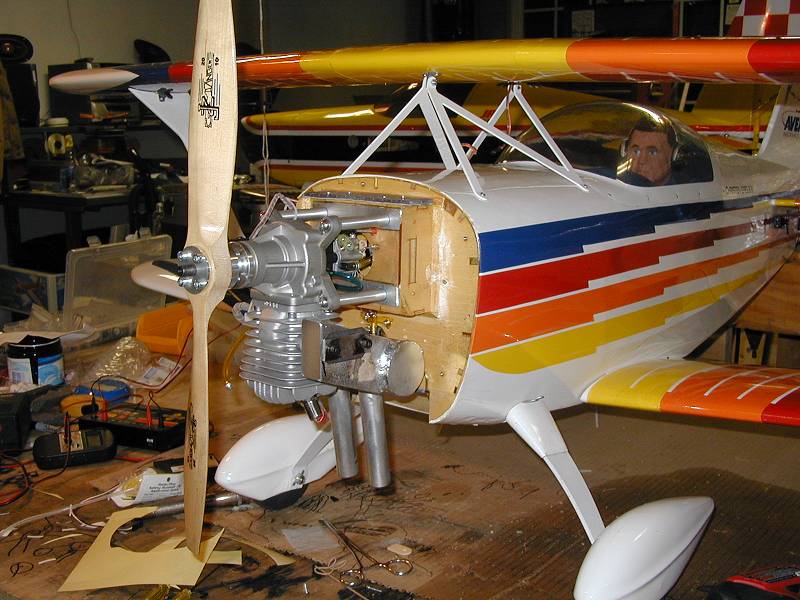

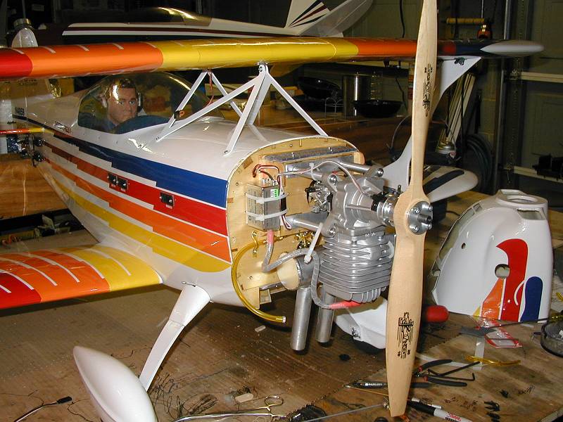

My DL 50 has been doing a super job nice to start transition is very responsive and it realy has power, it takes this 18.2 Lb plane stright up no problem. I have no regrets on this one,

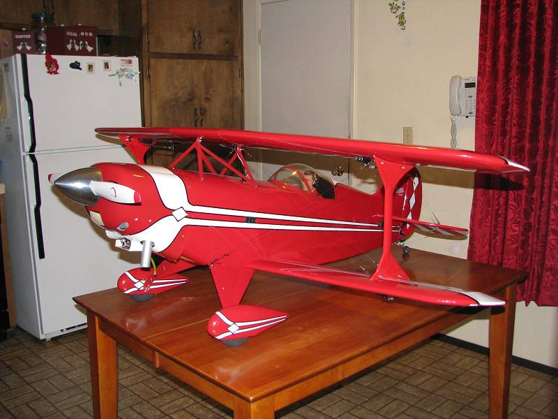

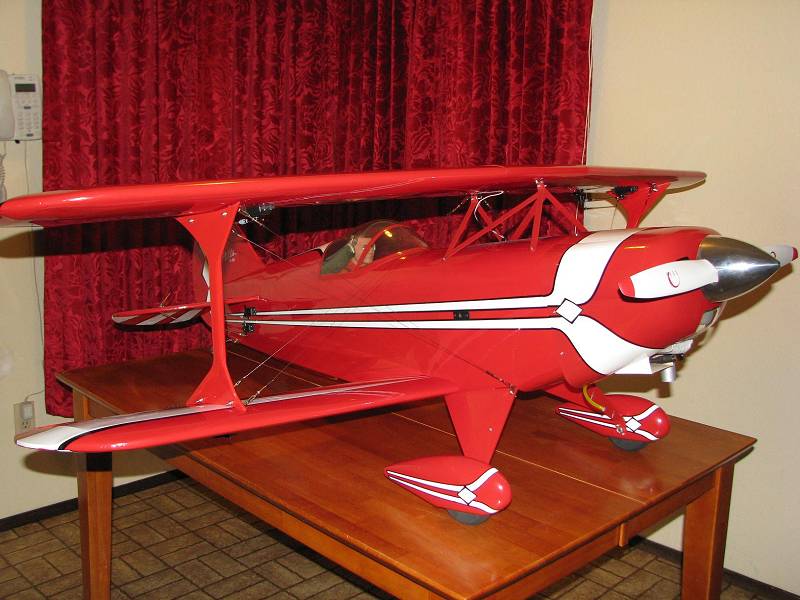

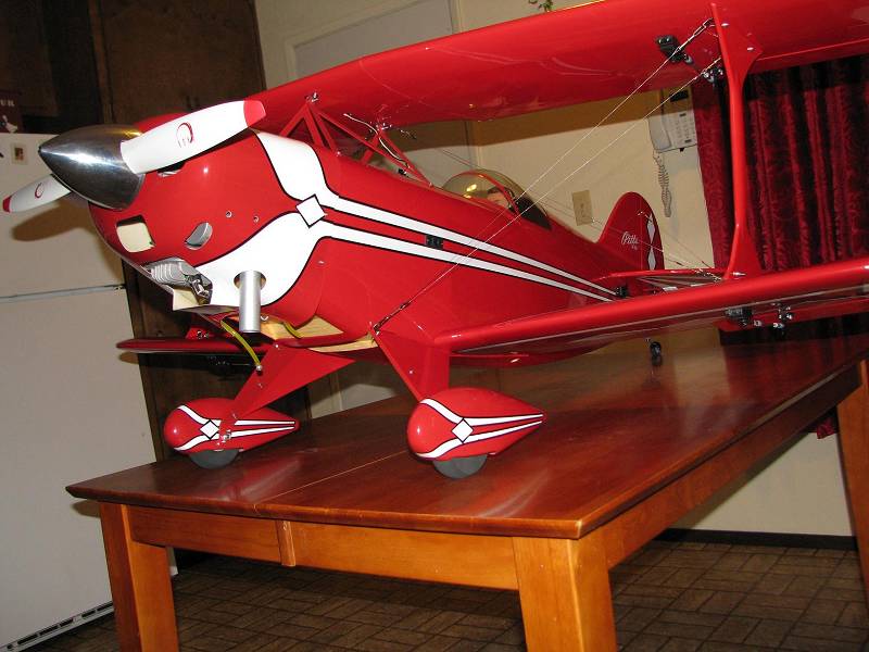

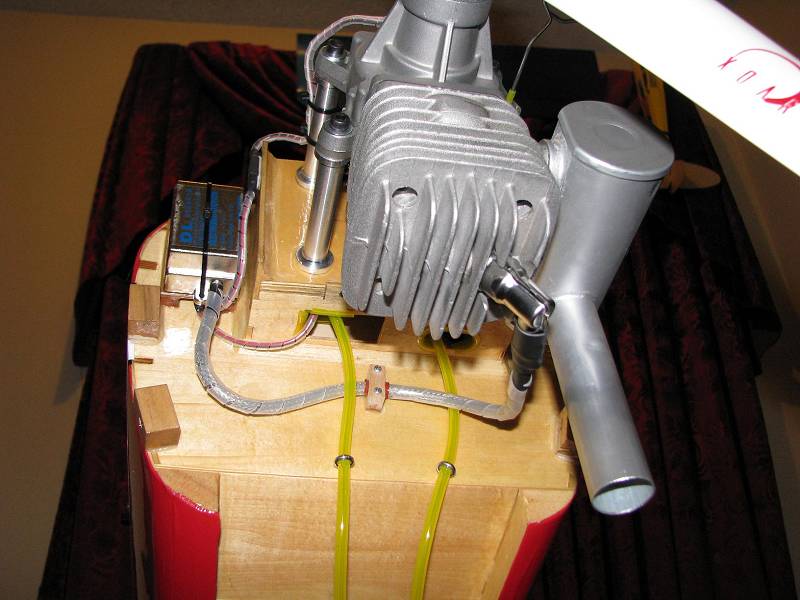

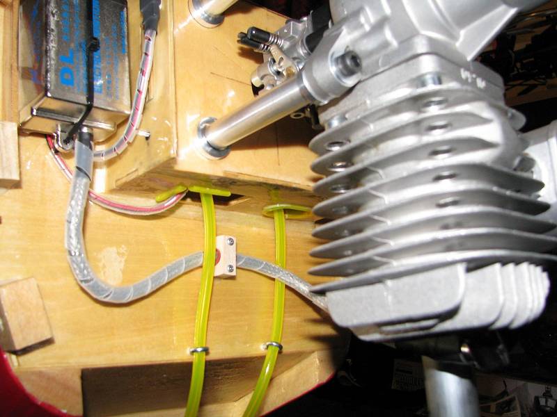

wow that plane is heavy compared to the pitts special,the pitts weights around 16 and a half pounds to 17 pounds,heres the pictures for you,the ones where the plane is all put together shows the fuel lines inside the cowl,i hadn't cleaned it up yet but it actually came out pretty good after the plumbing was cut to size and straped away,you know what i totaly forgot that yours has the wrap around muffler so im not sure this would work for you but well only trying to help,perhaps you can still get some idea from this set up

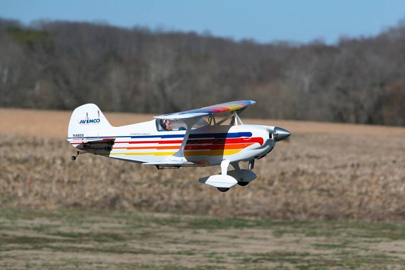

Bosco, I love your Christen Eagle. I wish I had one. I did the "in-house" development on that model and wrote the instruction manual for it too. I built one for Mat Chapman who flies the full-size Cap 580 that we modeled our trim schemes after too.
Say, I see you are using the cowl ring option on your Eagle. How do you like it? Do you think it's too much hassle? I made cowl rings for my Extra(s) and my Edge. The only way to go I think, but maybe too complicated for some.
Tell me what you think.

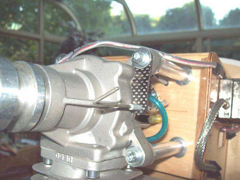

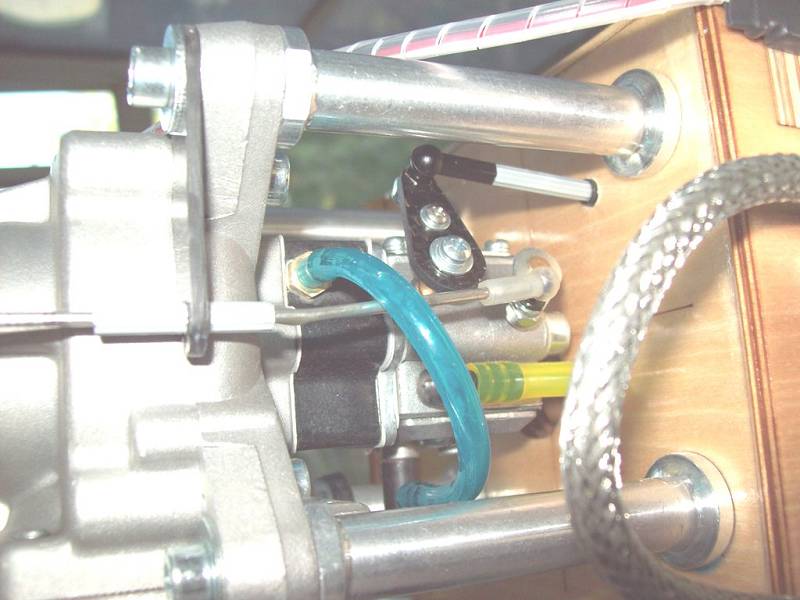

Switch, I love your Pitts. Man, I wish we hadn't discontinued those bipes!!

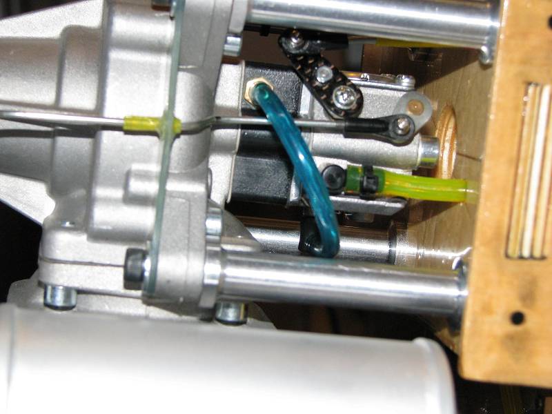

I see you are using my idea (????) for the carb arm and choke mount. I got a new choke mount though....

Beutifull Plane good job on the setting up, She looks like it's ready to tear up the sky and then some,

Many Thanks,
You did a good job on this CE and I think the cowling ring is best gives you a strong and rigid installation and I do not have any problems with the screws backing out,

Switch love your Pitts, nice job on the engine install.
Tim I noticed you changed to a single sided choke mount. Was there a problem with your first design with harmonics or something? Or did you just decide to try it that way? I agree with our comment on the Christen Eagle. The first time I saw one on this thread a few months back I went to Tower and the Great Planes site to get the details on it. That's when I found that it had been dropped. Too bad, I have loved that plane and it's scheme since it first came out back in the 80's when I wanted the .40 size one.

Hi Super.
Choke mount - no, I just like the appearance of the one-arm type better - it's carbon so it's cool! The other one was working fine, but since it's plywood I felt it needed to span both the top and bottom bolts. Since I went to carbon I think I can get away with just the one side.
