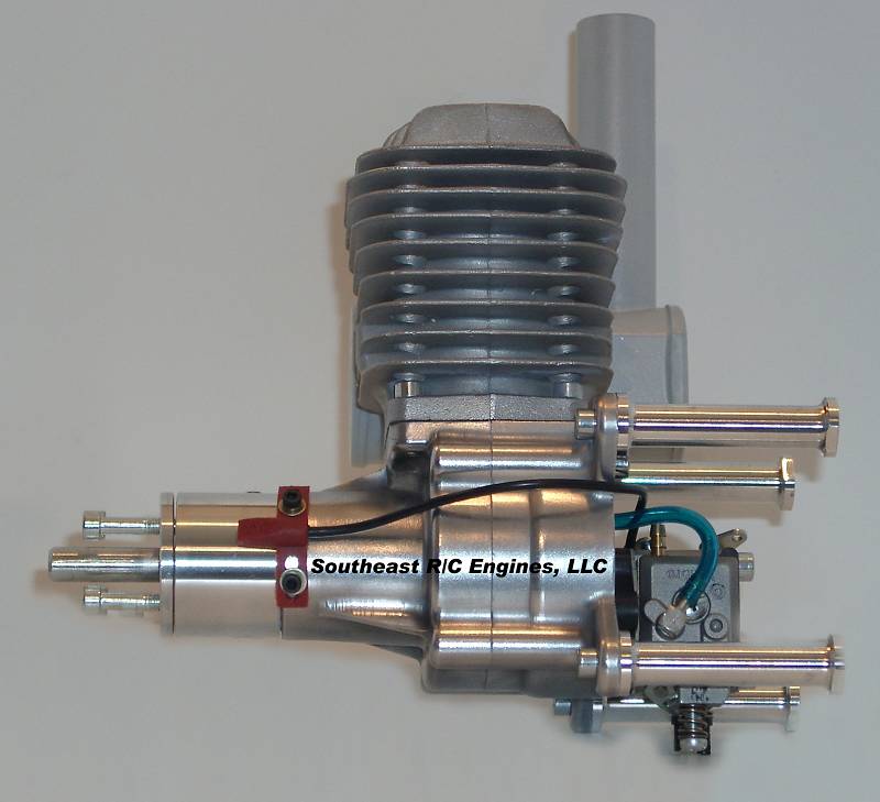

DL cylinder on a machined case? I can never seem to get pictures posted on RCU, I never have problems with the other forums , maybe it's a mac thing?

Thanks for the link. Looks like an interesting motor. Wonder at what rpm the 5.5HP is rated. 10,000? Also doesn't seem to have a v type reed. Maybe DL knew someone was copying their engine and therefore they added the extra 5cc per cylinder?!

It looks to me to be the same as the XYZ-50HP from southeast RC engines... http://www.southeastrcengines.com/see_010.htm
