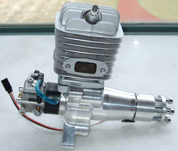

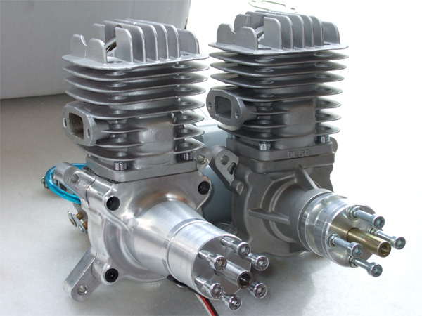

DL50 V3 is on the way four reed valves, machined finish! NGK CM6 Spark plug.

You sure thats a DL50 and not one of the many other engine releases out of China today? Head isn't brand stamped like to other one.

ORIGINAL: PerFlight
Good rumor to start on a DL 50 thread.
Please produce your source of the pics, and the information about the latest "version" that you mention.
The current version is selling like nutso everyplace that handles it cannot understand why DL would release a new version with a redesigned crankcase with more expensive machined parts.
Reveal your sources and validate your statements, would you??
Thanks.

Fully aluminium crankcase?? Man, you got be kidding me...
This could cost alot. Also there was no DL seal on that engine.

ORIGINAL: PerFlight
This does not look like the DL.
Could you please give more info and post your sources?
Its very aggravating when someone posts something like this and then does not back it up.

My main problem with this is the fact that the engine has a 6 bolt prop mount instead of a 4 bolt pattern. One of the main reasons that the DL's have been so popular is that they have the same/similar mounting pattern as the DA50R for most things.

Looks like an MT-57 crankcase with a "dl-50-style" jug.

...or a very obvious copy of that other rear-induction, reed-valve, cantilevered-crankshaft, industry-leading, American-made 50cc engine.

Well, whatever it is, I agree with pupmiester-they screwed the pooch with the 6 bolt hub.

Actually that 6-bolt hub might line up with the ZDZ 50.
