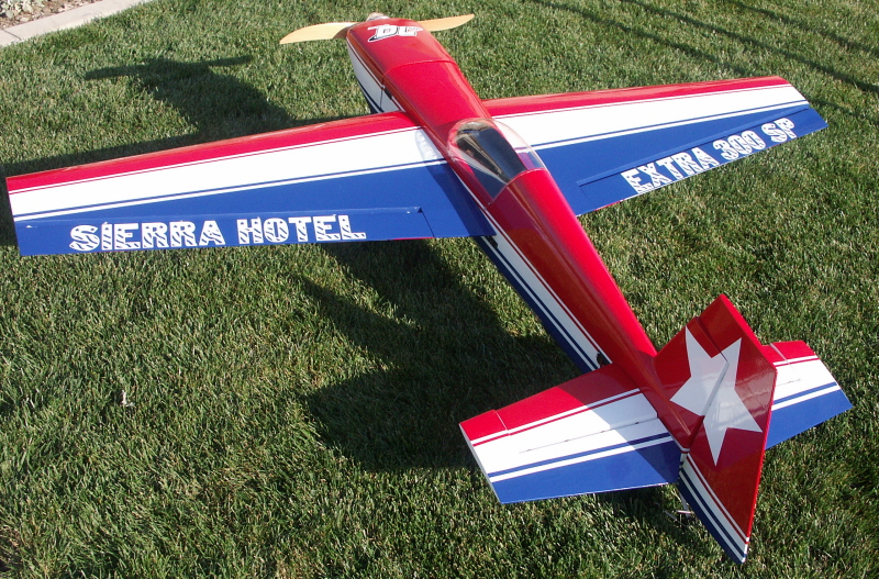

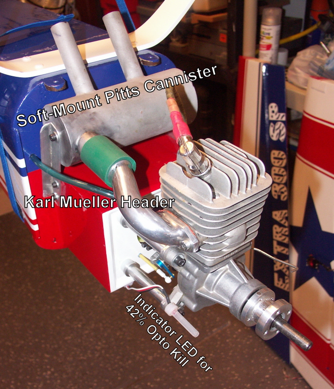

Well, I finally finished the rebuild of my crashed Extra 300 and have re-installed the DL50. The rebuild turned into a very lengthy project but I am happy with the results, but that's another story. Re the DL, it started almost immediately after sitting all winter and it needed virtually no tuning-love that engine.
Here are a couple of photos of the end result and my DL setup. (I'm hooked or red, white and blue planes).
