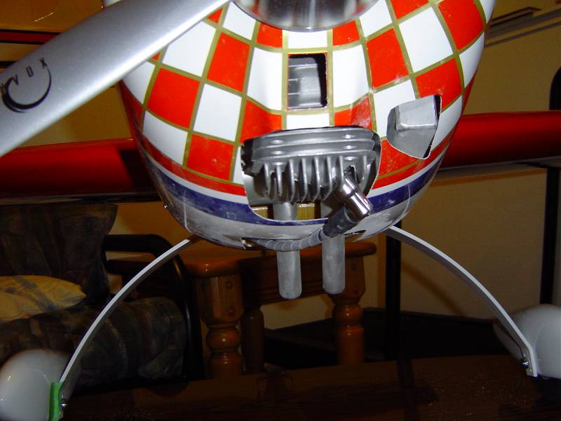

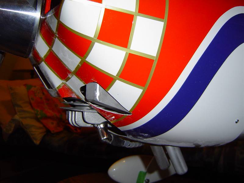

Picked up some brass nipples at the hardware store today. I think I will go ahead and to the vent mod to both of my DL's now while I am putting my planes togerther instead of getting out to the field this spring and find I have problems. Here are a couple of quick pics of my install so far in a GP Wagstaff. All the stuff on the cowl is dust from cutting the fiberglass and I hadn;t wiped it off yet. My other one is going in a Giant Stinger.

Question for you all. What is the minimum safe distance to keep the plug wire away from the exhaust when routing it through the cowl?

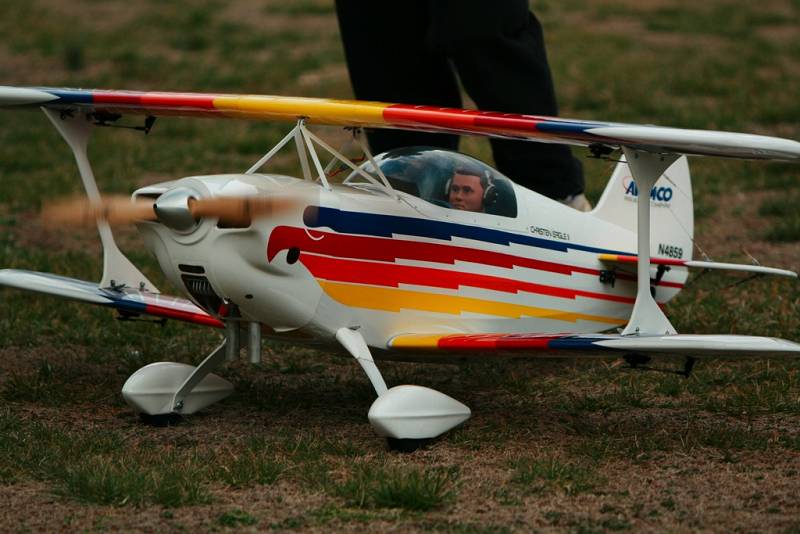

Well yesterday turned out to be a good day for me, I took my Christen Eagle up for the first time with the DL 50 in it, and they both perform very well,
The engine that was runing a bit rich was consistence with plenty of power and the plane was fast and responsive it was great,
I did notice that the engine that I ran in my back yard doring the week did very well but I did notice a diferrence in performance when I added the nipple and tubing to the back plate of the carburetor Friday night
it seems to me that it ran mutch smoother and not as poppy, all in all I was very pleased with the engine performance as well as the CE it self,

ORIGINAL: Super08
Far enough to keep it from melting Seriously, the farther the better, but an air gap of 1" or so at its closest point should be fine.

You might want to consider openning up the space around the cylinder head for better cooling. There might be an overheating problem in warmer weather.

I always liked the Christen Eagle. It just grabs your attention as soon as you see one.
Thanks Earle, I'll have to look and see if I have enough room to route it between the muffler and the cowl. I would like to get it inside for both looks and so it;s not out flapping in the wind.
