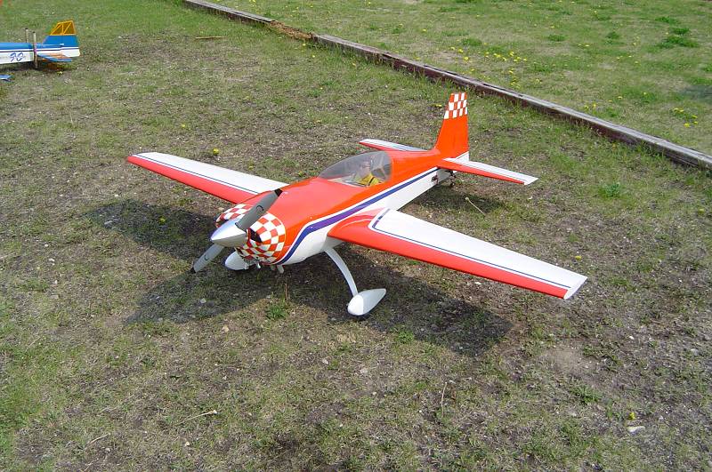

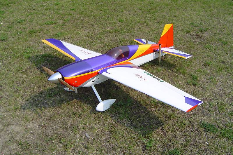

Finally got to do my maiden flight today with my DL mounted in a GP Wagstaff 300. I had run almost a gallon of fuel through it 2 months ago on the ground and tuned the engine. Afterwards I had run it dry and set it aside until I had time to finish the plane and felt confident enough to fly it. I could not get it to prime at first so I pulled the cowl off and put a small squirt of fuel into the carb. Then it picked up prime and took off. Put the cowl back on and it ran like a champ all day. One of the other guys with a DL remarked that mine runs smoother than his with next to no burble in the mid range and wanted to know how I tuned it. It's my first gasser and I found it too hard to try and tune by shutting it off to turn the needles so I did it with the engine running and the cowl off just like I do with nitro powered. I guess it did the trick as it purrs like a kitten. Can't wait to see what it is like once it is broken in 'cause it pulls my 17lb model around now like there's no tomorrow. Here is a couple of pics of our planes with the DL's

How did you attach to the firewall. I have the same plane and installing the DL50 as we speak, cant wait to fly her. How does she land?

I used 3" standoffs and 5mm hardware with extra large washers behind the firewall. It lands like a kittycat at a slightly elevated idle. I'm guessing about 2000 rpm. I was surprised at how easy it was to land. The standoffs were made my Roger Forgues.(Forgues Research) He posts here on the forum.

I posted a pic of my plane 6 posts back, it's a Great Planes Wagstaff 300S. I also have a Giant Stinger for my other DL which I am not finished yet and Sig Spacewalker 1/3 scale kit I am going to build over the winter. Shipping is just something you have to live with. For oversized kits it costs me over $200 to have them shipped plus brokerage fees coming across the border. Not as bad if you can find a Canadian store that has what you want such as Great Hobbies or Hobby Wholesale in Edmonton. Good Luck.

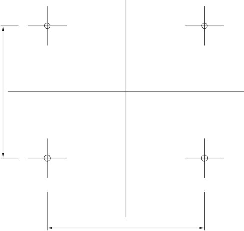

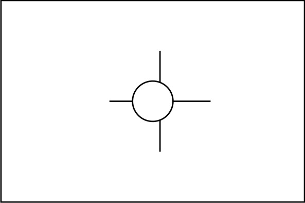

So i was going to mount my dl50 on my yak but i have one problem, on the firewall there is a cross but it is not in the center, so should i mount the engine on the center of that cross or should i mount in the center of the firewall???
(The template for mounting, the anotherone is the firewall with the circle in the center .)

Center your engine on the cross. It is supposed to be off center to make up for the right thrust that is built into the firewall. If you look closely you will see it is angled to the right and the cross will be to the left of center. What this does is move the back of the engine to the left so the front of the engine comes out in the center of the cowl.
