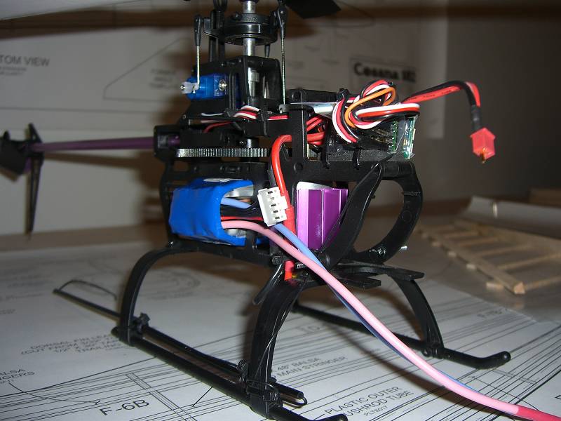

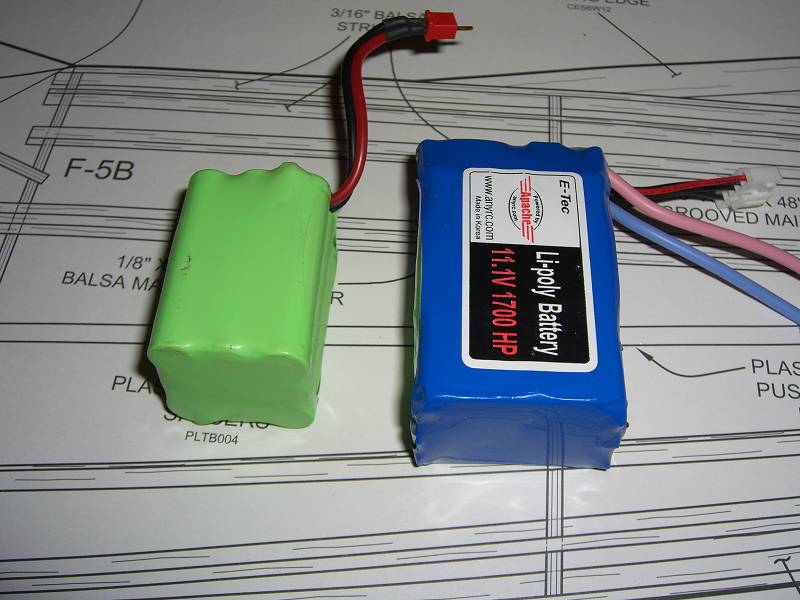

I just got a 1700 mAh battery yesterday, no charger yet. I am working on a balance issue, need about 1.3 ounces in the front. Quite a bit, not sure if I will use the battery or not, thats the beauty of e-bay, I can always get rid of it easily.I weighed the training gear, .5 ounces. I think I am going to be in the neighborhood of around 2.2 ounces heavier than stock, maybe too much for a 16.5 ounce heli. When I get a charger, I will know for sure

Tex, no msn. It is a lipo battery, an e-tec. Got it cheap yesterday at a swap meet. Figured I would give it a try. I will try to get some pics of how I have it mounted and see if I can figure out how to post them here.

I got this battery for the Axe. Should help the balance issue.

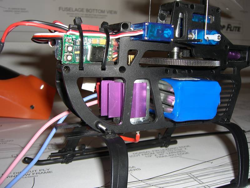

Heres the rest of them. I am going to add the weight to the tip of the canopy, since I always fly it with it on, figure it helps protect the reciever and esc/gyro. I guess putting the weight as far forward as possible also means less weight, is that right?

Tex, its mounted directly beneath the main shaft, only place it would fit. No battery at all where the stock pack goes, thats the reason for the 1.3 ounces in the tip of the canopy. I may try melting down some fishing weights to a simialar shape to the canopy nose and tape or glue them inside once I know if its going to work or not.

If you have to use weights, use BBs.

The width is fine, just a bit too tall. Don't want to go cutting the frame so I managed to squeeze it in under the main shaft. I am trying to look at this as an experiment for more flight time, if it doesnt work, I will get a different battery that will fit in the stock location, even if that means less time. I have this problem with wanting to fly for at least 30 minutes no matter what I am flying. I think my top flite cessna 182 is going to be a bit heavy due to fuel weight, I need rehab!!!! Anyone know a place??
