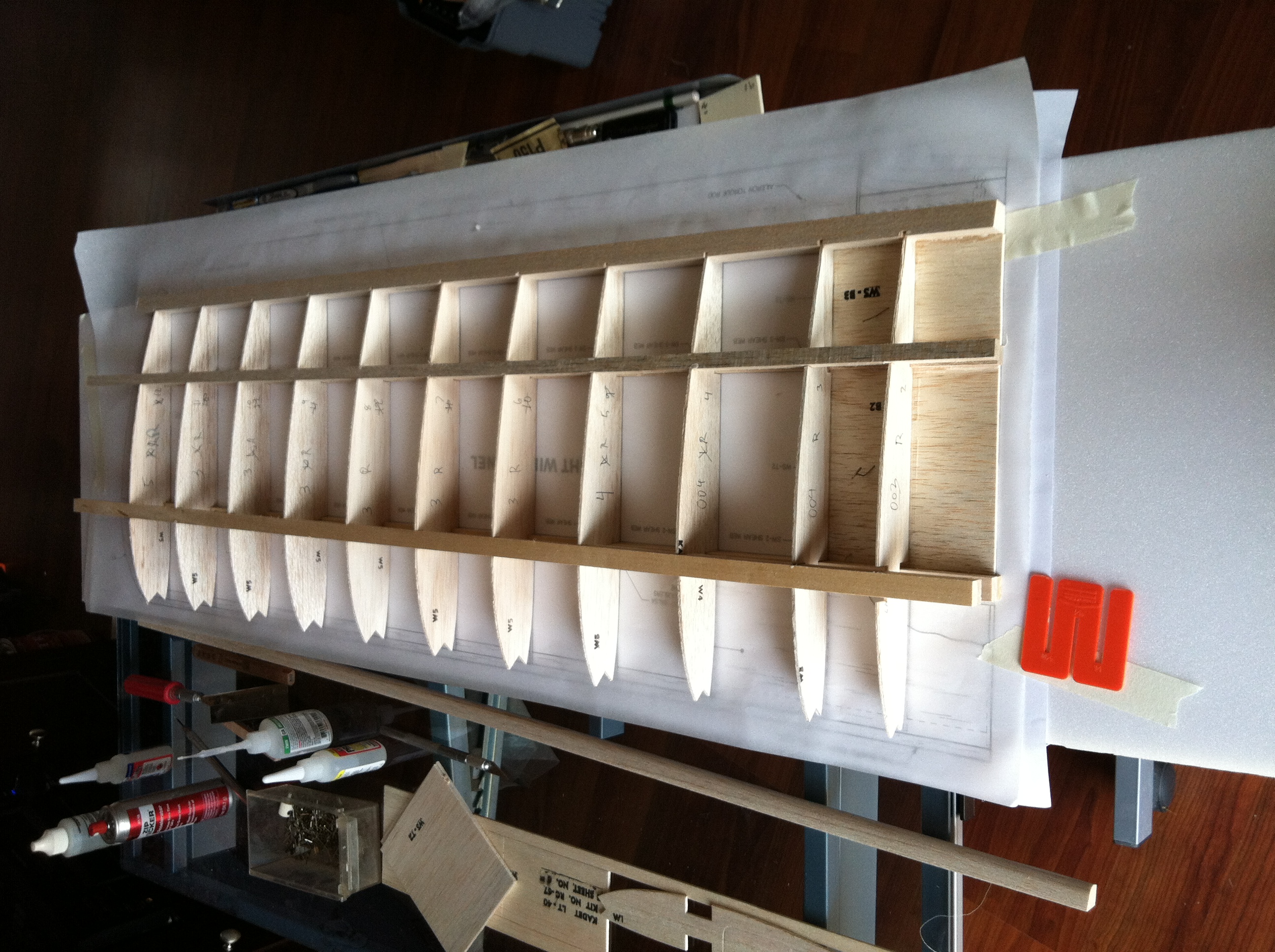

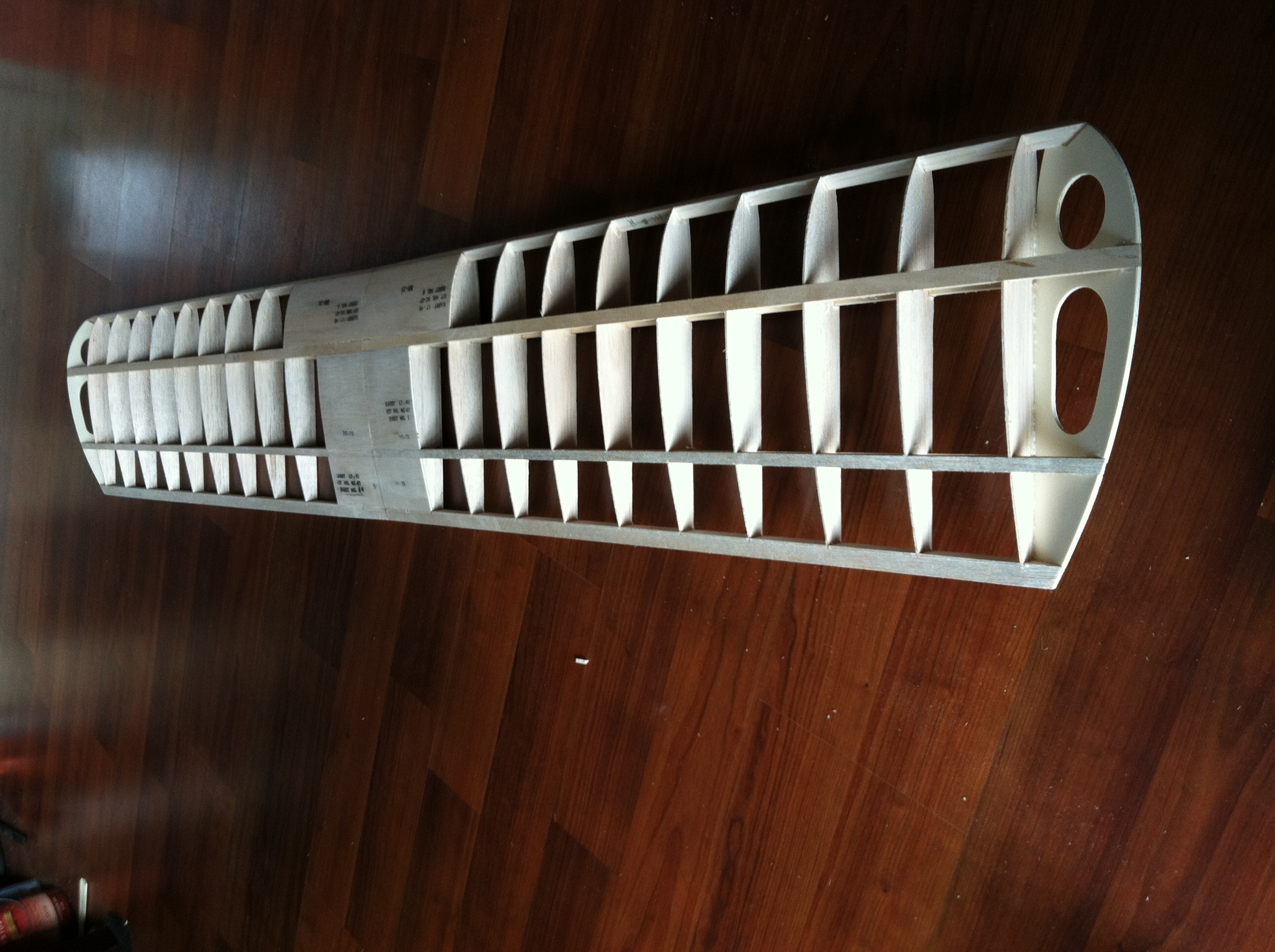

The left wing has been built, lower, upper spars front and reat and TE are in place. The wing structure is solid, the design uses laser cut shear webs between the spars and ribs, and fit perfectly. So far every piece fell tightly into place, no trimming or sanding of any part was needed. I built the wing on a 3/8 Foam panel that is the type used for making Foamies, very dense, and flat, and had that taped down to my glass topped artist table. The wing came out nise and true, but after I took it off th e board I discovered the lower spar has a very slight bend to it that is only noticeable when you lay it down on the glass top. there is a 1/32" gap at the root. I can most likely get that out with the covering. I still need to attach the leading edge and W1 rib, but I first need to make a new Dihedral gauge with the 3 degree offset instead of the included 6 degree one, and also make new spar joiners out of plywood.

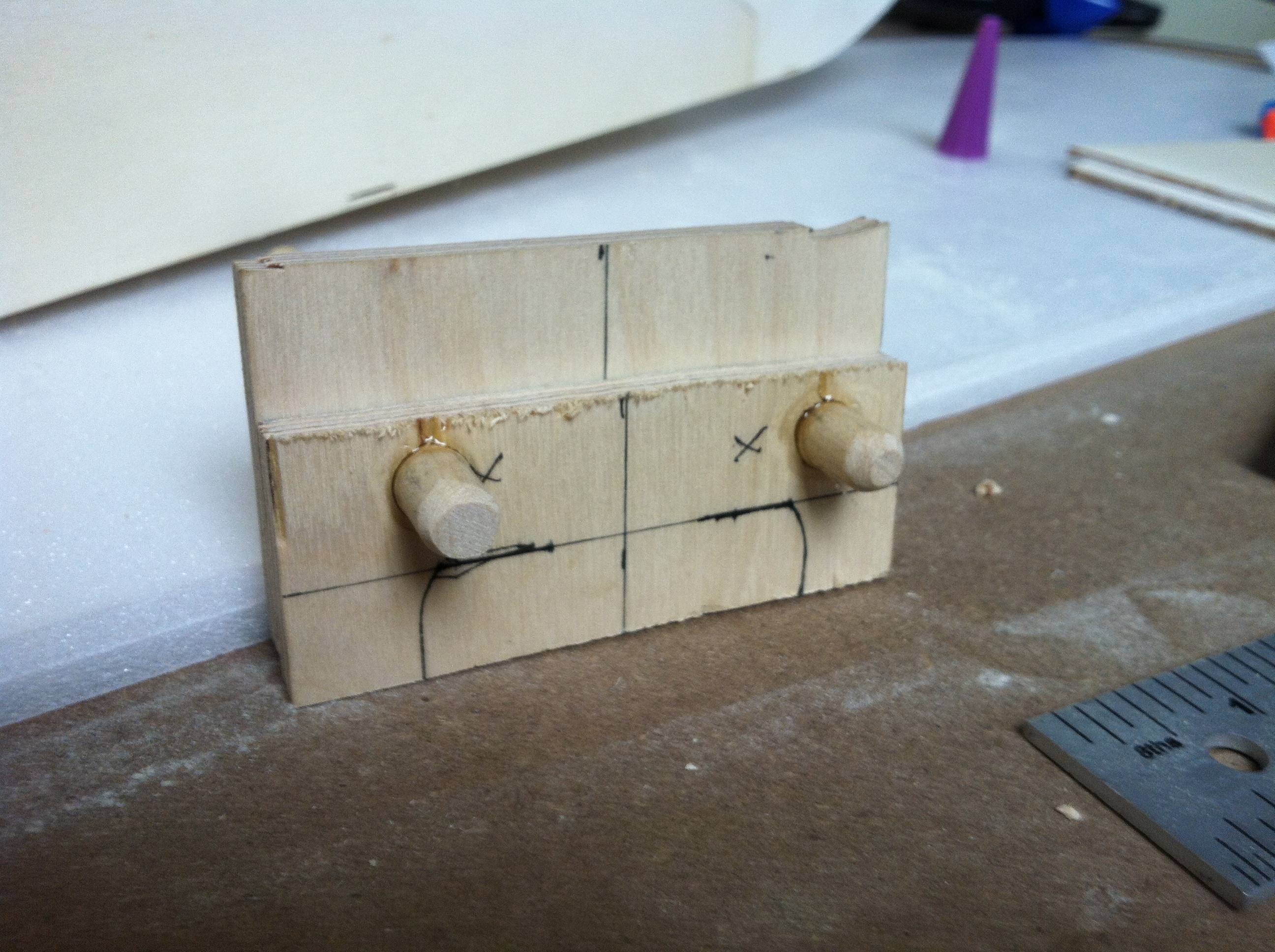

For the bolt downs, I plan to use dowels, so for the leading edge I am looking to cut back about 3/8-1/2" and insert 1/4" plywood at a slight angle, with 2 pins, and on the Fuse another 1/4" piece behind the windscreen ply so that when I insert the wing, the pins will be pointing up at a slight angle to lock the wing in place. Since the rear of the wing is angled down I most likely will put the bolt block in at a matching angle so the bolt heads lay flush with the wing, and will incorporate plywood in place of the balsa that currently goes there.

Are you going to add sheer webs all the way to the last rib? Aparently Sig doesn't think they are needed. I think they should be on the main spars at least.
Joe
Joe
I don't see a reason for them. The plywood wingtip adds a lot of strength and rigidity to the wing.

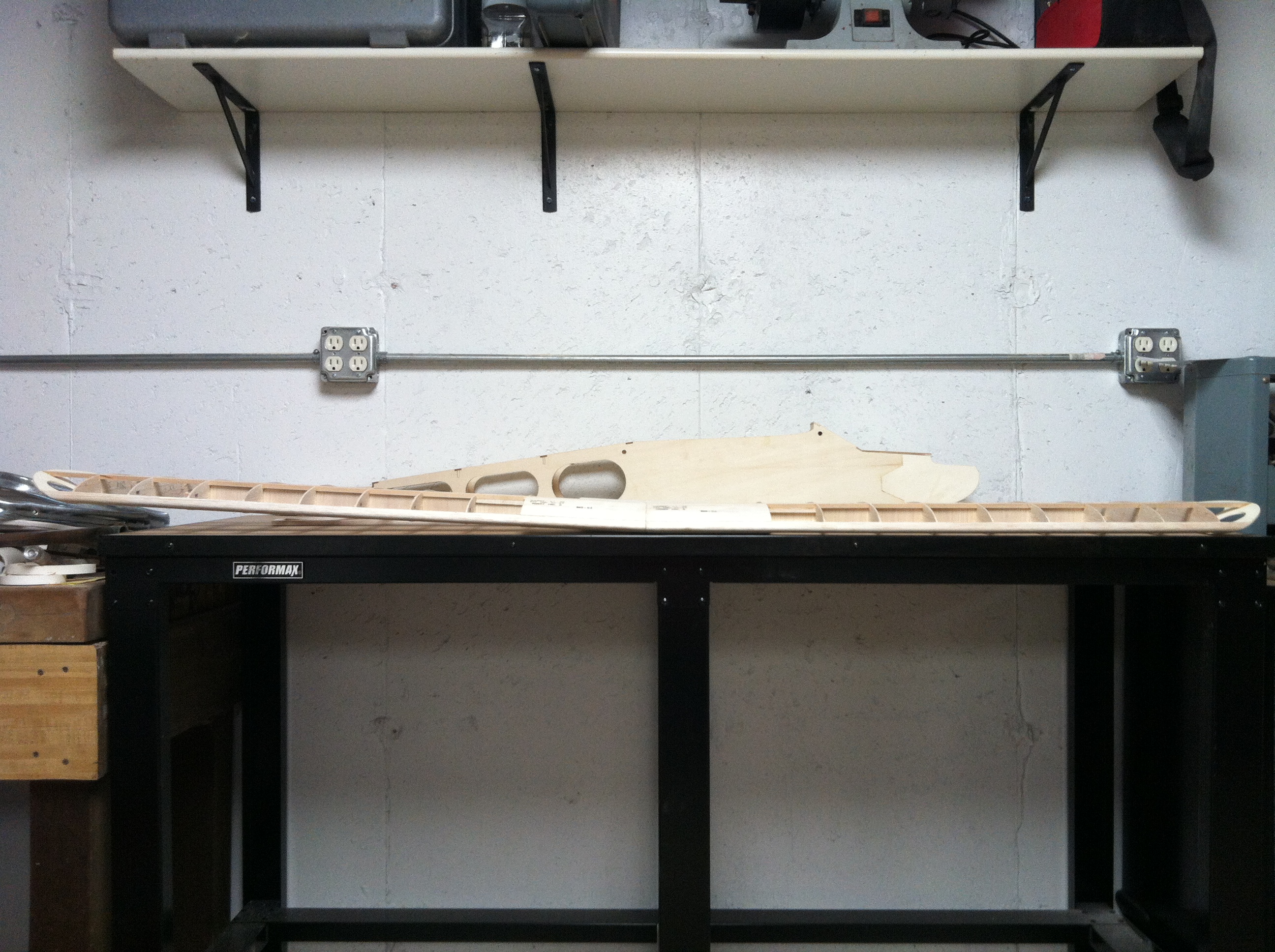

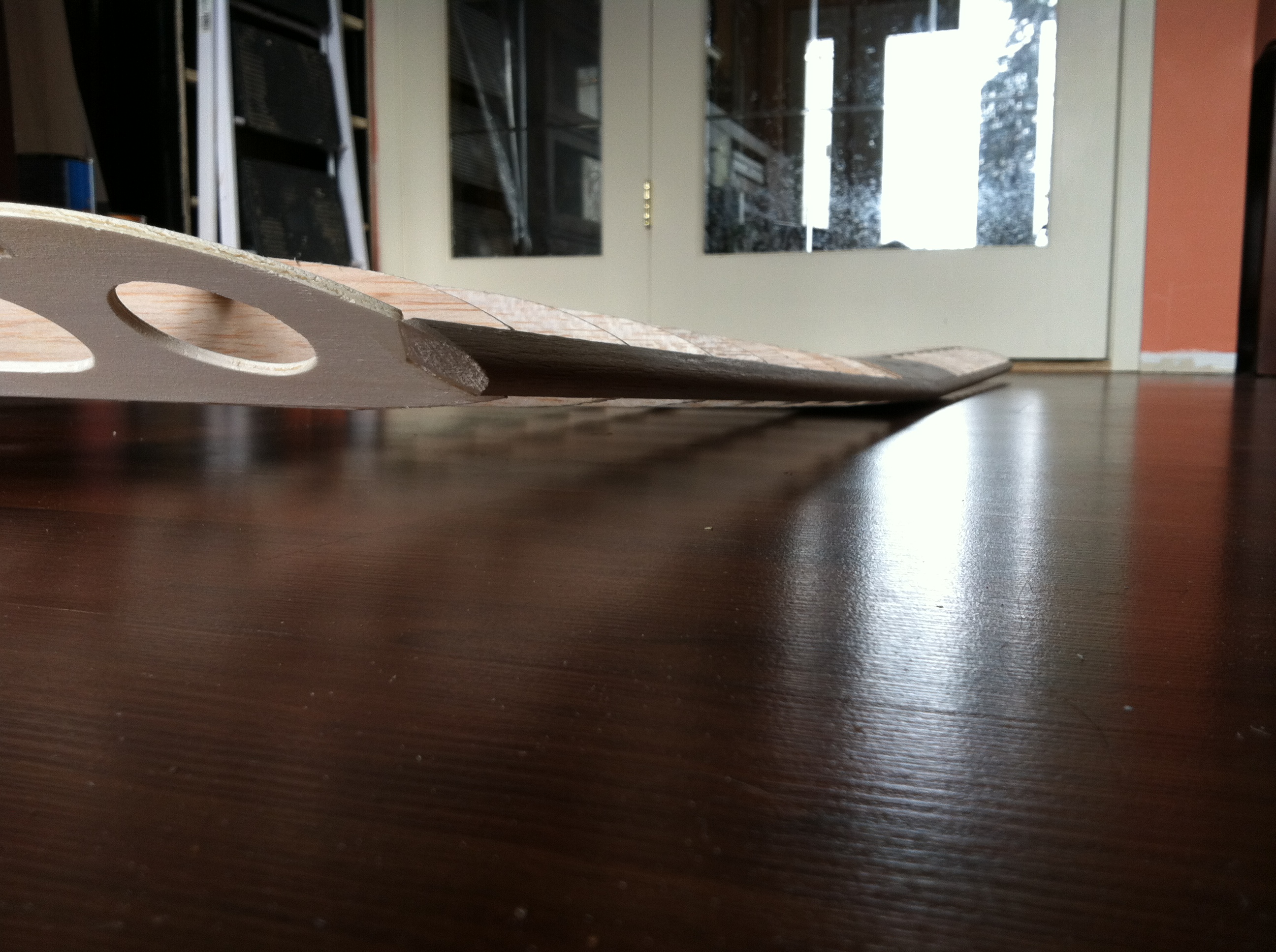

Ihave the wing nearly completed, just need to work on adding the torque tubes and ailerons, and its done. Well, done by the book, once Ihave the fuse assembled I will go back to the wing and do the pin blocks for the bolt down mod.
The Dihedral is 1 3/4". Should be easier to fly upside down, and have a bit more performance to it.

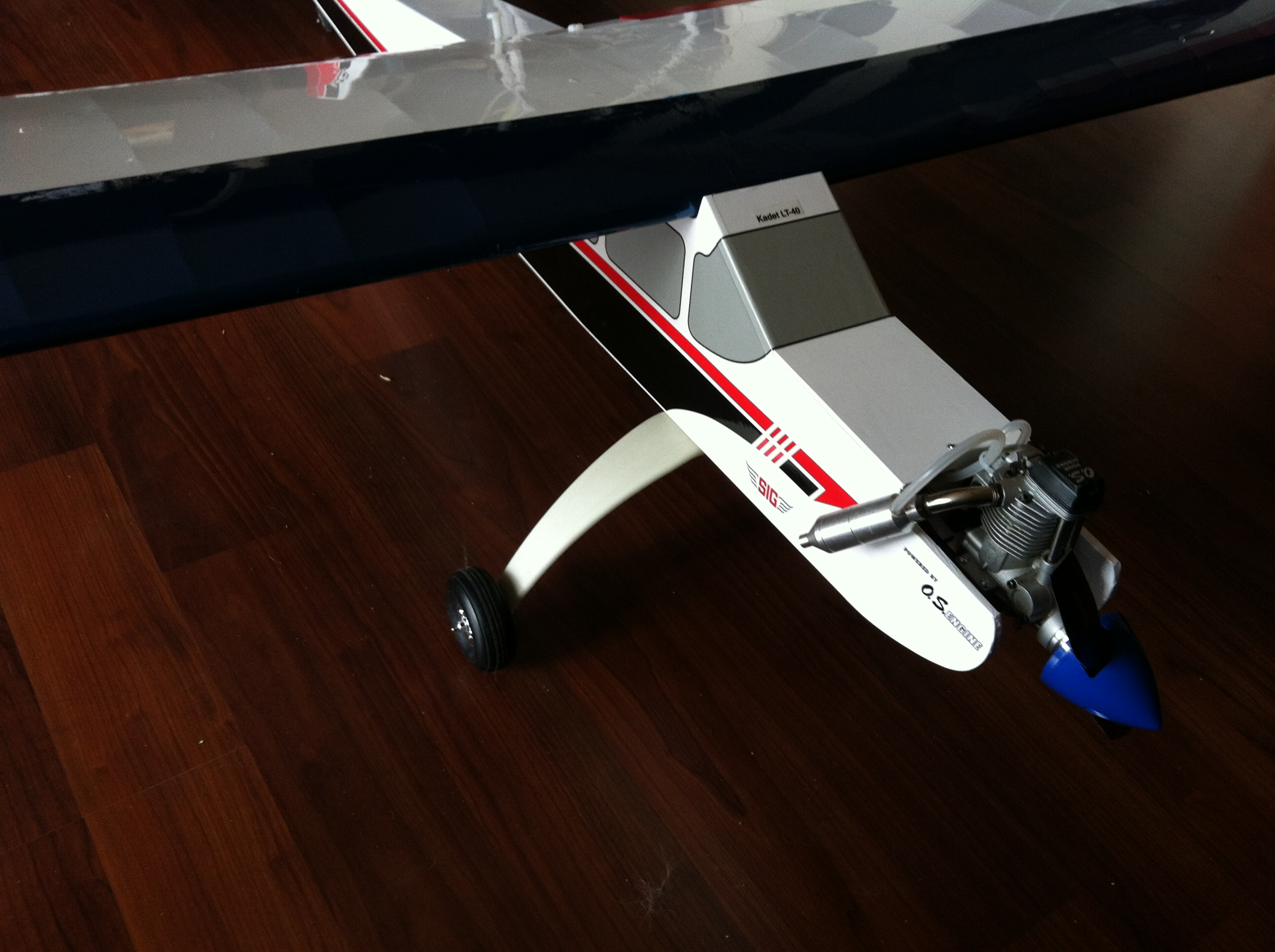

The Landing gear placement though I am still struggling with. I think centered on the leading edge of the wing should work, but not 100% sure. Need to figure that out so I can put 1/4" ply backer for bolting the gear to. Once I have that then I can glue it all together.
I am still going to glue the LG block as per plans and have the nose gear fitting on the firewall just in case I want to switch to conventional LG.
I just looked at mine which has the same tail dragger mod on it. The center of the landing gear is about 1" back from the leading edge of the wing. I also did the bolt on wing from the outset. This is such a great plane. I learned to fly on it, train others on it, and convert it to floats for our float flys. Always my reliable flyer.
Thanks, thats perfect, it puts the block behind F2, so I dont have to worry about stuffing it in under the tank floor. Now to find the right landing gear for it. I feel a lunch time trip to the LHS coming up. <div>

I used an aluminum strap landing gear, I think it was left over from a Sig Somethin' Extra kit. Works great.

Well, brief update on the build. Last night I took the assembled fuse and placed the new gear on it, and the tail gear. I located the main gear axle centered on the leading edge and found the bolts straddle F2. I cut 2 1x3x1/4" plywood blocks and placed them on either side of F2, and they fit perfectly. LG mounts done, now to glue it all together. <div>

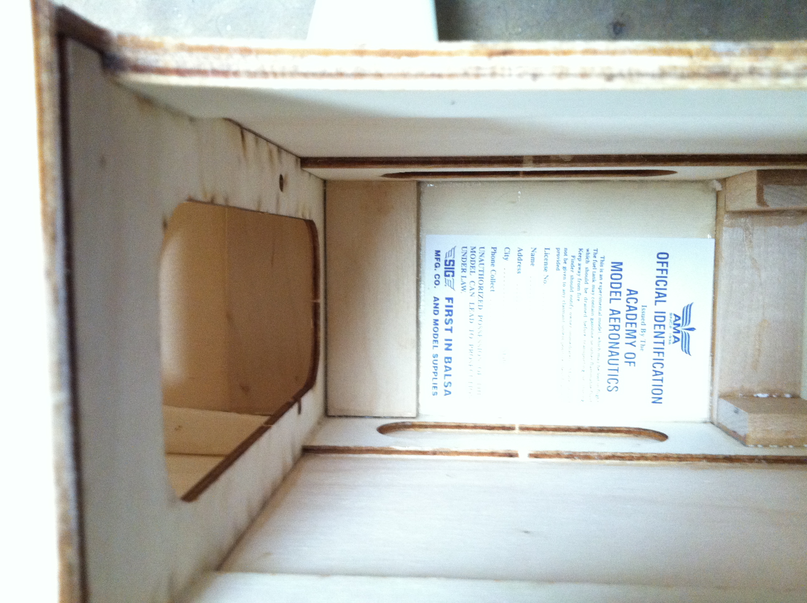

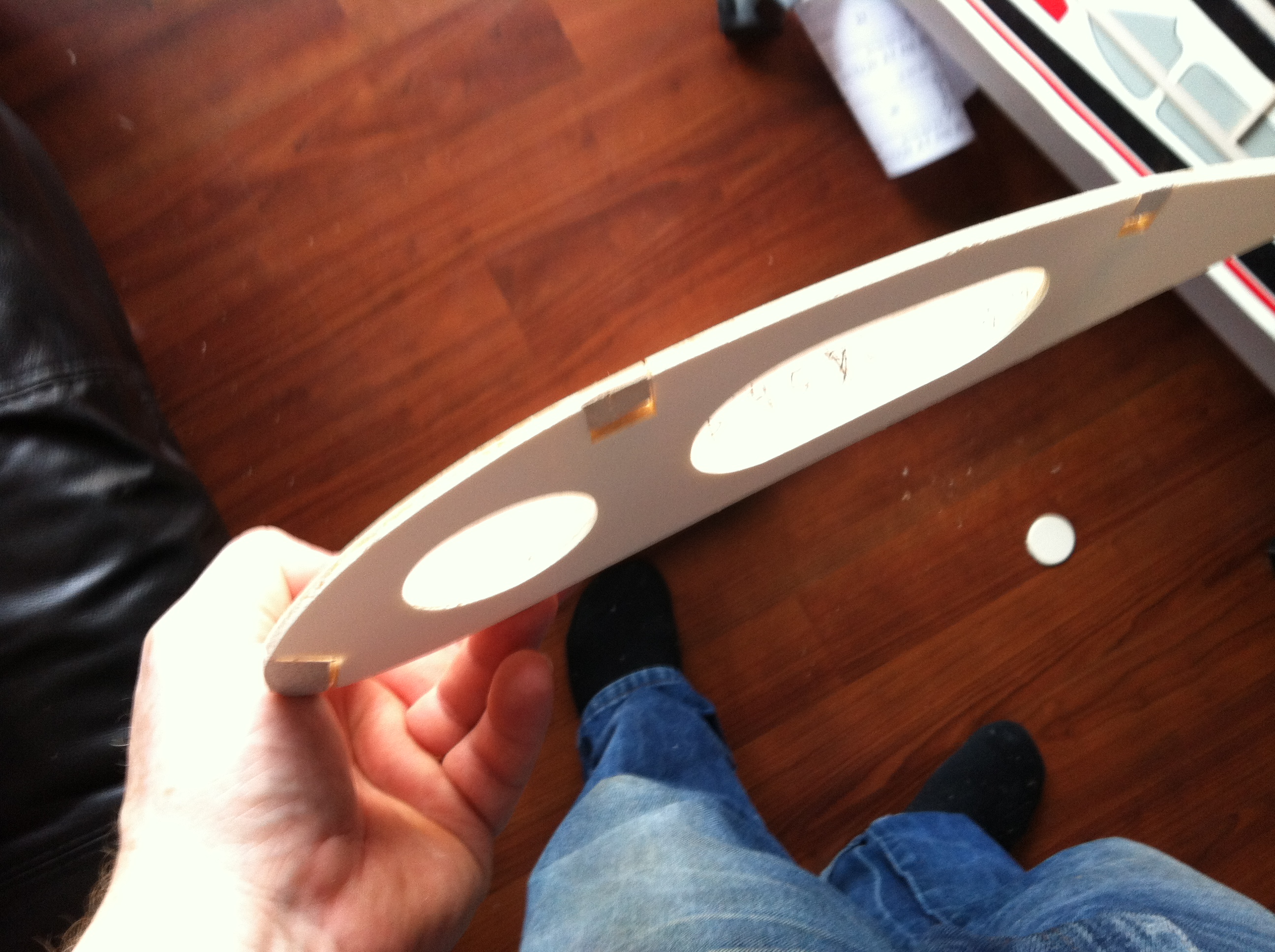

</div><div>For the wing bolts I took F7 and cut a new piece out of 1/4" ply in the same shape. What I found interesting, the shelf for F7 is 1/4" deep, so the new piece fits flush with the top of the fuse. I will need to check the wing fit with the ailerons and servo installed for clearance before I glue it in. </div><div>
</div><div>For the LE pins I took a 1x3x1/4" plywood block and placed it in front of F2 at the top, and sanded the edge to match the angle for the windscreen. I should have plenty of meat there to pin to. On the wing, I am thinking of slotting behind the LE 1/4", making a piece from 1/4" ply to match the dihedral, and notching it to go around the ribs halfway up so they will all lock together as one. The piece will extend down about an inch or so depending on the fit, and will be slightly smaller then the width of the fuse inside so it will lock the wing in side to side with the pins holding the LE down. </div><div>

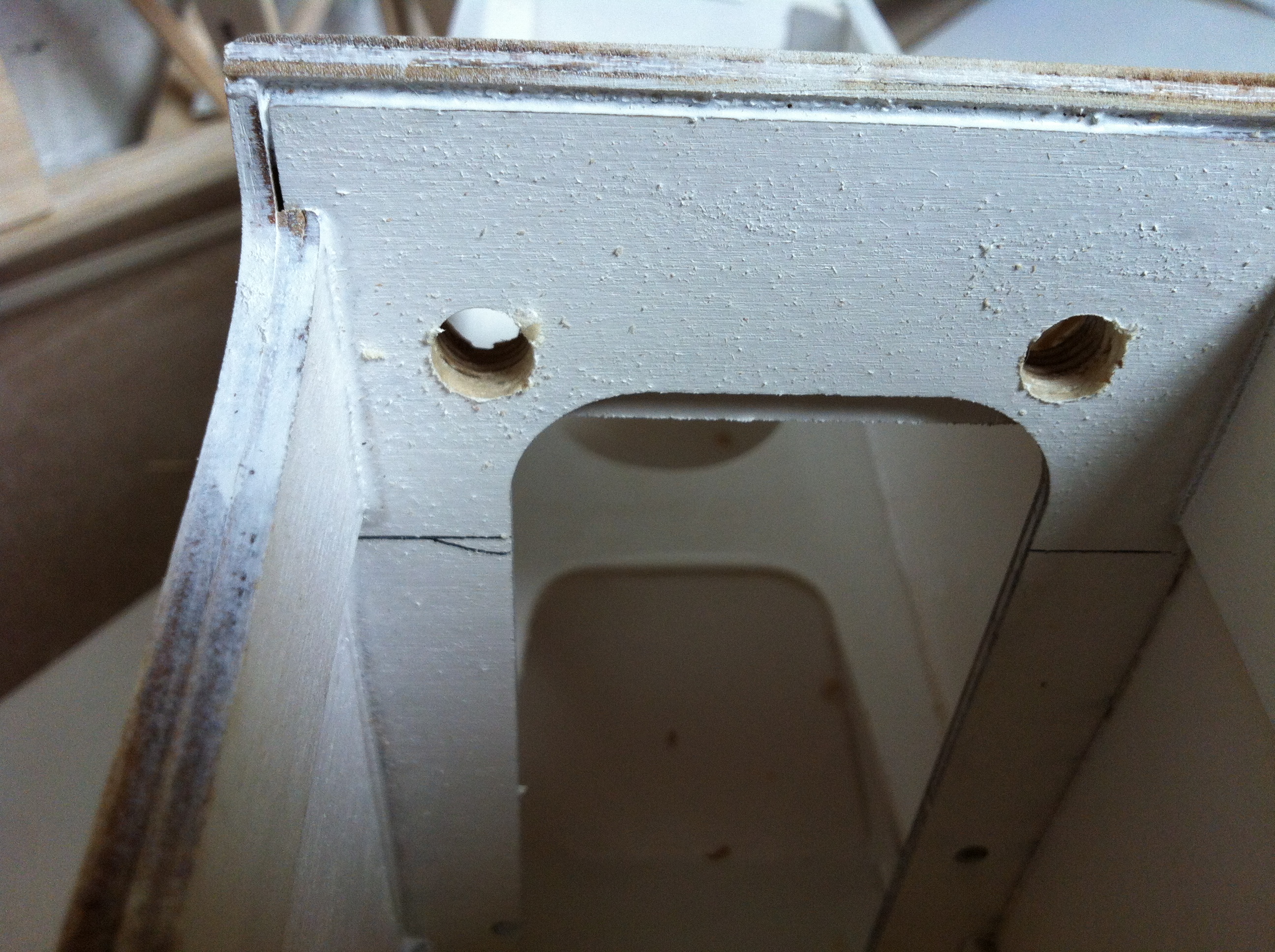

</div><div>For the wing mount, now that I have the fuse together, I found that the wing sits inside the fuse, not on top as I previously though, so the pin block is going to be larger. I will glue two 1/4" ply pieces together, one piece to slip inside the wing, the other to fit below the wing. This piece will have the pins in it that will slip into the F2 and ply block I installed in front of it. </div><div>

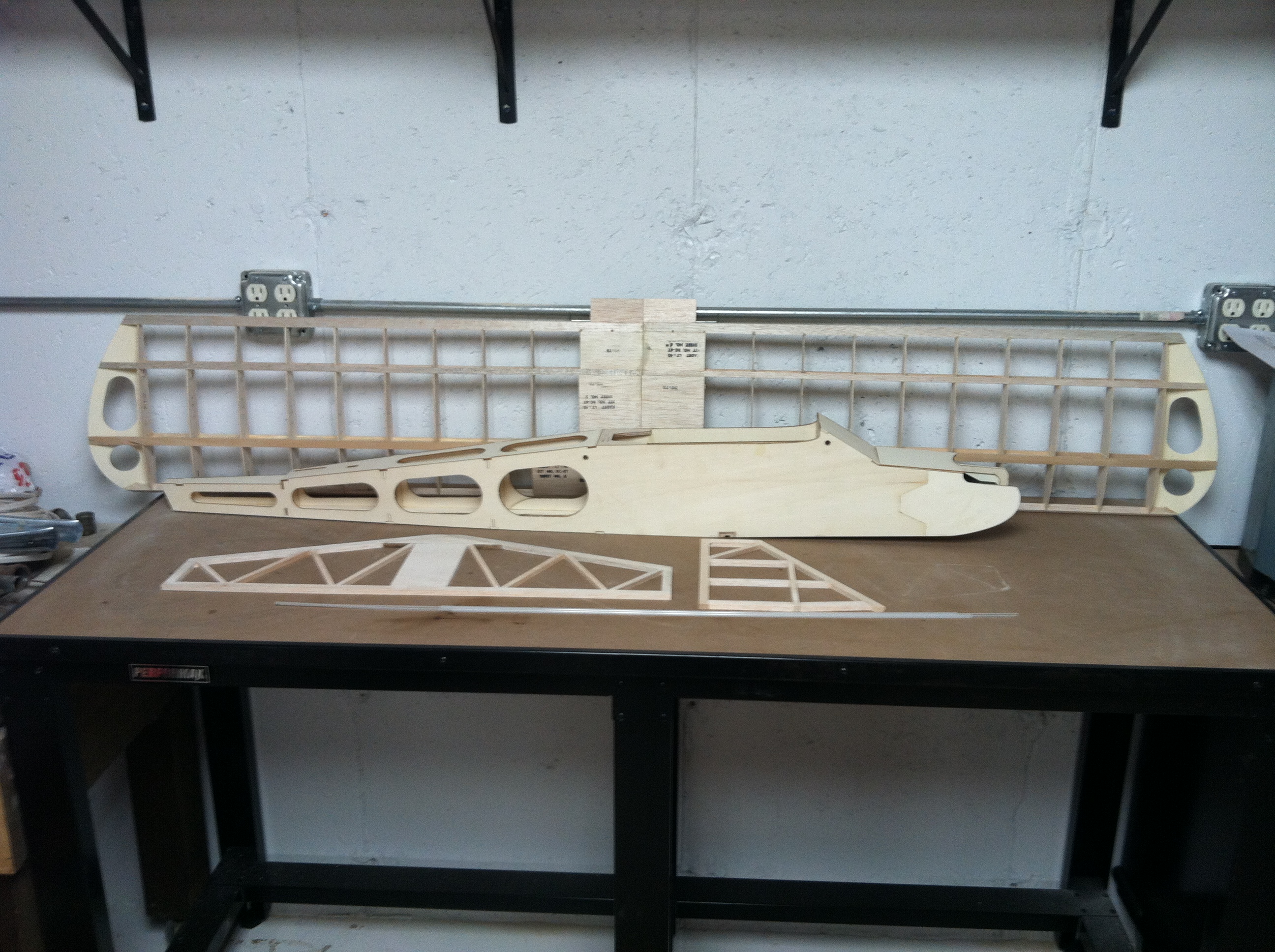

Well, here are the pics of what has been done so far. ALl major components are assembled, the Fin and Stab just need theLE sanded to shape, the wing needs the fiberglass strip glued on and the ailerons fitted.
Once Ifinish up with those items, it is on to putting in the controls. Ithink Ihave the carb linkage figured out, Ispun the carb 180* to put the link inside of the mount, it was touching the mount and I had no way to get a linkage to it.
The tail wheel assembly that I have is going to take a little work to get it to fit and work correctly. The setup on the P-51 is to solder a brass tube to it, flatten the end, drill a hole and mount a ball and socket to it. Imay or may not have enough room to do that.
My scroll saw was in my barn, and Ihad to take it apart to clean it up, de-rust it, repaint it, and reassemble it. Well Iam at the repaint part, hope to have it reassembled tomorrow so Ican finish the wing bolt mod.
A few more days and it will be ready to fly! Yeah!

Wing pin block is done, just need to cut the extra dowel off, and epoxy it into the wing. Then I can square the wing to the Fuse and drill the bolt holes, tap the ply and be done with this mod.

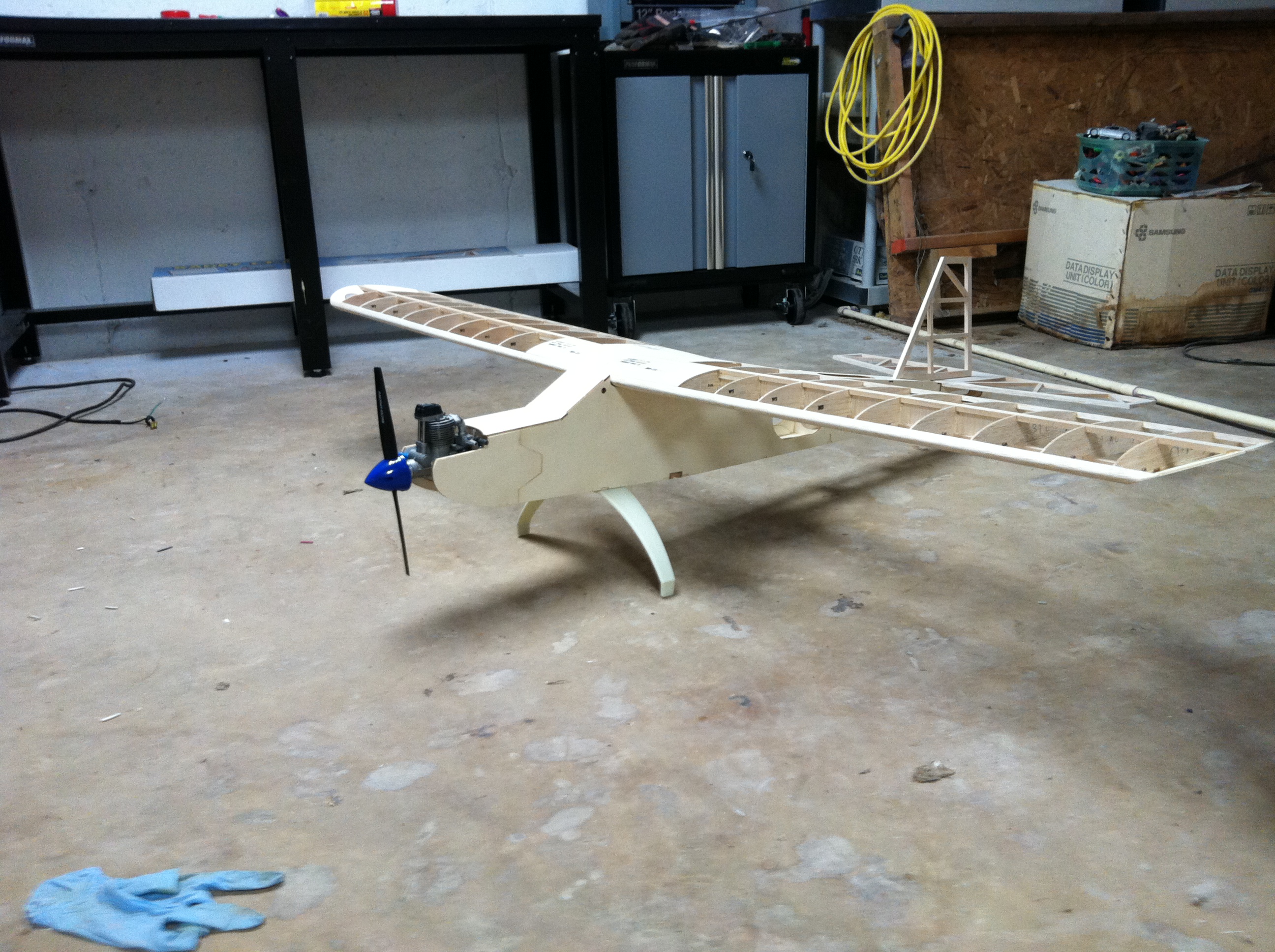

The wing assembly is complete, the ailerons are fitted and trimmed, the fiberglass center strip is done, all that is left is to drill the mounting holes for the bolts. For that I took a 1/16" plywood strip that covers both of the balsa blocks the torque tubes are in completely, as opposed to the ones in the kit that only cover a small part. I used one whole piece instead of the two little ones. <div>
</div><div>The tail wheel is in, and works good. </div><div>

Excellent subject and modifications, acdii. I did mostly the same thing to a LT-25 a few years ago;
see: http://www.rcuniverse.com/forum/m_52...tm.htm#5214279
Adding some wheel pants would pop the whole project.............
I glued hardwood blocks in the bottom of the LT-40s I've built. I used nylon bolts for the landing gear. Using a servo for each torque rod isan easy mod. I've mounted them side by side in the wing center section.

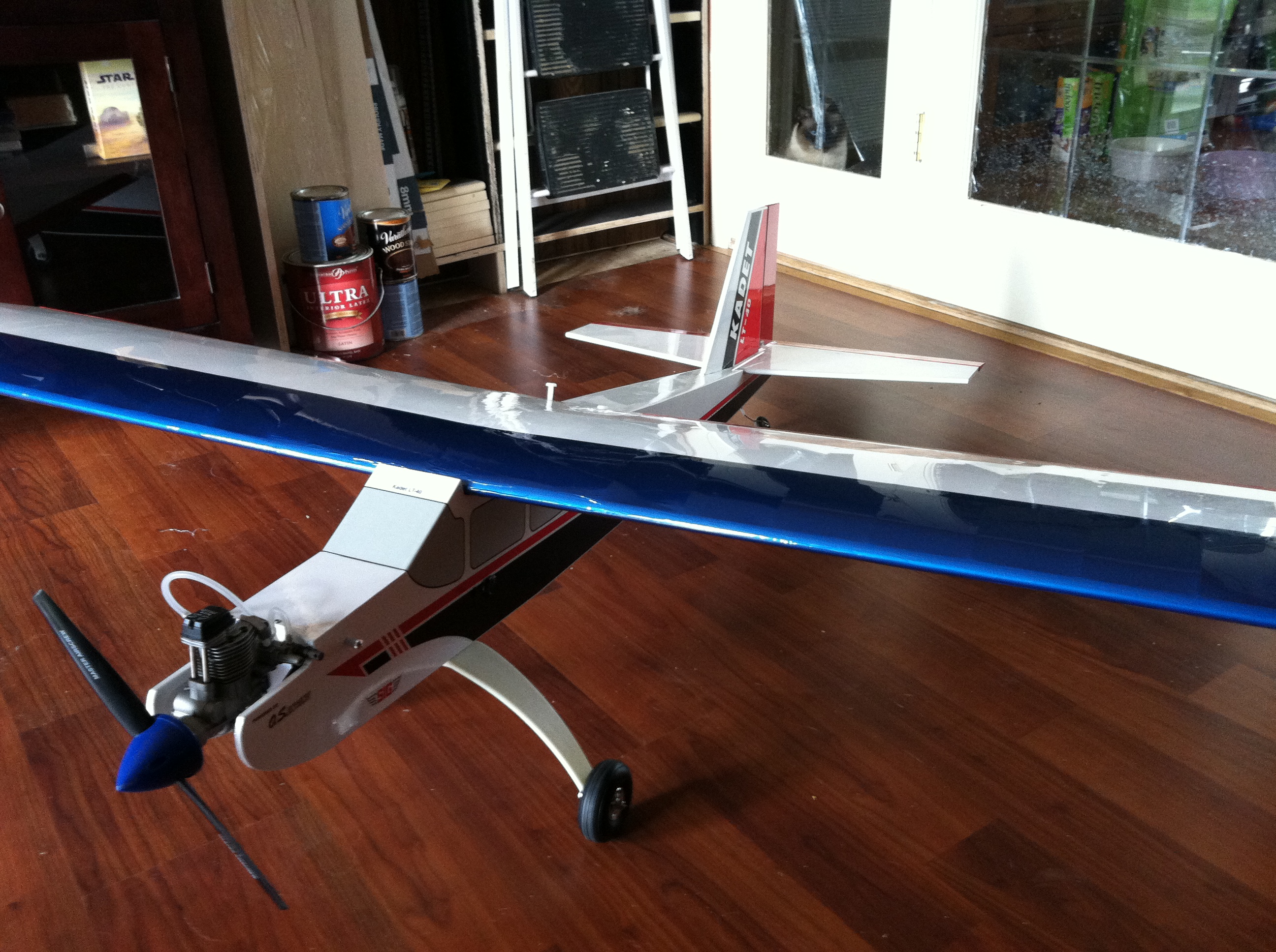

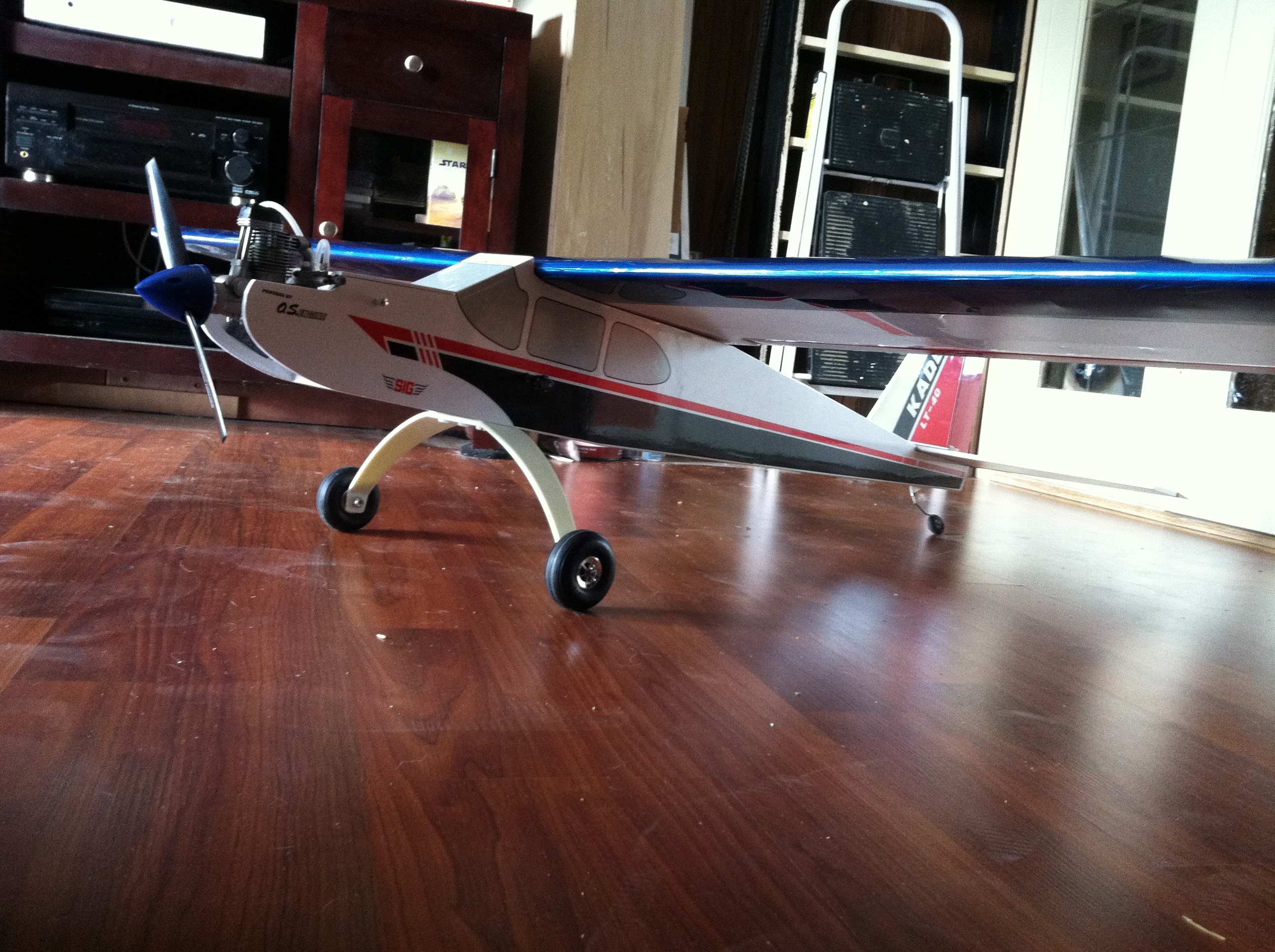

Finished the covering tonight. Looks good. Tomorrow I fit the radio, mount the motor, drop in the tanks and prep it for it's maiden. Pics when I get it assembled tomorrow.
She's all done(except Imissed 2 screws on the tail wheel, will get that later when Irun her up.)
Ichanged the title, sinces it is a .52 and not a 40 running it

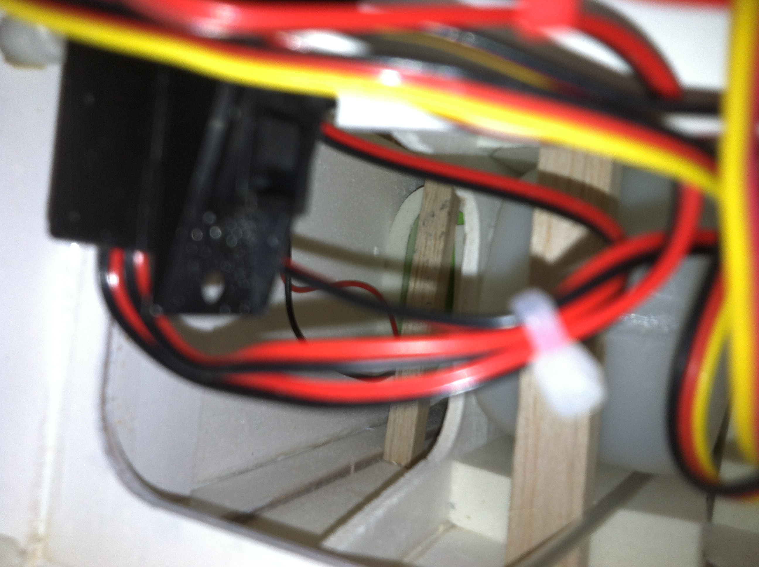

Imounted the switch and charge jack where the black of the decal is so it doesnt stick out. Ialso put a fueling line on so I dont have to unplug the line from the carb to fuel it, the line sticks out at the front left, and has a plug. Eventually I will get a fule dot like I have on my Dewey. Ilossely zip tied the fuel lines to the carb throat to keep the vent off the hot engine parts. Since the muffler is pointing down, I wont need to worry about taking the line off when I fuel, I can stop the pump when I see fuel in the line and reverse it to suck some out. If Ido miss it and some overflows, it will run down to the ground and not into the motor.
