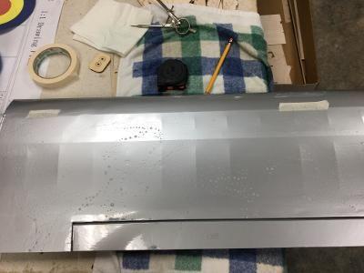

While glued dried on another project, I dragged the Flitfire out to put some markings on.

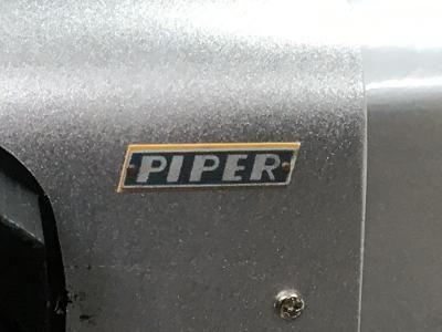

Here are the wing markings on the full-scale Flitfire at the NC Aviation museum.
First, thoroughly clean the area where the markings will end up. I use Windex followed by a solvent if necessary.
Next, position the vinyl with the carrier still attached. I usually use masking tape and make registration marks on both it and the transfer tape on the decal.
Spray and smear the area with a soapy solution. Again, I use Windex here.
Remove the carrier from the vinyl, not the other way around. That is, keep the transfer tape on your workbench and peel the carrier upward. This way, your markings stay flat.
Now, if you haven’t taken a two-hour nap, the application area should still be wet. Carefully line up the registration marks you made previously and gently lay the decal sheet on the surface. If you miss by a little, the soapy solution will allow you to reposition the marking easily.
Once satisfied with the placement of the markings, rub them through the transfer tape. I use a wadded paper towel to squeeze as much liquid out as I can at this stage. Now take a 20- to 30-minute break.
Gently lift one corner of the transfer tape and fold it over on itself. With one hand, pull the transfer tape while using a paper towel to sop up the inevitable extra liquid. Because you waited a little bit, the vinyl should have started adhering to the surface. If the decal does lift, you can just hold it down with the paper towel. As long as you keep pulling the transfer tape parallel to the surface, no harm will come.
Here I am simultaneously peeling the transfer tape and wiping the "1" in the registration markings. One thing's for certain: I'll never be a hand model.
Once you have removed all the transfer tape, use a paper towel to move as much liquid from under the markings as you can. I do not recommend using a squeegee, even one made from balsa, because it tends to cause gouges, especially on plastic coated balsa.
Most of the time, this process leaves so few and such tiny bubbles they are unnoticeable from a few feet away. If an unsightly blister still remains, lance it with a fine sewing needle and wipe away the liquid with another paper towel.
The Flitfire is one step closer to completion.

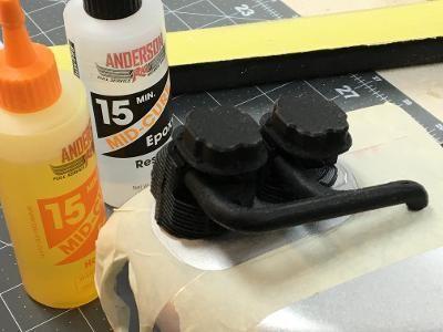

Before showing how the instrument panel went together, I want to acknowledge that the ideas behind it did not originate with me, but with fellow modeler Alan Yendle (AlanDY on this forum) who posts prolifically on RCScaleBuilder.com (under the user name Alan). He has more creative ideas about RC model building than I thought could fit in one person's head. And he is willing to share them with all of us.
First, I cut a trial-and-error pattern from a 3 x 5 card. After transferring the pattern to litho plate, I scored it with a box cutter and carefully folded each score until it snapped. The black side survived this process without a scratch, so I didn't even have to paint it.
I located some photos of actual Cub instruments online and imported them to a Word document, adjusting their size to approximate 1/5.5 scale, These I printed on glossy photo paper.
Here's where Alan's magic comes in. To create 3D bezels, he uses O-rings. A multi-size set of these are available at Amazon for around $12 ( ), The photo above shows them, along with a pool of E6000 adhesive. I ended up not using the instruments shown once I found more authentic ones.
After gluing the O-rings around the instrument photos, I trimmed the excess with a hobby knife, leaving only dials and bezels.
I fastened the dummy gauges with a dab of E6000 on each. The warning placards came from a label maker.

When I got both banks to fit in the jig, it was time to glue. Here I have cut an oblong shape in the masking tape and removed the center. It was large enough to accommodate the two cylinders and intake pipes with about a 1/8" margin. I scuffed the cowl paint with sandpaper. The cylinder bank needed no scuffing, having encountered the spindle sander on and off for over an hour.
I used 15-minute epoxy to fasten the left cylinder bank to the cowl. I mixed enough to fill the tiny gaps that still remained after shaping.

I had one further marking to track down: the Piper plate on the cowl. I located a good image online, moved it into a Word document, and shrank it to the scale size. The picture above shows a prototype, printed on plain paper at low resolution. I believe the final version, printed at max dpi on photo paper, will be even better.

Here's the final version of the Piper emblem on the cowl. It was printed on photo paper at a high resolution, then trimmed to size to eliminate the yellow surrounding it. I fastened it on with double-sided tape.
