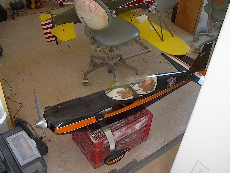

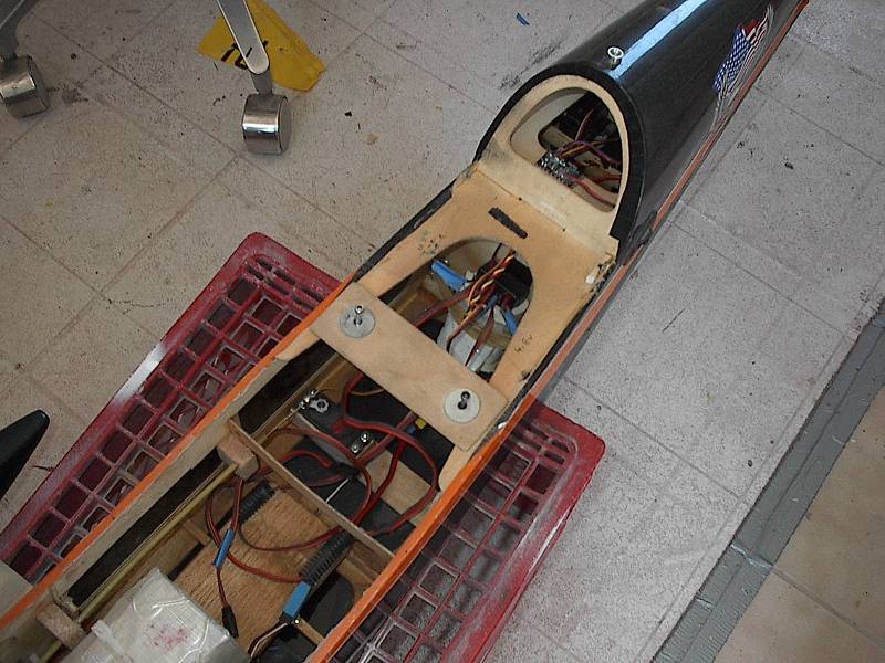

OK, this one is very old and set up a long long time ago. Glad I opened it up though, I thought I only had one elevator servo, surprise!! Too many planes to keep track of.
The LG is aftermarket, the tank and battery are over the CG or close to it. The throttle servo and RX are way back inside the wing bay. I hatched the area for the rudder and elevator servos in the area of the fuse cut out and used the cut out for the hatch. I used the old dowel and wire set up for the elevator rods and made up one of my own pull/pull systems. There is no lead at all in this plane to get the CG. The switch is on the side behind the cowl.
The OS 1.20 was just fine, the plane would fly the complete IMAC but I had to work at it because there was no over powering with it. The YS in this plane is quite a bit better but it doesn't have the power for any 3-D, the plane isn't a 3-D plane anyway. The last one I built had a different set up with the elevator servos at the rear of the fuse and sticking out the side like most planes today. I had the YS 1.40 Sport in that one. WOW!!! I liked the extra power in that one. Hope this is of some help to you, if not just hit me with a PM.
Gene
Gene

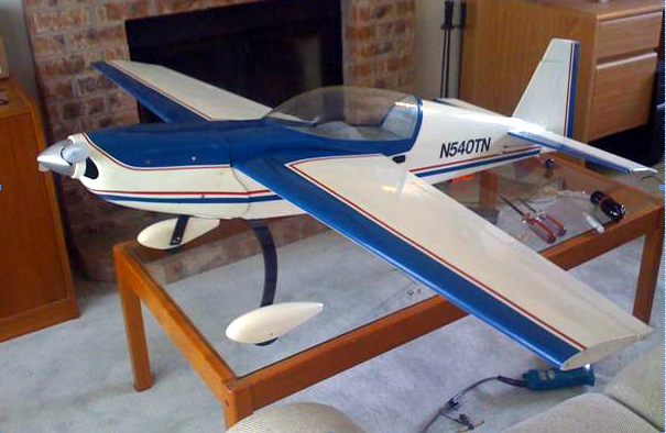

If you're considering Carbon Fiber, here's a picture of gear I recently purchased from Graph Tech. You can't really tell on this cell phone picture, but the gear is swept forward. I haven't had the chance to fly the airplane yet, but I think nosing over taxiing on grass will be a thing of the past - the wheels are at least 1 1/2 - 2 inches further forward than where a conventional gear would place them and it's infinitely easier to bring the wheels forward like this than rebuilding the landing gear block - although if you're currently building yours you could move it up at this point. The other idea, for this gear or conventional aluminum, is to put a piece of triangle hardwood stock under the gear and splay the wheels and gear forward.
If you're interested in these Carbon Fibers, call Mike at Graph Tech. This gear is "Goldberg Extra Forward Swept." Or email Mike at [email protected]

Nice looking plane WestCoastFlyer
How high is the landing gear. is it the same as standard apart from being forward swept.

Dimensions of gear:
Height 6 7/8" (measuring from ground to fuse at axle location: 8 1/4")
Width 16 1/2' (center of wheels: 17 1/2")
Forward Sweep 2 3/4", from each side of the material, front to back.
I measured with a combination square, contact the manufacturer for exact measurements.
It stands taller than stock, the wheels are much further forward. The width of this gear is less than stock, but the stock wire gear bends even on perfect landings, and so I don't have a reference for the stock height or width.
If the exchange rate is good now, give Graph Tech a call.
