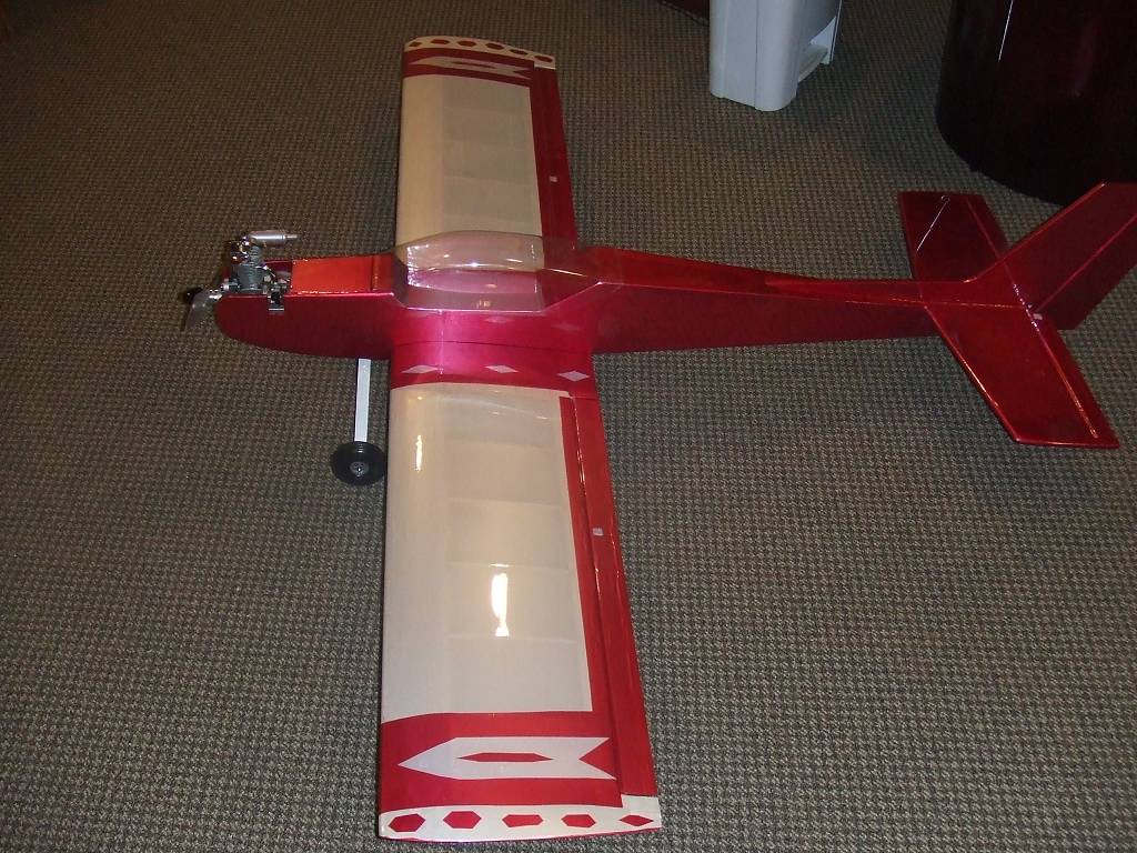

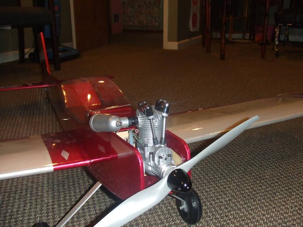

the purple color monokote is because my friend had some left over for 4 dollars a roll ...
tail dragger set up
saito 4 s
three inch wheels for grass runway
went from one wing dowel to two in front
larger plastic wing bolts instead of small metal ones
three line fuel tank for re-fuel ease
tail dragger set up
saito 4 s

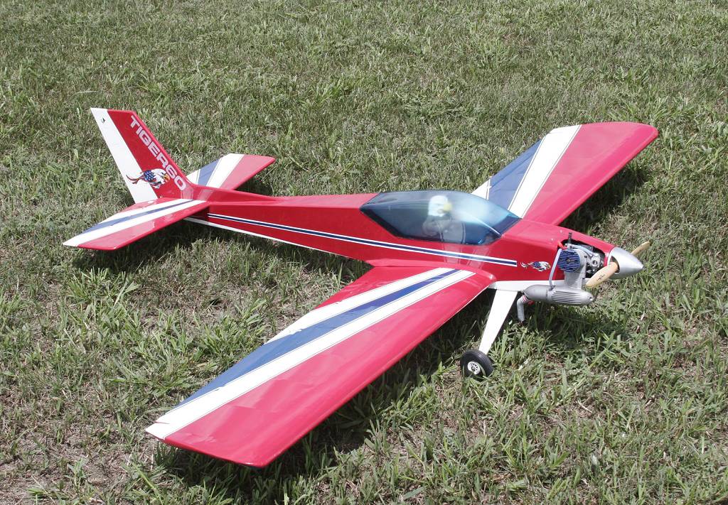

Isheeted everything with bulsa, I than used 0.75 Oz fiberglass on the full plane. Ithan Airbrushed on the paint job.
Engine is a Satio 100 Fa with a 14X7 3 blade. Iadded flaps to help land as I am at 10 LBS ready to fly. Isoon found out that the flaps are not needed, this thing will glide for days at idle. It took me 4 attempts to land as it kept floating past the runway.
It was a joy to build and a blast to fly.</p>
