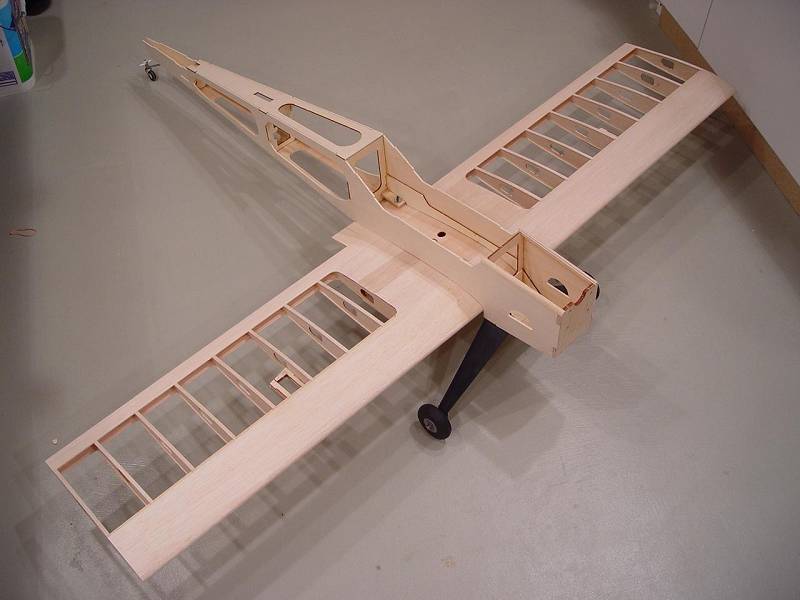

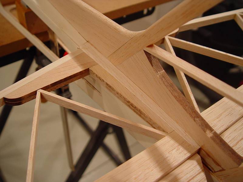

Just a few minor tasks completed in the recent week(s?).
Pic 1 - triangle stock to reinforce the firewall epoxied in place.
Pic 2 - bottom side of the wing glassed with the stock strip plus an additional layer of 4" wide .5 oz cloth.
Pic 3 - wing pin doubler epoxied to fuse former
Pic 4 - Wing mounted to fuse

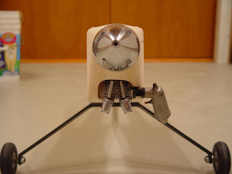

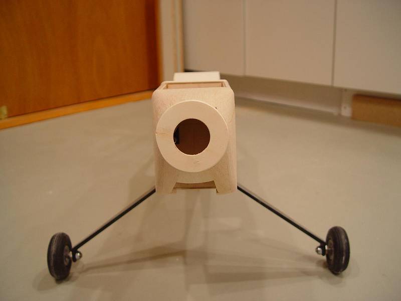

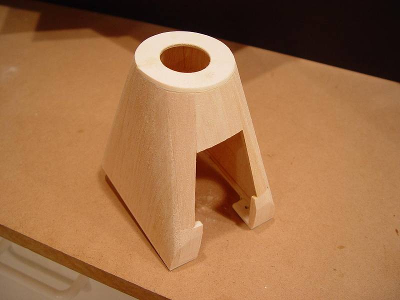

I've managed to get a few minutes here and there in the shop, so here's the small steps of progress of late:
Pic 1: using my laser level to align the wing tip t/e pieces.
Pic 2: wing tip rough carved to shape. Still needs final shaping.
Pic 3-4: lower fairing attached and initial filling
Pic 5: rear former for built-up cowl
Pic 6-5: cowl former and nose ring in place for construction
I decided to make the cowl removable, so the attachnment method will be a cleat that slides over the top of the firewall and will be held down by the hatch cover. here will also be 2 4-40 screws into blind nuts at the bottom of the firewall. There will be access to the screws from the bottom as there needs to be clearance for the head to protrude anyway. This is an experimental, "design it as you build it" process, so it may work like I plan, or it may be a total disaster. Stay tuned...

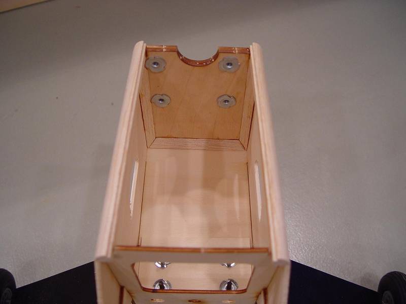

I've been a bit lax in keeping up with the pics for the cowl construction, but it's now starting to take shape. I've got all the major construction for the cowl complete - now I just need to get it trimmed to fit around the engine and do the final fill/finish work. I can't stress enough how useful a small block plane is for shaping a built-up balsa cowl. Even with the plane, I have at least 4 hours of planing and sanding in the cowl, thus far.
I've also managed to get the cockpit floor installed. However, both the rear piece and the instrument panel were somewhat undersized for the fuse, so I had to reconstruct replacement parts of the correct size.

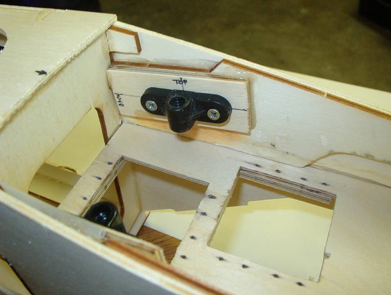

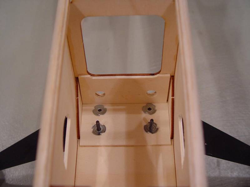

I've basically been just lurking on this thread...but I'm learning a lot from all of you guys. I am building a T60 Deluxe with the retracts. I think I'm REALLY going to like this plane, but I can tell you: the instructions are CRAP! All they did was throw in an addendum booklet with sections where you are either supposed to replace, add to, or insert steps in the main booklet. That would be OK if they had taken the time to actually proof their construction flow. If you follow their steps verbatim, you will leave out 2 or 3 key steps. Also, the pictures are terrible. They appear to be about 5th generation copy machine copies.
Anyway...enough ranting! I thought it time to share with everyone a mod that I threw in. It's not a big deal, but I was very unimpressed with the stock mechanism for the wing bolt hold-down bracket. This is SIMPLE and I feel that it strengthens this area tremendously.
As you can see, it is a standard over-the-counter wing bolt kit (Dubro I think, but any brand will work) that is added on top of a small plywood strip (on each side, of course). The wing bolt holes end up in just about the same location...I did not measure this exactly, but it is MUCH stronger and it just made me feel a lot more comfortable with this area.

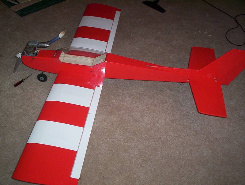

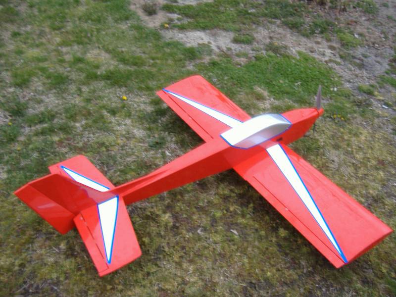

Okay I'm done with mine!
I found this thread mid march and decided to order a Tiger 2 that evening. I just flew mine again today ... so far all but the fifth flight have been deadsticks, but I think the engine is getting better. Maiden flight was with a completely red airplane just 30 minutes after gluing in the aileron hinges :-) I like to move things along quickly when possible. Boy this kit went together quickly! Some of the parts didn't fit together exactly, but with a bit of coaxing and a lot of sanding, everything smoothed up quite nicely. I couldn't wait for epoxy, so the whole aircraft is done with thin CA and medium in some places. The rear fuselage doesn't seem bad with CA as some were suggesting; maybe since I sanded the parts to fit nicely, the CA was able to work its magic. I did have to bend the main gear aft about 3/4" measured at the axles. At all but the farthest forward CG setting, the plane was verrrrry light on the nose gear. Now after bending the gear and moving the CG aft a bit, the elevator trims out very level and the plane doesn't sit on its tail. It sure tracks straight. I am happy with the performance. The stock rudder doesn't hold a knife-edge across the sky, but an OS .61FX is plenty of engine to go straight up for pretty much forever. I don't think a .91 is needed unless you just want to speed up at the expense of not being able to slow down for landings. I can't really comment on engine-on landings because mine keeps quitting, so I pretty much have to put the nose down and set up for a landing. For what it's worth, I have to keep in mind setting up a normal approach with enough space to burn off altitude even at dead stick. What else. Hm. Oh performance in the sky is great. It just goes where you point it without looking like a dart. The ailerons and rudder are plenty effective as stock. The elevator has enough authority to push outside loops with ease, so no complaints there either. I have done several rolls and hammerheads followed by swooping in for a high-speed pass across the runway. So far I've only done one snap roll because my Rx battery came off its velcro as a result; I'll have to secure it better than it was.
Anyhow, thought I'd post a little report too.
Dan
Dan

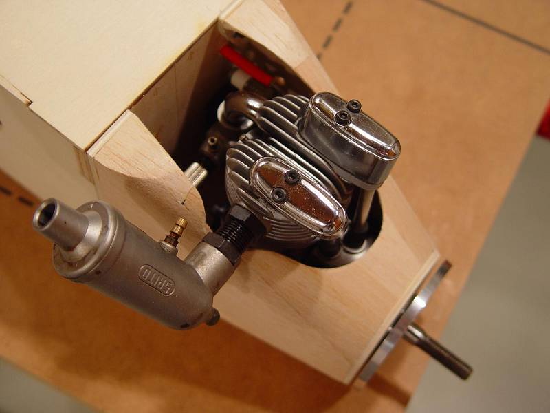

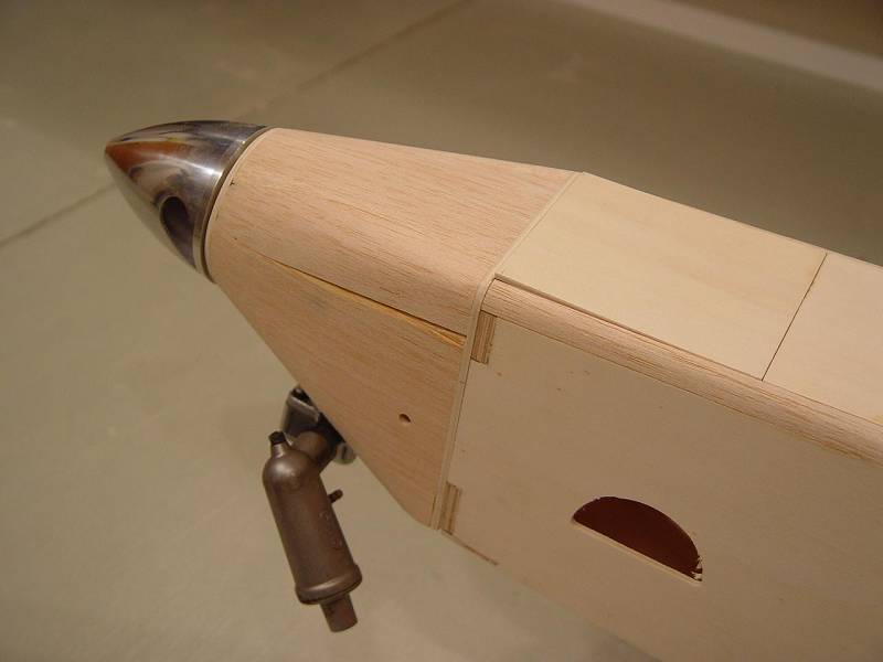

I think I've now got all the major construction completed on the fuse and cowl. The cowl is finish-cut to fit the engine and the forward hatch is installed. The throttle linkage and fuel/vent lines have been run through the firewall. Now it's on to the sanding and then back to the wing.
Pic 1. Finished cowl with engine, muffler, and spinner installed.
Pic 2. Side view of same.
Pic 3. Bottom view showing linkage and internals.

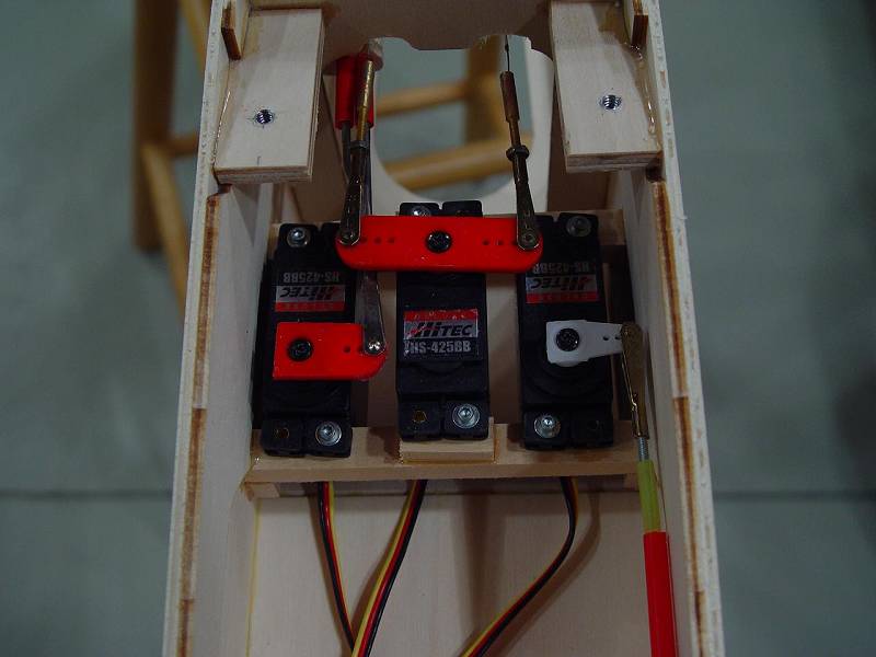

Ok, so a month goes by without blinking... but it hasn't been totally non-productive. Even though the bulk of my hobby time has been getting to know my SSE at the field, I've still managed to get a bit of progress made on the Tiger. I started to work on setting up the aileron linkage when I realized that I built the servo mounts in different locations between the left and right wing panels - DOH! So I had to completel R&R the right servo mount. With that taken care of, I was able to set up the aileron linkage. I drilled the ailerons to take a 3/8" dowl plug to serve as a hard-point for mounting the DuBro control horn. From there, it was a simple matter to solder up the linkage (Pic #1).
Then it was on to the mounting and linkage for the tail surfaces. I had decided to use pull-pull for the rudder and independent linkage on the elevator. The rudder servo needed to be offset by 3/8" in order for the elevator rods to not interfere with the rudder cables. (Pic #2) I then added the same hard-points for the DuBro hardware on the rudder & elevator and connected the linkages. (Pic #3) I ran Sullivan Golden Rods through the fuse (Pic #4) and utilized some left-over cable from a DuBro Pull-Pull kit with 2-56 threaded solder ends silver-soldered to the cables.
With everything installed and assembled (Pic #5), then came the moment of truth. I fully expected it to balance in the typical Tiger 60 tail-heavy fashion. I was pleasantly surprised (if not totally astonished) to discover that it balanced almost dead center in the recommended range. (Pic #6)
With one final finish sanding, I should be ready to start covering soon.
