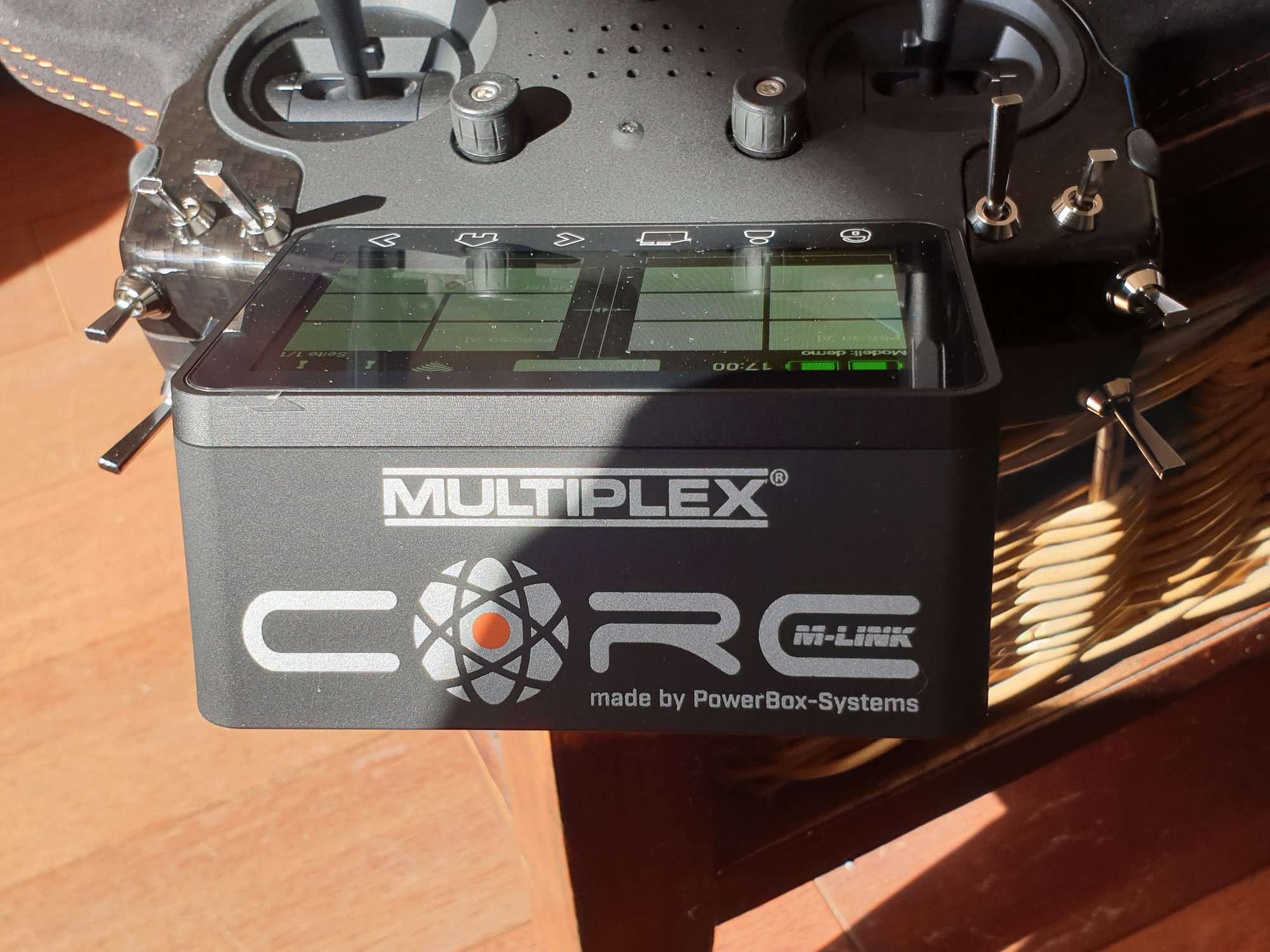

Just got a Pioneer which I have to say is a work of art, very cool never thought it would be that small.
The Pro 5 battery's are on the same level, these guys have some very impressive stuff.
