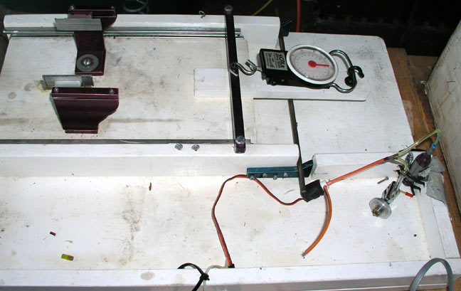

Hey ET, here is a way to keep your scale out of the exhaust and not use a turn around. This has been fairly accurate. It came within 1/4 pound of the same reading that my p70 tested on the Jetcat test stand. Scott

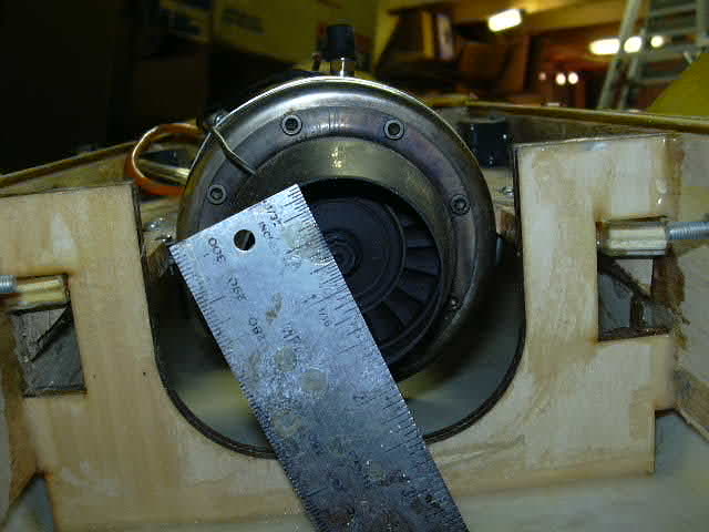

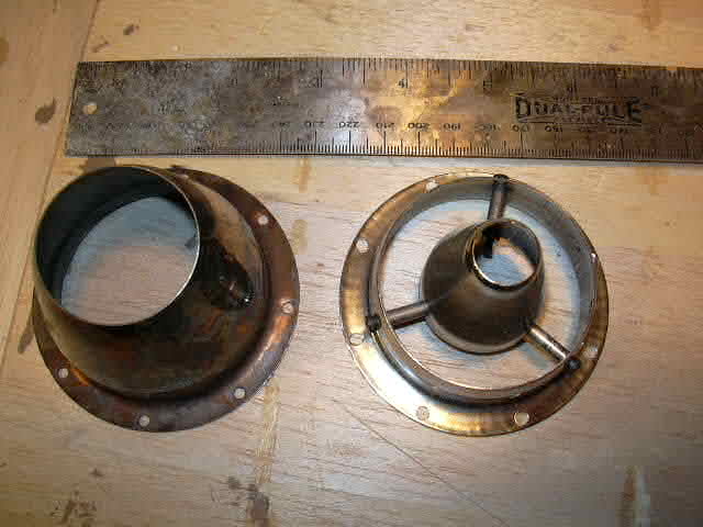

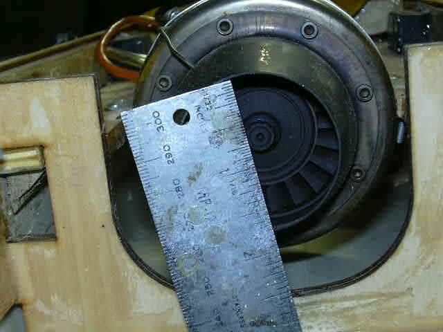

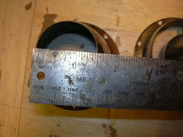

Okay, finally, the Three Tailcones Of Jetjoe.
In the pic with two cones, the one on the left is the original small tailcone provided with the earlier ones, on the right the two piece, the other pics are the new single piece tailcone.

O.K Curtis...vernier calipers and calculator out...(a) whats the throat area of each of thre three tailcones ...(b) % difference in each...?
