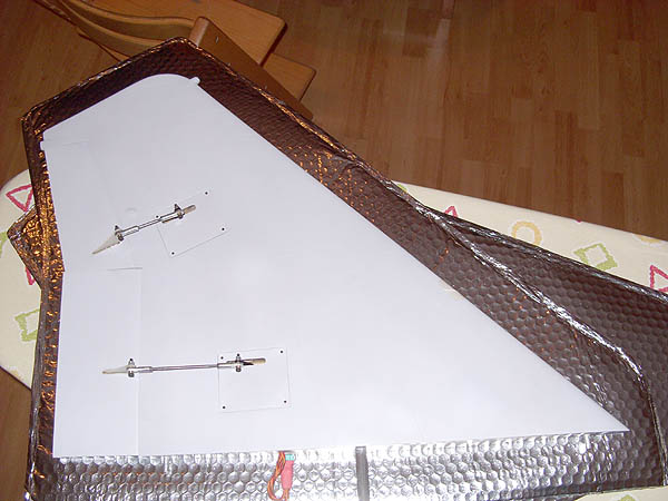

Hi there ...
before i go to the maiden ... there are some things to do ...
two things are ready now ... first a device to fill up the airpressure and 2nd my own wingbags ...

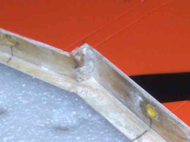

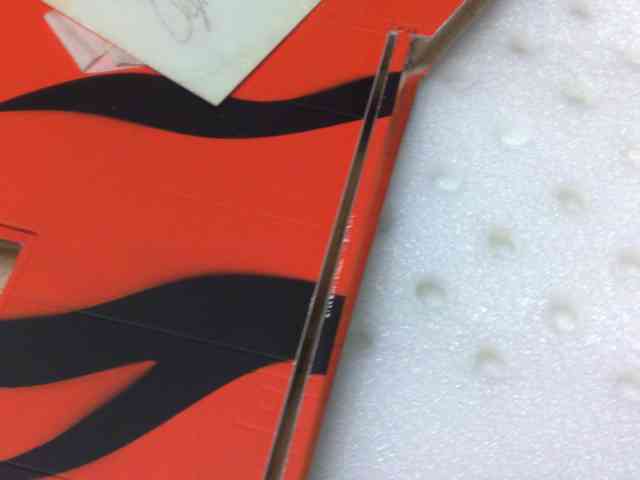

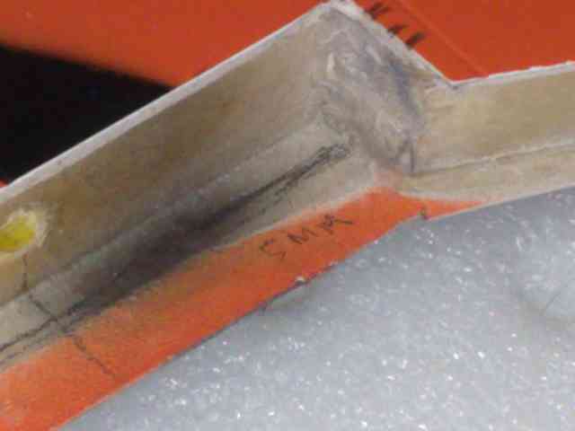

Hi All ! Now I having a big problem with the wing now [
] cos I didn't notice that the aileron hinge place got so many difference between left and right pls see the picture , and now want to put it back but don know how to do it , the piece that I cut too many already
And also found that inside the wing also break all around too
#388
My Suggestion: put the trailing edge back in place with some tape and use slow curing epoxy to glue it thru the servo openings. before doing this you should add some wood blocks for the hinges (robart type) and finally add liberal amounts of epoxy mixed with microbaloons at every fillet and even at the leading edge of the wing.
Some balsa bracing with the wood grain perpendicular at those broken ribs will solve the problem.. you´ll end with a much stronger wing without a significant weight increase.
Enrique
Enrique

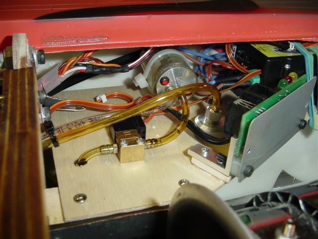

hi,
Look at the pictures for electronique installation.The balance point is to 180 mm.Have you already seen a flight of F15 advanced version with balance point at 180 mm?
Daniel
Daniel
