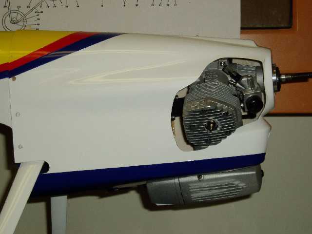

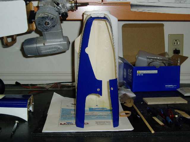

For those considering the OS 120 AX; I found the cowling too tight a fit for a side mount (and too much cutting the cowl for the muffler), so I remounted the engine at about 124 degrees (costing me a second cowl $$). As it is, I cut the bottom of the cowl pretty significantly so I added a "roll bar" under the fuselage for screws to hold the bottom of the cowl. Note also, in this position, the muffler interferes with the firewall using the short extension, and the body of the muffler intersects the cowling with the long extension. I didn't pursue cutting down the long extension to try and get a perfect internal fit. Maybe you guys will find a better fit without having to experiment with cowlings! BTW - I also added some reinforcing glass to the inside of the cowling in key places where it "stretches" over the engine when installed/removed.

I think your going to find out that the stock landing gear is a little weak. I would invest in some carbon fiber
Old 03-15-2006 | 08:32 AM
  #224
Hot Rod Todd's Avatar
Posts: 1,306
Received 26 Likes on 20 Posts
From: Robins, IA
Default RE: NEW QUEST
Seth, did you contemplate cutting off some of the firewall so you could leave off the muffler extension? It sure would be nice to tuck that muffler in a bit. I appreciate the heads up, since I am mounting the same engine on my plane. Looking forward to hearing how it flies.
