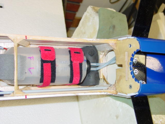

I just broke my quest. I was landing on our grass field, it was windy, and the wind was variable, so I came in a little fast and when the gear hit the grass it snap the whole front end off. I had the battier and the throttle servo up there to make it balance with the ST90. But it just broke in half. I had fiber glassed a strip over the landing gear ply on the inside of the fuel tank compartment, but should of glass the sides too. It was a very clean break. And it is fixable. But I think that maybe the whole front end needs to be boxed in if you are going to add a heavy motor. Those sidepieces are very weak. tg

It is the quest 2. I am still looking at it. I really don't think I landed that hard, I think that the wheels may of sunk a little in the grass. I think if I had not fiber glassed the gear, maybe the just the gear would of rip out. I am going to rebuild the entire front end, box it in on all four sides, this will all a little weight to the plane but maybe I can put the throttle servo and the battier back over the wing. I really like the plane. I think it is just perfect, well if it had a motor still hook to the front. Terry

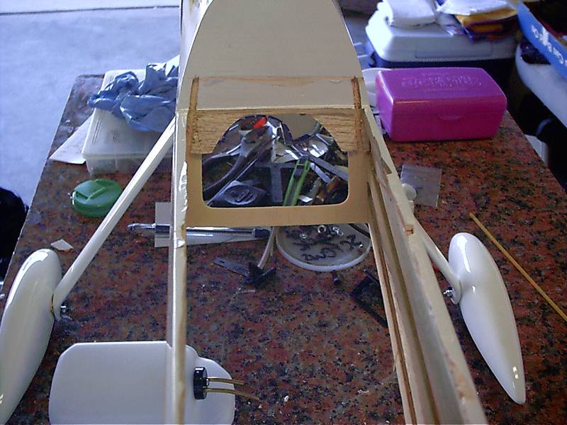

I lost my D-drive and a lot of QUEST mofifications pics. Here are some that I saved that are mine and from other QUEST users.
The 1/8" lite-ply doublers shown are similar to what I did wth the three that I put together. What you can't see is that there are simlar ply doublers in front of the former the touches the leading edge of the wing. This provides great strength in the weakest area without add a ton of weight.

Seth, The front compartment (fuel tank) broke off, the sides broke away from the bulkhead where the wing slot is. The wing bulkhead remained in place. There is not much material for support on the sides. And the top of the fuel tank compartment was not glued, to complete a box structure. I believe you would be ok if you put some small triangle stock in the corners and glued and glassed the top cover on the fuel tank compartment.
