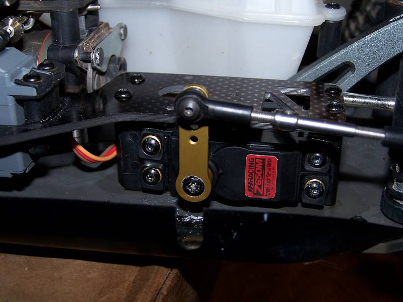

Here is a pic of my servo arm. I did use the stock one but could not get the truck to steer good. After putting this on it steers awesome![/quote]

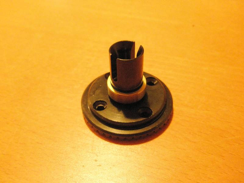

Please give me a hand - Ive got a half built diff!!
Just put the washer up to the side of the pic on the manual and see if it is the same exact size. All mine were and I had no misprints. Take some pics and post them would be better for us to help you.
Its definately the same washer, I put it on top of the diagram on the left and it was the same size.

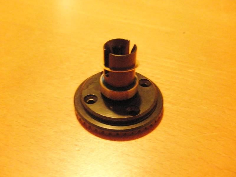

VNMSGT - Here's some photos
The first one shows the manual with the washer.
Second one shows the end of the diff with the washer next to the bearing (where it should be)
Final one shows that the washer is big enough to slide over the diff cup - Surely this cant be right?

Yes that is correct. When you put the diff in the diff case the washer will be in between or sandwhiched by the diff case and the bearing. This is what shims it inside the case to the gear that the center driveshaft connects too. When the diff is removed the washer will fall off of the cup.

Ok, it just didnt seem right! I will carry on making them up now. Thanks alot for your help. (I dare say I'll be needing it again!)
