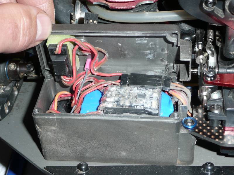

More pics. The files are large!
Gotta love Lipo!
Protek 2000 mah receiver pack
Protek voltage regulator
Spektrum sr3500 receiver
Fiber brakes with brake springs.
RC8 brake linkage!
Hyper ST RTR brake cam

I started with using a ProTek 2000mah lipo because I didn't want an external battery! It works great, plus I was able to fit everything in the receiver box! (No mods needed!!!) I get great run time even with those overkill servos!

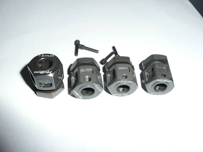

hi guys,i noticed that at full turn the wheels are rubbing on the arms.should i use the extra set of hubs,i believe it will offset the wheels a few mm.the extra hubs have the pin hole closer to the edge,i tried it on but i have to shim it to get rid of the play.so which hubs you guys are using.thanks

I use +2mm hubs with JConcepts Rulux Half-Ups half offset rims. Seems to do the trick! The JC's have a nice bevel around the wheel hex but you still need to space it out with at least a +2mm set! You could also use +8's with a standard offset wheel and get the same effect! If you run standard offet, and are intersested, I have a set of +8's I could sell for $25! I used them for about 3 minutes with my half offsets. It was too wide for me!

I am using 1/2 offset Proline LRP rims with LRP holeshots and have no issues with rubbing with full turn.
