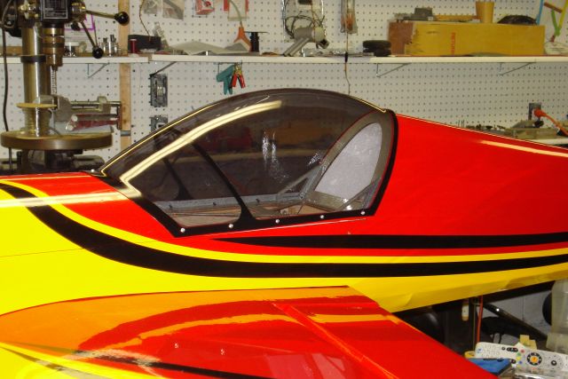

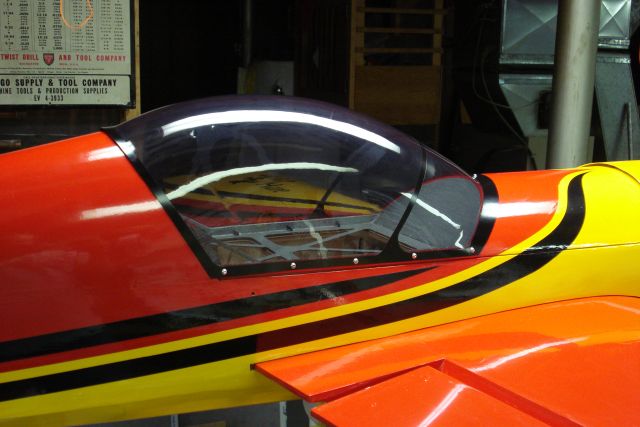

Hey Guy's! Just wanted to throw up a few pics of my painted canopy. I'm pretty pleased with it!
Andy

ORIGINAL: Flyer Freq
Andy
Andy, Your canopy looks great! I'm at that stage on mine and I think I will follow your lead. Did you attach it with screws only or with glue and screws? If you have a minute to describe your install that would be great!
Jeff

Default RE: 50cc Sukhette Build Thread, now in progress!!
The canopy is only held on with screws. I drilled the holes through the canopy and the cockpit wood. I had some Sullivan, flexible CF push rod material that I cut into 5/8" pieces. I re-drilled the holes in the cockpit to snugly fit the push rod material. I used CA to glue the CF pieces into the side rails, and Gorilla Glue to glue them into the foam/wood front deck material. This gives me a hole to screw into that will resist the screw backing out from vibration. I may add a couple more screws in the front deck, to make sure wind doesn't get under the canopy.
The paint I used for the canopy is Rustoleum for plastics. I used painters tape and Tamiya pin stripe tape for masking. I got real sharp paint lines!
I am tempted to put a pilot and control panel in the plane, but I think I will fight the urge.
I hope this helps!
Andy

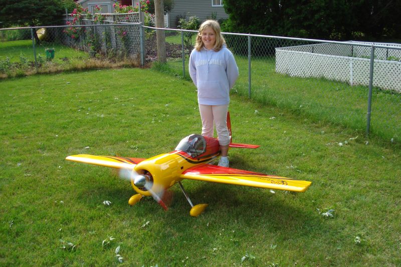

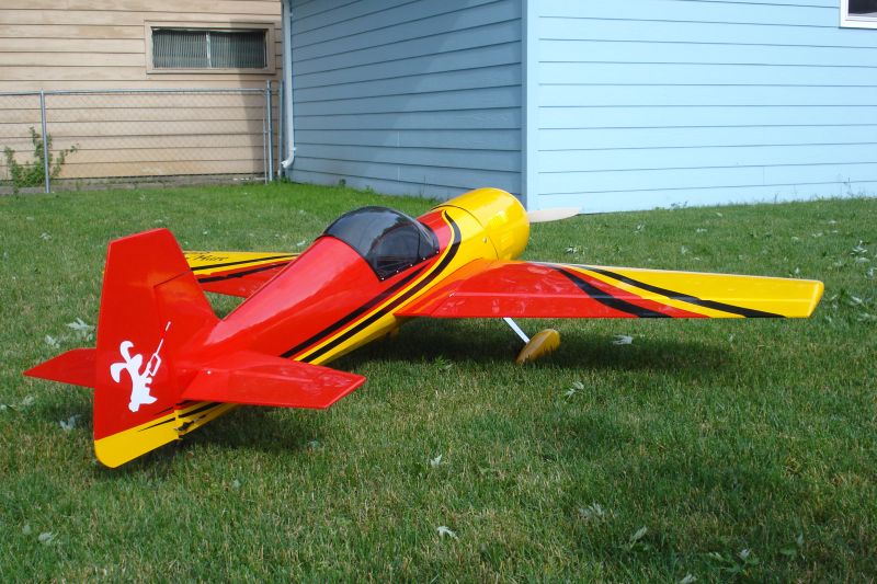

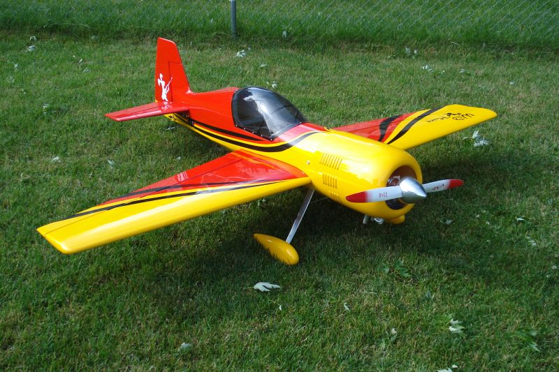

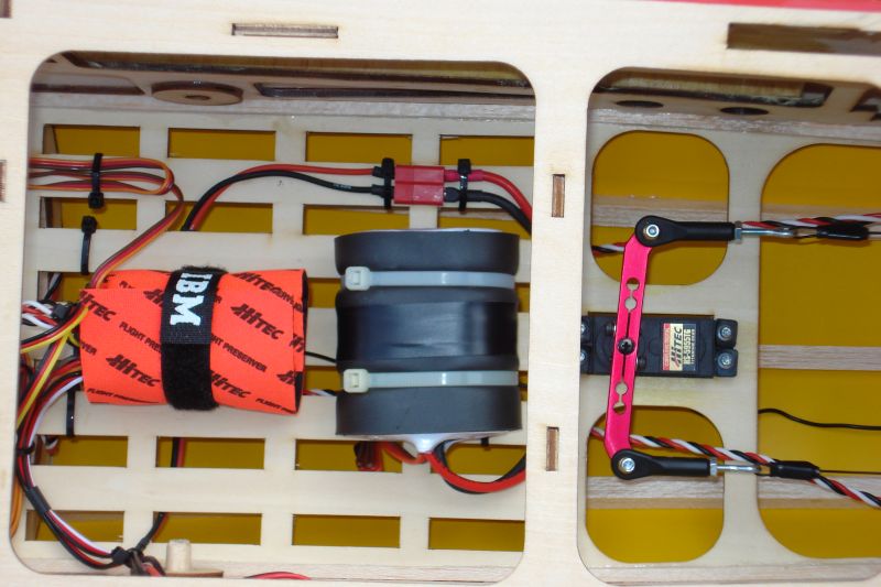

Here are some pics of my nearly completed Sukhoi. Hope to maiden it this weekend, weather permitting. Haven't decided if I am going to add graphics. I like the way she looks without them.

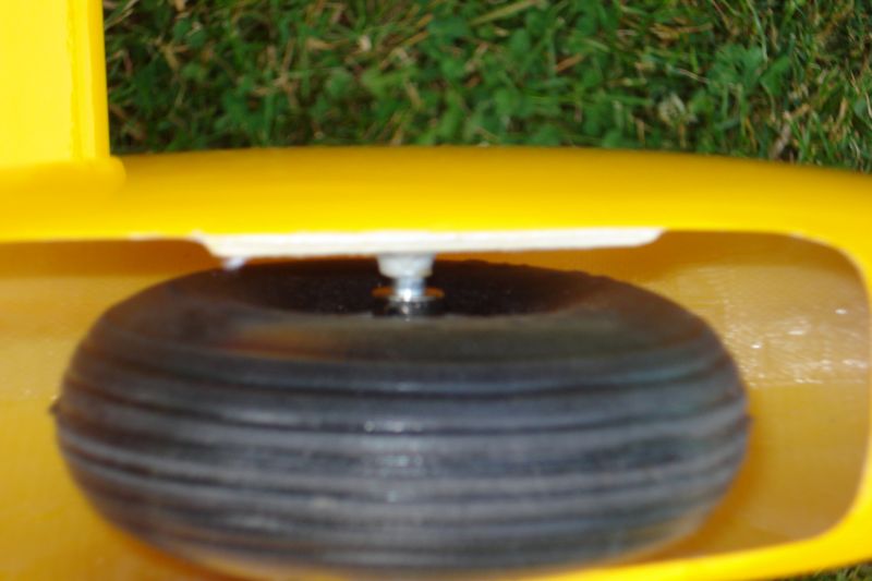

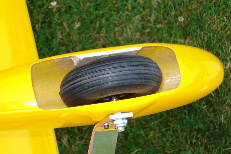

Here are a few more:

Flyer FREQ
Looks really nice mate, all the best for the maiden
Cheers LEE
