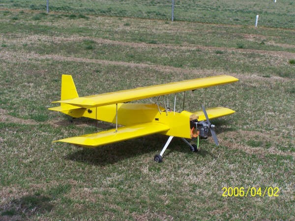

Wow, we finished our UCD60 with the Saito 125 and this thing-is so smooth in flight. My son is doing extremely well with this plane. He lands it perfectly, can hover (at altitude) for as much as 15 seconds, flies knife edge pretty well, and the rolls are quick and good looking.
He has only flown 2 gallons of fuel since he started flying and he has no problem flying this plane pretty well. I would urge anyone to consider the UCD as their second plane as long as you can practice throttle control.

We are using a 16X4 wide prop. You can use covering to close those gaps between control surfaces. Those gaps need to be as close as possible while you're building.
FYI: We used the provided engine mounts and mounted per the enclosed instructions and everything is really good. Our instructor who took it up for the first flight said this was the first plane he didn't have to put one click of trim in any direction. I guess we were really lucky.

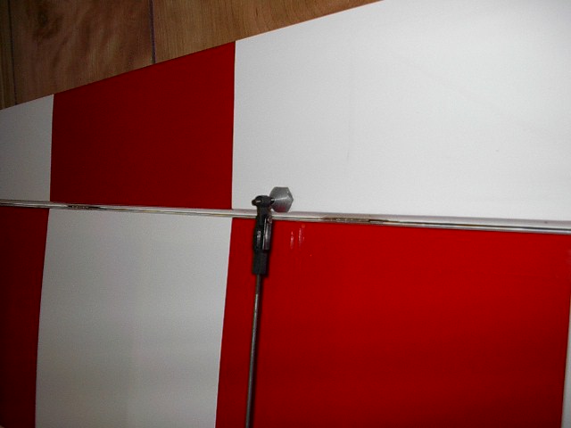

fliggyg, your on the right track with the tristock installed vertically in the corners. What I have done is to add one more dowell between the two existing ones and it ends up very strong. Mine averages about 250 flights per season X three years off a rough runway and its fine. Not over done, but strong enough for the ocassional spanking. There is only one reason why I would not glue wood blocking in between the formers. I have snapped the tee nuts, or blind nuts, for the bolts and you may need to get in there and replace them. With tall LG as these, it does increase the chances of a misshap, but you will find that this plane floats in so gently, chances are you won't knock them off. There are UCDs out there running stock without problems.
For the pinned hinges, a metal nail file works well on the hinge slots. A couple strokes in/out and its good. Also the file will straighten out any slots that are out of allignment by angleing the file in the direction it needs to be corrected. Dry fit all surfaces and check for binding. Epoxy works well with hinges of this type. IF you are quick and confident, 15 minute. If you are unsure of what you can accomplish, go 30 minute epoxy to play it safe. I do the wings and stabs first and when dry do the control surfaces.
Take a hobbby knife and cut away a small amount of monokote from around the hinge slot.
Dip the knuckle of the hinge in oil so the glue dosen't stick to it. You can use a CA hinge to stuff the epoxy into the slots to make sure its sufficiantly coated. Do one section or surface at a time, check for alignment and move to the next section.
Lately on larger gassers I have been useing gorilla glue for the hinges, but if this is your first experience use epoxy.
Here is a pick of the cut away around the slot and a typical 4/40 set up. Good luck. Joe

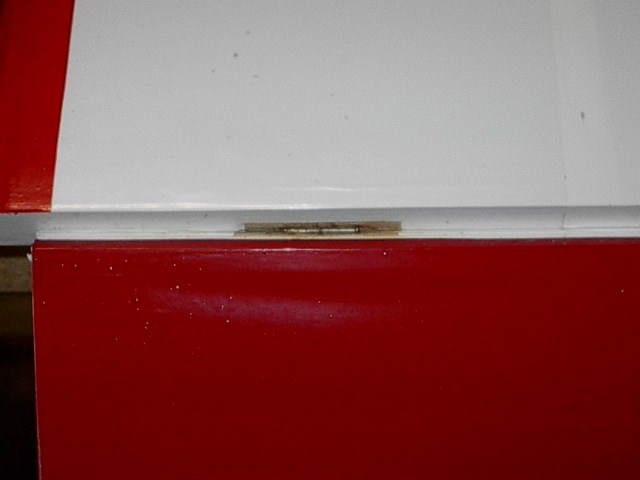

How wide a hinge should there be? Mine is almost 1/4". I have not glued them yet .. Here are the pictures.. I am affraid they are way to wide and too much travel.. please someone let me know .. So i can permantly glue in place...

fliggyg...I don't think your hinge gap should be nearly that wide. You need to take a nail file or hobby knife and cut the hinge slot a little deeper. It should be only as wide as the pinned area of the hinge.

fliggyg, you should be looking for app. 1/16 inch gap. Those are big hinges. Here are your choices:
#1 Cut a bevel around the hinge slot so the knuckle of the hinge will inset into the balsa for a narrower hinge line.
#2 Use a smaller hinge. They will now be loose in the existing slots due to the thicker ones in there currently, so, gorilla glue is an option as it will fill the void.
#3 Plug the slots with balsa and wood glue, then re-slot for the thinner hinge.
#4 Abandon the slots and cut new ones next to them.
Option #1 is the easiest at this point. Here is a pic of what to shoot for. Good luck. Joe
