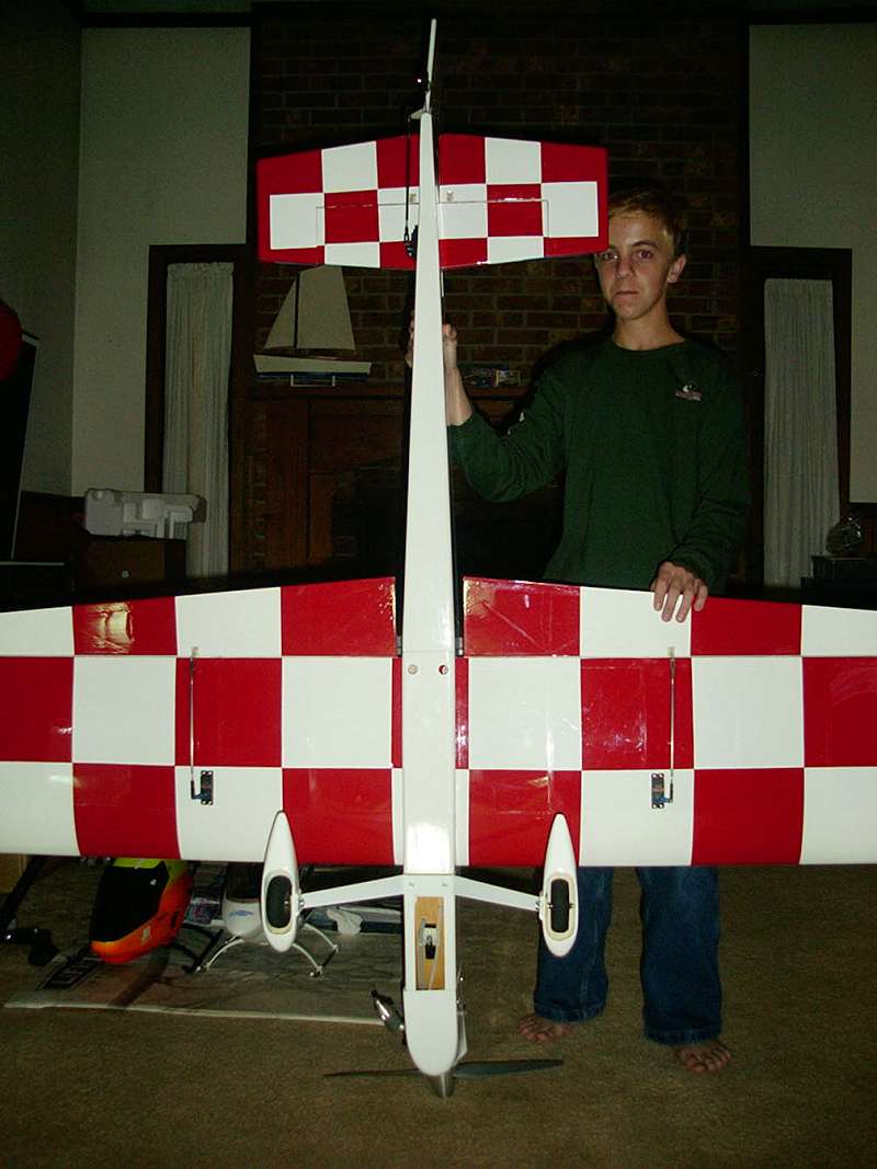

Im runing a YS140DZ with a APC 17x10w, on my 60 size u-can-do, it's a lot of fun[sm=spinnyeyes.gif]
Holy crap! I bet that thing rips Ever get worried that one day you will be cruising around the sky the the plane will just explode? [sm=lol.gif]

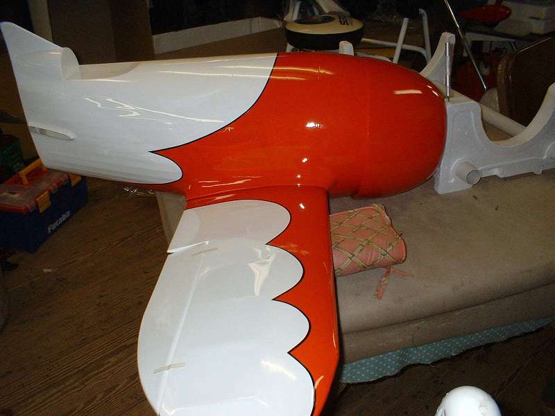

I fly at 1/4 to 1/2 thro. it will go out of site at less than haft thro. hover les than 1/4 thro. its a blast,, i will be changing to a ys91ac soon, the 140dz is going in a new project. a GP, Gee Bee now that it is broke in.

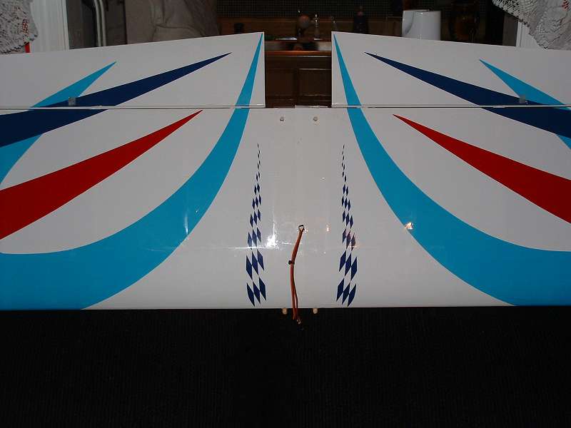

I am bulding the wing now and cant find the exit holes for the servo extensions. Can someone show me where the exit holes are?

Diablo, the exit hole is covered with monokote, but look and feel carefully and you'll find the outline of the hole.

you got to feel for them but here is a pic

Dialo, Right in the center 5 3/8" back from the leading edge. Joe

thank you gents for the pic and the info! Almost done now

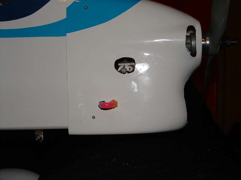

Does anyone have a suggestion for how to route the fuel lines on the U Can Do w/ a YS 120? Do I need a third line or can I splice a T into the fuel line to the fuel button?

Birdy, I've got a YS110 plumbed up with only the fuel line and the pressure line. I tee'd into both and ran the lines down and out the bottom of the cowl. I fastened them with velcro so they don't hang out but are accessible when I fuel. I pull one dot to vent then pull the other to fuel up. I've decided to clamp the fuel entrance to the motor before I fuel because some of the pump pressure is forcing fuel into the engine and overflowing from the carb. Makes a mess I'd rather not have. Don't forget to vent after flying or the same thing can happen. You can barely see the lines in this pic. I'd take another but it's in the Jeep and to nasty outside to go get it.

I see your fuel and vent line, but what is that black thing that looks like a hole?

People who promote the use of fuel dots instead of filler valves never seem to mention what "I & C Tech" discovered. That when you fuel through a tee'd fuel line the fuel flows both ways out of the tee, toward the tank and toward the engine thereby overflowing the carb. I currently use a Sullivan filler valve to fill the tank and have been hoping to find a simpler way to do it. It appears that fuels dots are not the way to go.

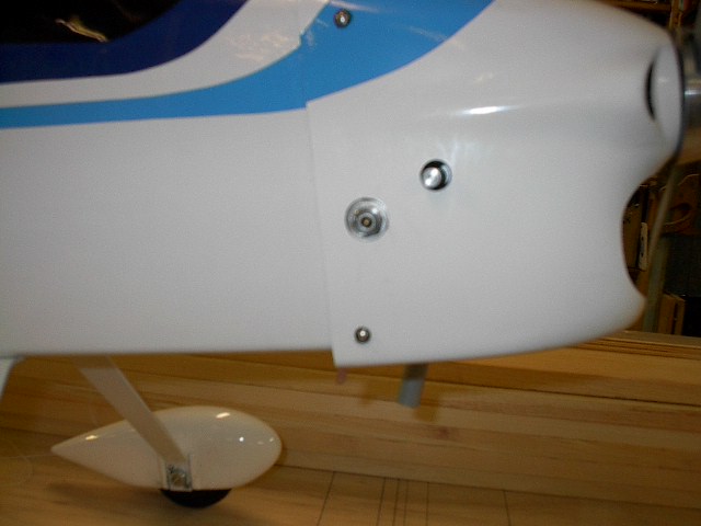

and the solution to everybodys fueling problems?????
bulkhead fitting for 4.29 at tower
[link=http://www2.towerhobbies.com/cgi-bin/wti0001p?&I=LXG851&P=0]tower hobbies fuel bulkhead fittings[/link]
just pull one end off and fuel no more fuel in the carb!!

Thats not always the case though. If you are using a fuel regulator with fuel dots/tees you will not have the same flooding of the carb.

James,
Bulkhead fittings are a good suggestion. Thanks.
