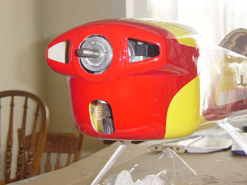

Got mine today!!! 11:30am
Went right to work on it! It's all hinged and the O.S. 1.08 is mounted with a pica P-51 muffler... check it out.

Well I put the stock mount on and checked the fit with the YS 110/slimline
pitts.... It'll fit... per the 5&3/4 spacing... But the pitt's does "slightly" touch
the firewall?????
