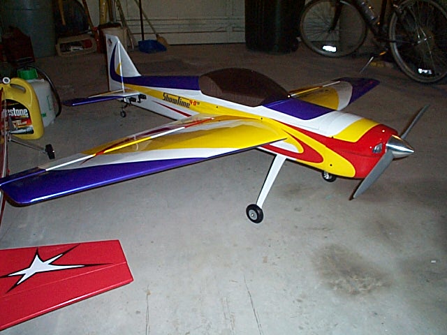

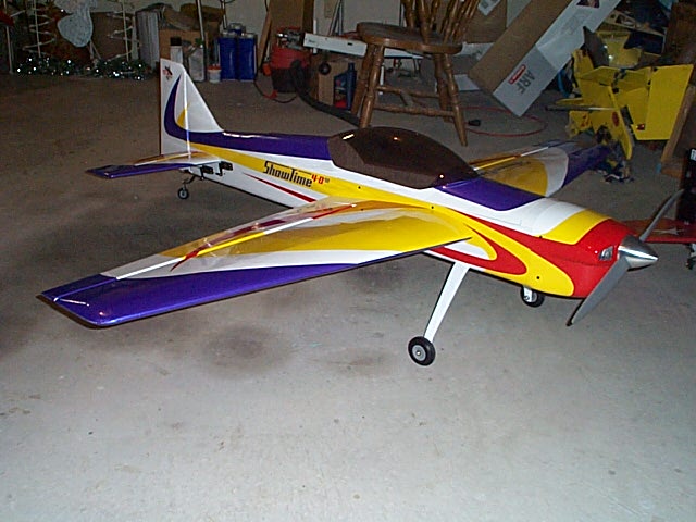

Hi all... 7-8 months in the box.. Hoping for a "for sure" fix for the "elev. uncontrol"....
Anyway she's pretty much done... won't fly tomorrow, but maybe this weekend... Just
have to remember (just incase) Throttle first and let the YS pull her up)))))))

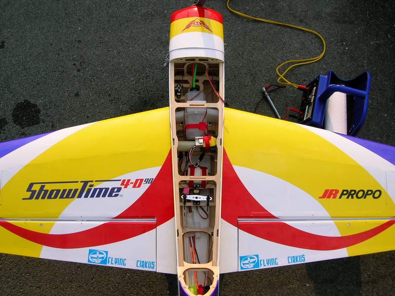

Hi guys,
Thanks for the answers regarding the CG location, I will fly it this weekend if I don't like it I will move the rudder servo at the tail. The plane is intended mostly for freestyle precision and not hardcore 3D. We'll see anyway...
Here are some photos. My setup is:
-YS 110 with TETRA high pressure tank and APC 16x6 prop
-JR DS 8425 Digital Coreless MG (same as DS 8411 MG) all around and HiTec HS 81MG for throttle
-SmartFly Voltage regulator set at 5.2V
-NMP LiIon pack 2400mAh
-TruTurn Spinner with light backplate
-MK and JR metal heavy duty horns
-JR 10ch Synthesized Dual Conversion Rx
All the above were selected carefully, I hope the plane deserves this setup....[8D]
Rgrds,
Nick

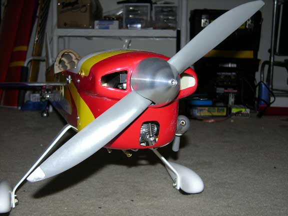

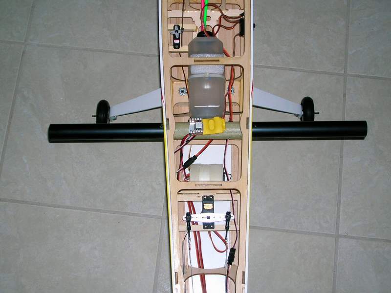

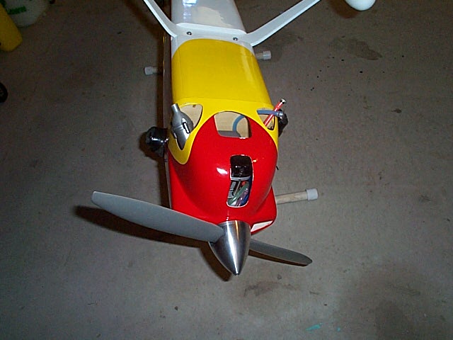

Well Here is my showtime...
Powered by the Saito 125 with cline reg.
4 hitec 5625 and 1 5645 servos
5 cell nobs sanyo HR4/5 FAUP 1950 battery

nickolas: Looks like at 2 1/2 inch arm on your pull pull correct? Did you cross your wires or they are strait through? I put the 2 1/2 airwild horn and I couldn't get the wires working right when they were staight through so i crossed mine.

Hi Rcfury,
The wires are crossed, Mike McConville suggested to cross them. The servo arm for the pull pull is made by JR, very nice quality. I figured out that those arms are very large resutling in massive throws. I have drilled the inner hole and I get around 40-45' degrees in all surfaces, if I used the outer ones I had to reduce the servo travel a lot. Now my travel adjsutment is 150% for all servos except rudder, this gives me 1024 bits of resolution.
Rgrds,
Nick

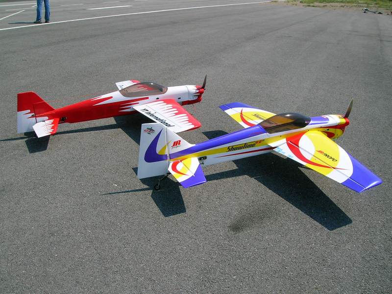

Hi,
I had 3 flights with the Showtime last Sunday. The plane flies pretty well, I still break in my YS-110 and did not perform any hovers or torque rolls. The engine works very well, I did not expect it to be honest. I perfromed some pattern maneures rolling circles and harriers. I had to reduce the aileron throws from 45' to 30' in order the plane to be controllable in rolling harries, the plane feels pretty light in rolling harriers with this throw. Knife edge performance is pretty good, coupling is nearly non-existent. Tomorrow I will probably go through a trimming sequence to see what I can improve, I have the impression that it is tail heavy as in 45' inverted uplines pulls towards the belly.
I want to ask something in this forum: WHAT IS THE DEAD SPOT THAT EVERYONE IS TALKING ABOUT?????? The plane is very predictabe I did not experience any dead spot...that's why asking.
Hopefully this weekend will take some videos and more photos, I'll let you know.
Here some photos with my friend's Adrenaline powered by a YS-110 as well, they are very similar don't you think?
