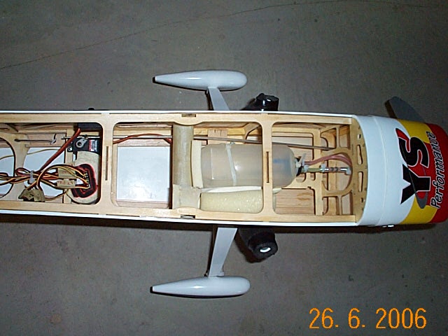

Construction on the showtime progresses. Servo issues solved -- matchbox does the trick - this is also a pretty easy way of aligning the elevator halves. I test fired the YS110 the other day and had the throttle reversed on it so it went up to full throttle and scared the ********* out of me! It also filled the shop up completely with a noxious white smoke that made me leave the shop for half an hour! I had a vent fan going, but the smoke from the YS was too much for it.
The YS vibrates quite a bit, though, and it split the balsa floor of the showtime -- gonna have to dremel out some more and put some glass cloth down. Also, hooked up the incidence meter to the wings and stabs -- DANG! my right rear stab is off 1.8 degrees. All of the other surfaces were within .5 degrees or so of eachother, but I'm gonna have to do something about that stab -- probably dremel that too and then glue it.

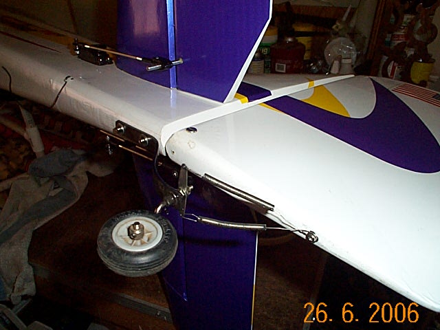

Banche... I had the same problem on the tailwheel springs... I started to move the
attachment point to the front, but then I just "stretched" both springs as Barry said,
there a bit loose in the neutral position, but no ground handling problems. I used all
the stock equipment, except for a tetra fuel tk.<sp> tk. for the YS..
No flt. or equipment problems in about 65 flights.. I did Gorilla glue my stab/wing
tube in... She flys Sweet... Added another 3 flts this morning I'm getting "lower" &
slow.. But not sure how far down I'll go[:-]... It was just to HOT around 8.. So had
to call it a day............ The Heat is on, in this here AZ...........

The stock tail-wheel set-up is in my opinion a joke, the springs add way to much pressure on the rudder servo and will cause excessive drainage on the battery and possible blow back of the rudder. Like many here said before, either have it free-wheel !QUOT!free caster!QUOT! or what I did. I installed a Sullivan Tail-wheel set-up that works great.

Garrelc... Here's a few pics where my rec./battery is... Battery in foam next to tk... It's
surprizing that my S.T. is still here[X(]... My 6v battery started out on the bottom of the
fuse just ahead of the elev. servos.... rookie mistake on balance..... Made 3 flts. with it
in the general area.... WoW... talk about touchy... my breath on the sticks would make
it sky rocket up[
]... Hands off inverted it would climb better than some trainers using
full push... I needed "push" to land.... But it was no problem.....
Where the battery is now, I'm a bit shy of the recommended and I like it, As I said I
have no problems so far in 65 flts.. T.O.'s and Lands Great!!... I also sealed all my
control surfaces with cheap tower clear... It's what I had and useing on all my planes..
