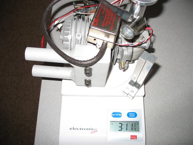

My B46 arrived today. Looks great!
I weighed it and all up for motor, muffler, CH, spark plug, motor mount & screws is 3.75pounds. To verify my scale I went to Cub grocery and weighed it on the check out commercial scale with the same results. Picture attached does not include weight of mount screws.
It looks great. My plan is to give it an easy heat cycle break in. Hopefully I will have some test stand numbers by Monday with SK19x7, 20x8 MA Scimitar, 20x8apc and NX21x8.

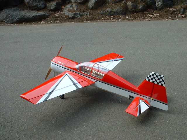

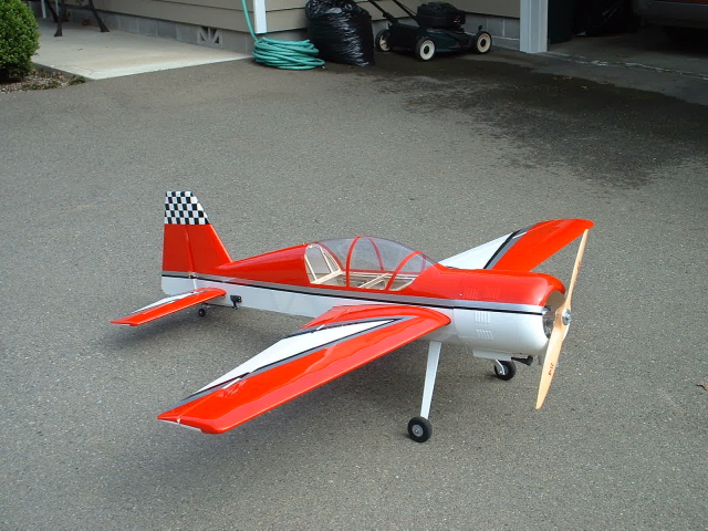

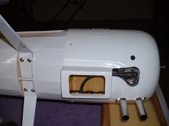

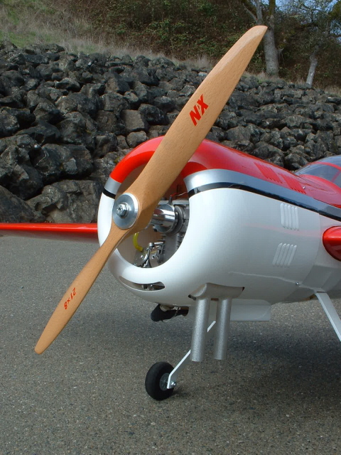

Here you go,
I haven't been sorry for even a little moment since ordering this Combo. from you Scott............RJ

Old 03-09-2007 | 10:33 PM
  #156
Scott Ellingson's Avatar
My Feedback: (146)
Joined: Aug 2004
Posts: 1,032
From: Avon, MN
Default RE: Brillelli/Extreme Flight COMBO!!!
VERY NICE job on the cowel. It looks good. Minimal cutting.
How much have you run the engine. Also you could get away with a 21x8 prop if the pull isn't enough with the 20 I am sure it will be more than sufficent !

Looks great! Nice Pictures. Have any pictures with cowl and canopy off that you could share?
How large is your air exit on cowl cut out?

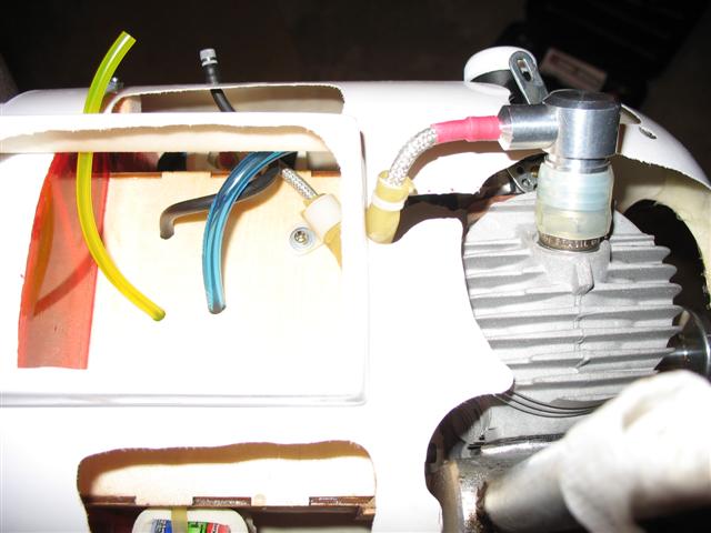

STA, Here's several more pix. I read your post in the gas engine forum, my B46 came with a Zama carb and I have noticed none of the sensitivity you mentioned. The only change I have made is to richen the hi-speed needle about 1/8 turn when I added tubing to the static port and moved the port out of the prop wash.......... RJ

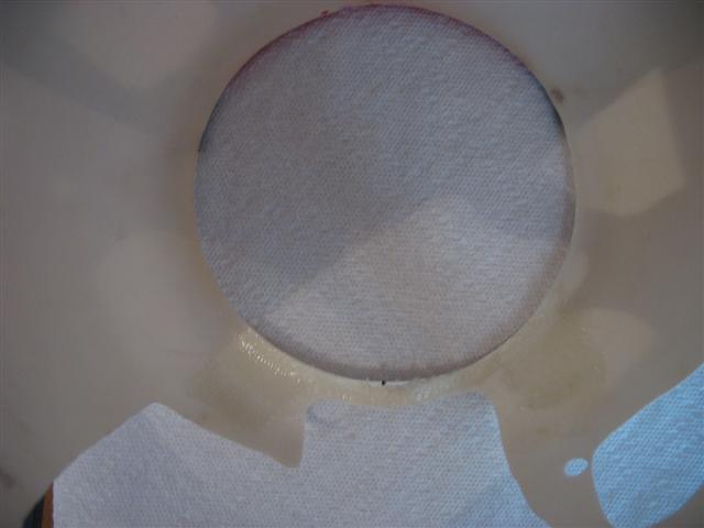

Old 03-12-2007 | 08:17 PM
  #162
STG's Avatar
STG
My Feedback: (26)
Joined: Jul 2003
Posts: 3,518
From: New Richmond, WI
ORIGINAL: RJConnet
Thanks. It is always fun to see how other people do things.

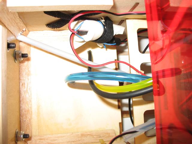

RJ, what is that fuel tubing for that exits above the muffler out of the crank. My B46 has screw in that.
Ed
Old 03-12-2007 | 09:46 PM
  #164
My Feedback: (146)
Joined: Aug 2004
Posts: 1,032
From: Avon, MN
I am curious about that too. It i to presurize a smoke tank and needs a check valve on it. If not used for smoke it should be plugged or there will be a big crankcase leak causing it to run very erratic and lean.
Old 03-13-2007 | 12:43 AM
  #165
Posts: 680
From: OR
Ed and Scott,
I am using that pressure tap for the pressure pulse to the Carburetor. I found that I could get a really straight shot from the throttle servo to the carb thru the engine box by reversing the arm on the carb but the original pressure tap and neoprene hose interferred with throttle arm in that position. I have no intention of using smoke so I just plugged the hole with a set screw and moved the tubing to the other side.
Scott, Use any of the pix you like, no problem. I am in the process of a very slight rework of the area where the plug wire exits the cowl which will prevent any possibility of the fiberglass cutting the insulation.
I am hoping that the cut-out in the bottom of the cowl is sufficient and will do no more cutting unless experience tells me it's running too hot. We have a vey moderate climate here with no more that 4 or 5 really hot days during the summer. [8D][8D]........RJ

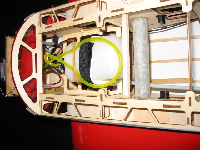

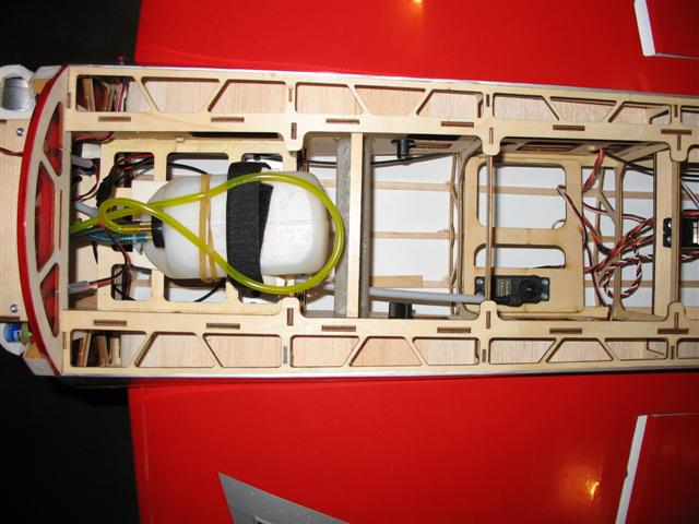

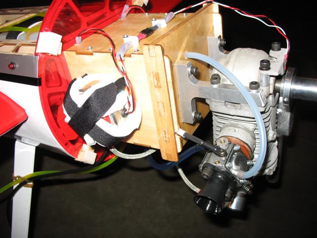

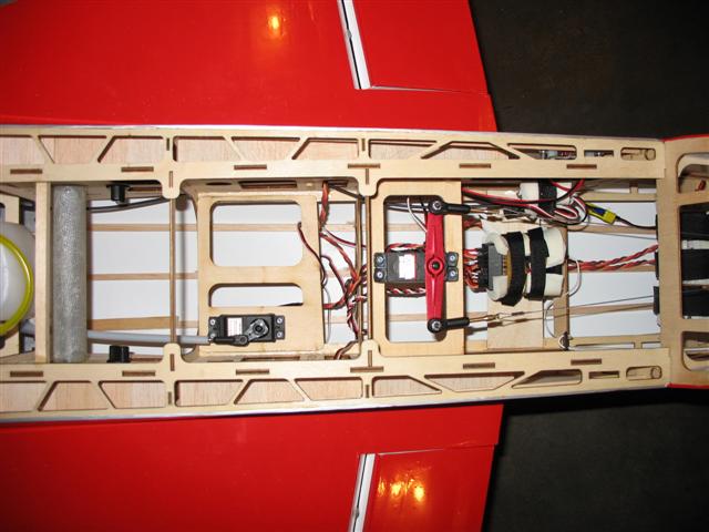

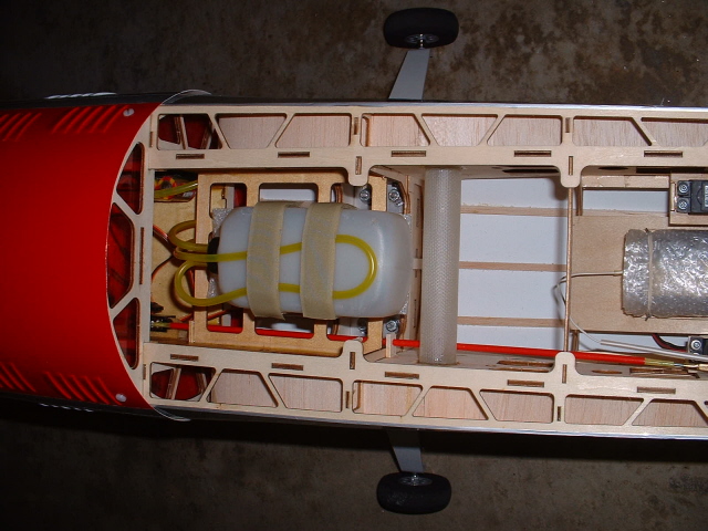

I got a first ground run with B46 on the YAK 74". I have put about .85 gal thru the motor on a test stand before mounting on the plane.
Motor is very smooth on the plane. It seems better than my 68" yak was with YS110 for smoothness.
Click on this link to see video with pull test:
http://www.rcuvideos.com/view_video....372acafe55843f
It turned the Xoar 20x8 @ 7,300 with 20 pounds of measured thrust (with calibrated fishing scale tied to back end)
NX 21x8 @6,700 with 20 pounds of measured thrust--Identical to 20x8
I did not pull back on the plane to overcome wheel friction.
Here is a list of the items I used:
E.F. 74” Yak/ Brillelli 46 combo
HT 5625’s &Airwild 1.5” arms in the tail
HT 5645 on rudder &Airwild 3.0 arm on rudder
HT 5625’s in wing & Hitech 1.25 HD arms on wings
Futaba 3004 on throttle (might go to HT425)
Four 12” twisted servo extensions
Sullivan graphite Nyrod # S584 with 2/56 ball links on throttle cable
Smart-Fly Ignition Cutoff
Fromeco Failsafe Heavy Duty Slider Charge Switch
Cheap battery packs 1500mah 2/3a 6V battery pack on receiver and 750ma 2/3aa on ignition (6oz together)
Dubro 10oz gas tank
Upsized tail wheel (from Mini 3D main gear) + 3/16oz
KAVAN 4” AIR TIRES with chrome hubs (+2.5oz pair)
Weight RTF will be 12pounds 4.5oz dry 12pounds 12 wet.
Balance point with items placed as pictured is 6.3”
I mounted the motor as far back as I thought I could--~.8 behind specs--cowl is mounted back to wing cut out.
The receiver battery is attached with silicone tubing 1/4rd out--will add a band of this to the front of the gas tank as well.
Everything is fully wrapped in foam (under Velcro)

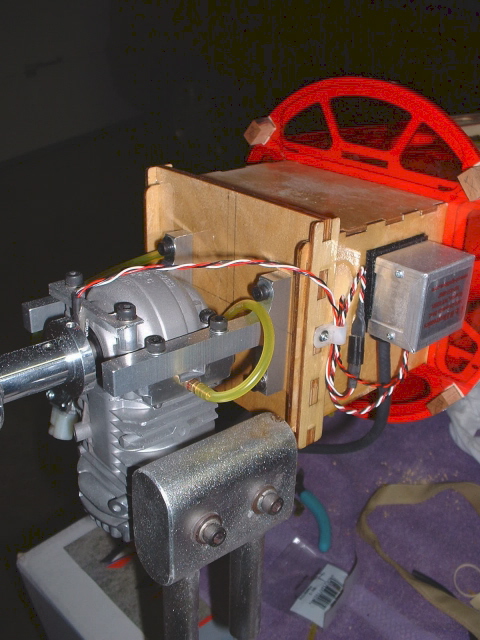

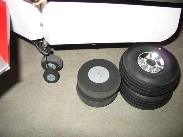

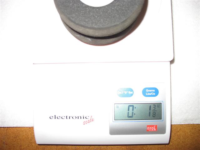

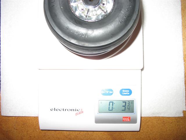

Here are a few more build pictures.
The tires came and I thought there might be a few people who fly off of rough fields looking for a taller tire. Pictures of full plane are only to see how the tall tires look.
Also, I glassed in a support bridge and went for a full exposed head. I am sure this is not necessary with the B46, but looks good to me. Cowl is only rough-cut quick job.
