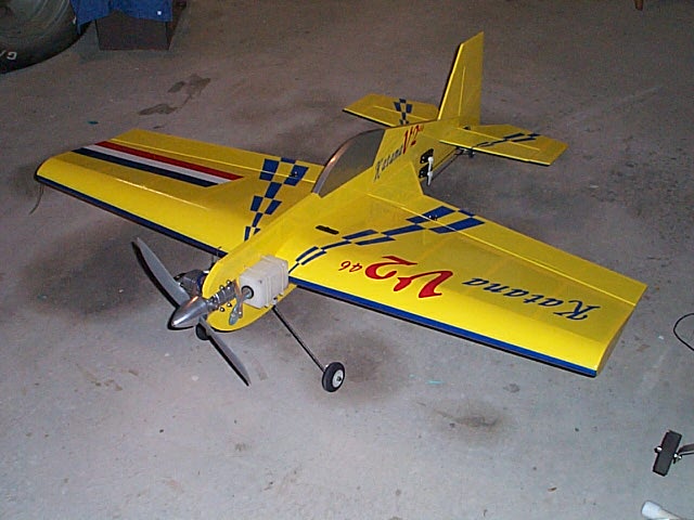

On another note... I maidened the V2.... WoW... She flys nice, only did a half a
tank on the first flt., But great inverted flat spin, nice harrier, Hovers like shes
on a wire
and almost hands off K.E. and H.A.K.E.
It only needed one click of ail and elev. for hand off flying, inverted also
And lands like silk.. I check all, It checked good so topped off the tank for a
better test... Take-off was great, But as soon as I was heading back up the field..
The YS dies and I see something white falling:-((... She takes the dead stick in
stride and lands smooth... Then I see.... No fuel tank
... Even the mighty YS
needs fuel....
I find the tank, then see that the front tank strap snapped????? No stress on it
But the worse part since the tank was full as she dislodged itself... It cracked
the tank on impact
(( So less than a tanks worth of flying.... But WoW......
I LIKE IT!!!!!!!!!!

Raideron,
My Katana V2 came in today. It's half done. Did yours come without a construction manual? Mine did, but I already HAD a manual downloaded from on-line months ago and printed it up. It sure as heck better be everything they, and you, say it is. Both my beloved Twist and Do .46 are cheaper--and appear to have a great deal more labor invested in the making of the ARF. Are OMP ARF Katanas produced in the US? I think not. So OMP's making a bundle on this bird.
So what went wrong in your construction of the Katana to get the fuel tank to fall off? Did you put the plastic strips in backwards (so they didn't catch) or what? I need to know. I'll finish the Katana in the morning. I have a .45 SuperTigre that needs a ride. A new .51 ST is on the way--and will fit the same holes if I need more power.

Hey Jack, Yeah mine had the manual.. They are suppost to have an updated
man. in the Profile OMP fourm here on RCU... I may have missed something,
But I did not see any difference between the two..
The straps were installed correctly with the thinner foam on the fuse side????
Maybe just a bad strap is all I can say?? Had no problems today with the
replacement straps and tank... But I did use velco instead of foam this time
with the straps.. My tank moved slightly from the prop wash. I guess it was
because of the backing on the foan I used.. Anyway it's still there after today

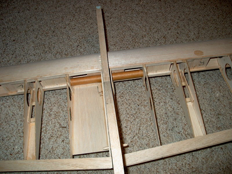

The new version has got to be heavier than the first but all around much better. I'm building an OMP Edge and doing the 2 piece wing conversion. I was going to put my Saito 72 on it but it doesn't look like the throttle will work out. My Do is running really nice lately but I haven't had much chance to get out to fly. Lots of rain here.

Hey Rob.... Your work looks good!!... Just one thing.... Shouldn't the wing tube
be a bit longer??? On the V2, the tube goes one more rib in.. And the ribs are
at least 2 sheets thick... Just thought I ask..

Yes, Raid and Rob, it took me more than four hours--with the Katana V2. When I got to putting on the control horns, those small washers and nuts slowed me down some. Then, not noticing a difference between the left and right forward landing gear, I mounted them backward--AFTER I CAed them. My manual, from off line, does NOT mention the difference and I wasn't looking for it. Weird. I also REmounted the throttle servo, putting the mount UNDER the mounting brackets, so it would line up more accurately with the carb arm.
Funny, the pictures show Hangar 9 type control horns, but the model came with black, triangular feet, with tall threaded arms, useless for large throws--unless you turn them down to less than an eighth inch between the foot and the connector. I got her trimmed out though and ready to fly, but the weather was windy and snowy, low visibility, so I put off the maiden until tomorrow--I hope.
I didn't put skiis on the V2, thinking that I can take it off the road and plop it down in snow if I have to. I have a suspicion that bird will land at less than a mile an hour in any kind of wind. With that long wing chord, she ought to float easily. Am I right?
I can't believe the throws on the V2. I suspect it's the best bird to compete with the Twist I have. The Can Dos can become hangar queens, if that's so.
I'll let you know.
