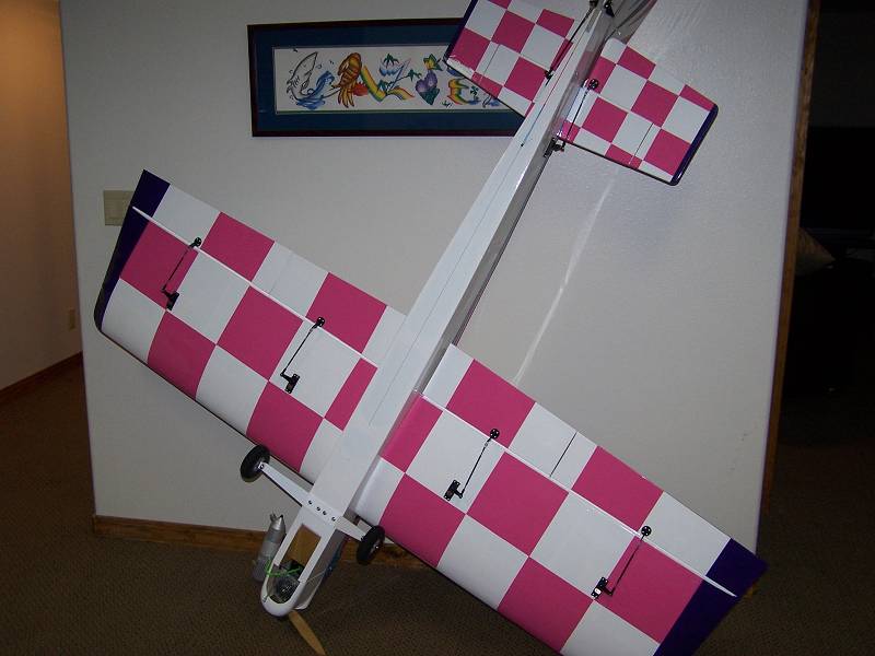

thanks Jack, all good advice, i do have a problem with working on my planes in the front living room, she sees everything[:@]
maybe i can put up a couple of locked doors and tell her its a weight room yea thats the ticket, it might work
but Ron can tell ya just how important that air comditioning vent is out here in the beautiful desert
ps. there are two more planes where the treadmill is[8D] she really isnt that bad, just gave me 1400 bucks for a new baby

Gary, at $1400 ... well, that's not a "sweetie," that's a "Sugar Momma!" And for THAT kind of money I wouldn't mind being a kept man--and would admit it to any flyer who asked.
Well done, bro!
Jack
P.S. And what did you do with the Saito 125? It ain't on the Can Do 60, hangin' on the wall. I thought that's why you bought that Saito.

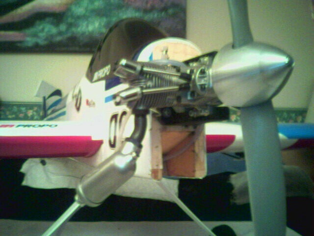

its an old pic Jack, it is on the 60

WoW Gary! That's a nice bonus or gift or something. Cool. [8D] Maybe I should have my wife talk to your wife. [X(]
Did you need to use a pump with your 125?

no pump Rob, carb is pretty close to centerline, gottta go fix a leak under the sink now

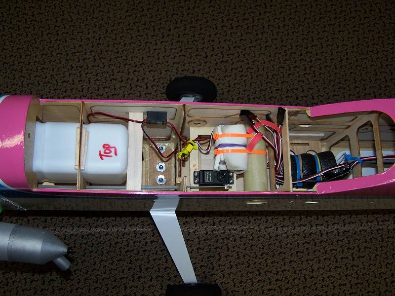

Pictures as promised.
Thanks Barry
PS: Giant with 12Z

WoW! That's nice Barry! [X(] Have fun with your maiden flight. [8D] Very cool plane!!

She's HUGE Barry!!!.... She looks great!!!..... R U sure she fits in the truck)
One thing's for sure, That engine will get loads of air... Great Job
Now the Flight report..... Hey, hold up on that inverted F.S. landing for now...
That's an unusual looking prop nut

The wing loading works out to 15.683ozs/square ft. The only thing I have lighter than that is my UCD46 at 15.2, It should fly very light.
I'm a bit disappointed because I did the break in on the engine today. It ran perfectly and idled just great. It spun the 18x6 prop at 8550 RPM. All that sounds great but my thrust was only 13lbs 6ozs. It may get a bit better. I hope so. And I was the only one there so I wasn't able to "free" everything up on the straps etc. which sometimes helps. But to put that in prespective my mighty 110s make 13lbs 0ozs under similar conditions. And the engine is a pound less weight. That means the 110 would probably fly it better. 11lbs weight with 13lbs thrust vs. 12lbs weight with 13lbs 6ozs. But I'm probably doing something wrong. I'm hoping for at least 15lbs thrust out of the 160. It may do it when I can get a helper there to assist me. Also, I might change to a 17x8 prop. I've heard those give more thrust.
Anyways, regardless, it should fly very light. And fun. I might get to maiden it yet today. I hope so.
Raideron...
She won't fit in the truck until I put it cross angle. She's big. Air flow is important. Don't want to overheat.
That spinner is what came with the kit. A polished aluminum spinner. Quite nice actually.
I'm gonna try and avoid the inverted flat spin landing.
