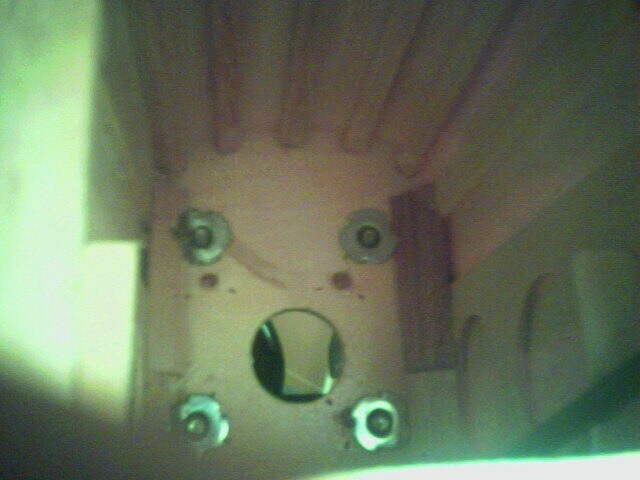

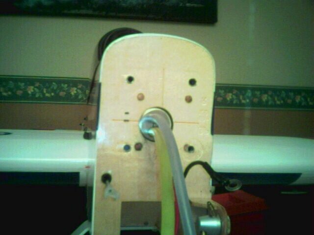

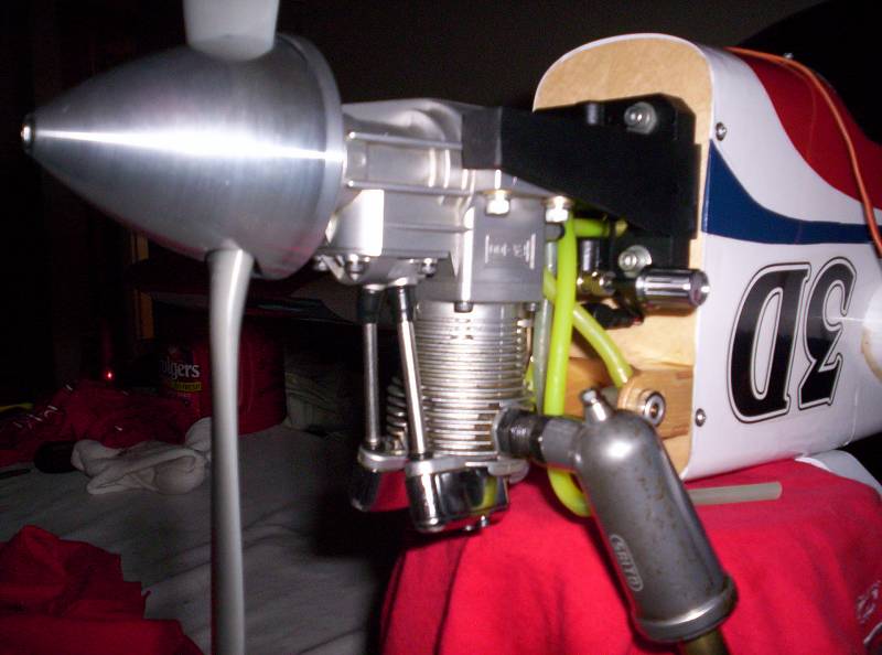

cafusin....7500= Saito 100.... IMO.... I would go with the bigger mount also....
I think the stock tk position will work... Or just trim the F.W. hole and tank saddle
a bit... You can lower the tank 1/4 or a bit more before needed to trim the motor
mount, I used the stock marks for the engine mounts... That's what I did to mine..
If you do go with the Saito 100... At least make sure you have the 10oz tank...
which will fit in the location.. Seems like a few had the 8oz tks. and the later
models came with the 10oz???... My used UCD had the 8... and now a 10oz is in
there.... The saito will run a few seconds longer

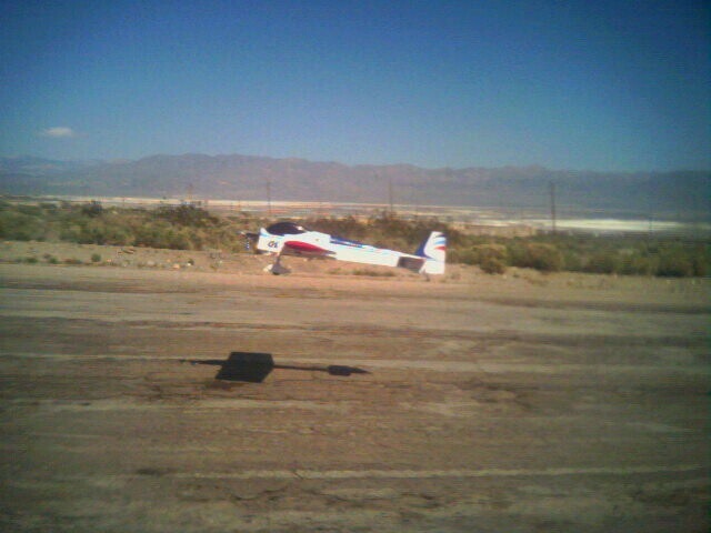

ORIGINAL: Barry Cazier
gjeffers....It looks like you have a lot of room in your flying area...Wouldn't it be a riot for several of us to meet at your field and give you some flying buddies!!! Maybe this winter. You know...when it's not several hundred degrees out. That would be cool. I could bring 3 or 4 UCDs...maybe that would be enough for an afternoon or two.
thanks
Barry
