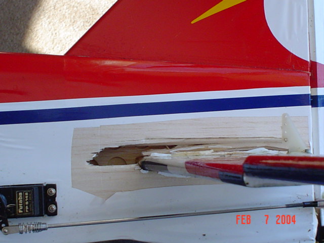

Old 02-08-2004 | 04:19 PM
  #781
outonalimb's Avatar
Joined: Dec 2003
Posts: 48
From: Jacksonville, AR
Default RE: U-Can-Do 3d 46?
this happened right after i put the 4-40 rods on. landed ok, no crash. back out the next morning. how do you like the Arkansas snow?

Old 02-08-2004 | 06:24 PM
  #782
Posts: 2,353
From: Up north, ND
i had the exact same thing happen, i actually flew a couple of flights with the horz stab completely free to move. flew ok, a little twitchy! i removed the covering and glassed the entire rear area, it will NOT come apart again!

outonalimb,
The same thing happened to mine on the first flight. In fact, it started to flutter. It ended up tearing the fues pretty bad, but luckily I caught it in time to land and fix the problem. I glassed mine back up as well...

qweedqwag,
Mine was hard to idle down at first(saito.91) but it started slowly coming around. now i can get it down low enough to stand still. it will just take time. right after i got mine just the way i wanted it the bearings went out. sent it back to horizon, got it back and had to start all over. Make sure and store that plane inverted so the oil stays in the crank case. the factory said that my crankcase was bone dry, and i run my engine super rich.
RC Havoc,
i've had this plane since oct. and this is the first problem other than the landing gear. i wasn't at home when it happened and there was not a hobby shop anywhere around. i put block brace all the way around the stab and it held up pretty good. i think i'm going to add some support wires back there too. i've heard the weedeater line works good?

Did the stab flutter because it was to weak or was it because it had a 2 stroke cranking on a 6 pitch prop creating far more speed than a 3D aircraft is designed for? We know that speed and these aircraft do not go together well. I have to wonder if we fully balanced the controls on these aircraft if flutter would be less of a problem. That is how we keep the the flutter monster away on the full size birds. My guess would be the damage was done by the flutter not the other way around.
Old 02-19-2004 | 01:18 PM
  #799
RC Havoc's Avatar
My Feedback: (-1)
Joined: Apr 2003
Posts: 457
From: Phoenix, AZ
The prop pitch was too much for the plane, but I wast flying straight and level full boar. I was actuly falling out of a hammerhead with the motor at idol. When I leveled it out, the weak balsa gave away and the stab began to flutter. I was flying slow at the time, so it wasnt due to speed.
