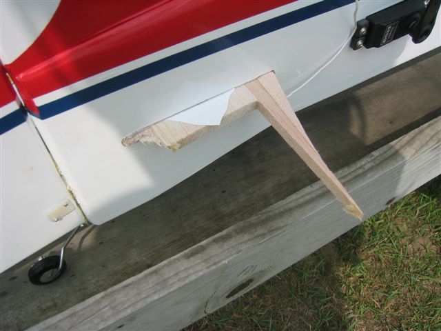

I have had two Horizontal stab's break off on this u can do 46. The first flight broke it off at 1/2 and the second flight at 1/4 throttle broke it off.
the plane has a super tiger 51 ringed and a 10-6 prop
I have 20 years in this hobby and I cant figure out what is wron.
see picture
Any ideas????

If you're flying it hard without any reinforcement, the chance of the stab breaking is pretty good.
I epoxied triangle stock at the fuse/stab joint above and below the stab on both sides, and also used kevlar flying wires to tie the stab and fin together. After 60+ flights of beating it hard, I haven't had a failure.

Port, you might want to also try APC's 12.25x3.75 prop. Everyone that has mentioned using this prop with a .40-.46 has reported the best overall thrust.
Hobby, I was going to say that the stab might have weakened from cutting the covering for glueing it to the fuse, but looking again at where it broke, looks like that's not the case. IMO, the UCD's stab just isn't very strong but when reinforced, will take all the punishment you can throw at it.

I would bet that the .51 and the 10x6 prop is the culprit. try an 11x4, 12x4 or 12.25x3.75 prop, that 10x6 at 12000rpm is producing about a 70 mph pitch speed, where most of the people flying this plane are using a 4 inch pitch prop maxed around 10000 rpm, which gives you around a 40 mph pitch speed. If your elevator linkages arent perfectly slop free, and your servos are sloppy around center, maybe combined with a non sealed hinge gap and no reinforcements, anything over 35-40mph would probably introduce flutter, and rip the elevator off. by changing to a bigger, lower pitched prop you gain alot of thrust and lose the speed~which this plane was designed for.
Half throttle may be producing a higher speed than you think with that 10x6.

You are most likely correct.
I remember heraing a vibration during my run up but wrote it off as mono coat vibrating.
I was 5 min. into the flight when the stab 's broke off, one completely and one partial, that how I got it on the ground.
The servo's are new digital futaba 3151
I did not seal the hinge gap. (very seldom do)
Thanks.
