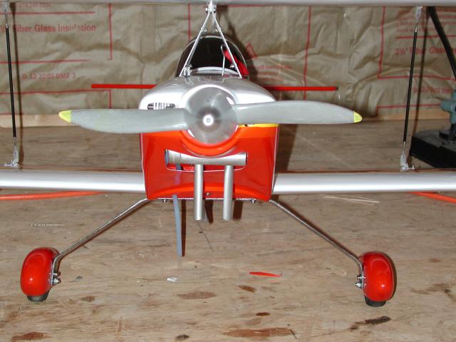

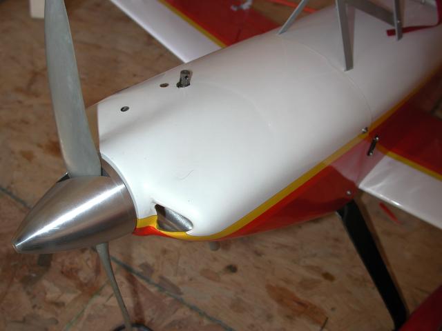

I just finished assembling my DP Ultimate 40. I used YSmans mod for the elevator servo with excellent results. Hitec 5245 all around except throttle which is a Hitec 81. I used a 6volt AAA 750mah battery pack. Everything else is stock to the kit. OS50SX with a Bisson pitts muff. 11x6 APC prop and this thing flys fantastic! 5lbs 5ozs dry. I "re-arranged " the color scheme a bit to make it at least a little original (for an ARF). I simply pulled off the yellow and orange trim and added black striping. The cowl was a little tricky. Mask the red and black, sand the yellow and orange paint off and add black. Add some decals (I had some call letters left over from an Extra I built - I know they aren't correct, but they look good) and you have a new look.
Thought this might interest someone. I'll throw in a couple of pix.

Looks pretty slick, Nice job!! I was wondering about your 5245's... I've got 2 of those which just won't work on 6 volts (the randomly glitch)... and Hitec says they're ok......but They do it on 3 differnet RX's of mine and only on 6 volts.... Thing is I see you're a JR guy and I use futaba.... but by chance have you had that problem?? or anyone else hear of those 5245's doing that?

Great job on your bipe! How did you squeeze the 50SX in the cowl without cutting an opening for the head?
I see you used DP's upgraded tail-wheel. Is that working out for you?
Are you getting good fuel draw? On my install I was worried about the difference in height between the top of the tank and the carb. As a result a used a Perry pump.
Again, nice job!
