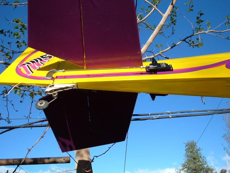

Here ya go link...
http://www.sullivanproducts.com/Land...rMainFrame.htm
Yes its free floating. Also has fantastic ground handling.
I try to barely even attach it to the rudder. They have an "L" to insert into the rudder but I dont like that. If the rudder is wide enough I make a loop in the spring wire and screw it on, but my absolute favorite way of attachment is to straighten the "L" and put it through a piece of fuel tubing, then a dot of CA on the bottom of the rudder to hold it on. This way a rough harrier landing or general "oops" that tears the tailwheel off or any bump (in a grass field) that stresses the tailwheel a lot, will not tear off rudder material or structure. Worse case is it tears the fuel tubing or if you only insert the spring a quarter inch or so into the tubing then it will twist around and the spring end will come out of the tubing.
#2787
Thanks i like those ideas they sound great alot better then the tailwheel i have were you have to drill a hole in the rudder and put the dowl in for the tail wire. Sounds great i'll be getting one. along with some other much need Hobbie stuff Seems it never ends...lol always need something..

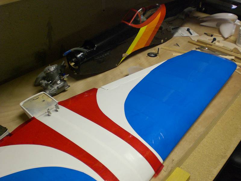

Waldo...Im rehashin an old Marks P-51. used to have 2 of em and really loved em so I got me another the other day. I do have the GP 51 up on the shelf though
Flyin off grass.... we have a nice field but still, flyin off grass I have found is really rough on airframes, coverings, and gear setups. I saw the "fuel tubing" idea and tried it with great success. Just tired of the bottoms of my rudders looking like the dog chewed on em!
Tips and Tricks keep things fun, ya just gotta find em!...remember, there are no new ideas!
It should ROG in about 10-15 feet.Waldo...Im rehashin an old Marks P-51. used to have 2 of em and really loved em so I got me another the other day. I do have the GP 51 up on the shelf though
