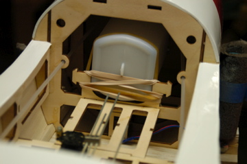

Fuel tank is complete and installed sort of. Will pull it out and take the photos for you. I like to use a two line and Dubro filler, so I melted shut the fill line. I use Airtronics radios and they have had the kill button on the 6 and 8000 models since their inception. I found using a fuel dot, if you don't close the throttle trim all the way you get fuel flow from the carb throat. Using the button closes off the throttle, when the engine dies releasing the button returns the throttle to the low idle position.

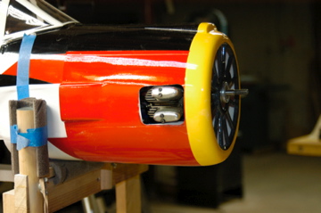

Nice gift, Dremel is always helpful. I took a couple of photos of the cowl and how I am cutting out for the engine and exhaust. Will post later

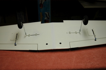

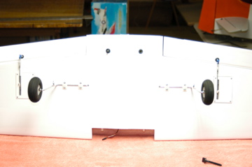

Posts: 798
From: Tallahassee, FL
Default RE: BH T-28 Assembly
Dremel rules in model building. I have 3, two cordless and 1 cord.
Here are the photos of the wing showing how the flap servos are installed. Notice both arms exit from the same side, unlike the ailerons.
I also show how I lay out for the engine cutout in the cowl. I use the paper method for all the openings and once I have a rough cut and see how it all fits, smooth out the edges.
Dremel sanding drums in different sizes work great.

Nice looking work JimO. After you draw the box you want on the paper, do you pull it out of the cowl then lay it back on the cowling with it in place and draw the box on the cowl? If that is how, Holy Cow you made that a whole heck of a lot easier.

The answer is yes and no on the layout. Because the exhaust port is located in line with the engine, I marked the location and size on the paper then cut it out. Taped the templatemto the fuse and slid the cowl on over top of the paper. Using a marker, marked the inside of the cowl and removed. Marked the approx center of the opening on the inside and made a pilot hole to fit Dremel small sanding drum. Very slowly made opening larger and slide cowl back on to make opening as large as I needed.

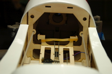

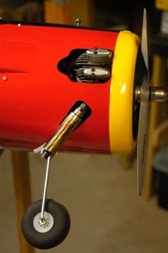

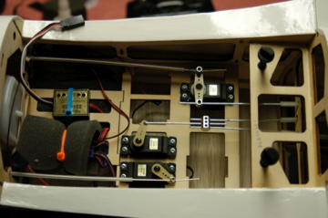

She is done except for the decals. I have included a couple of photos of the fuel tank installed and of the nose wheel block. I drilled through and used blind nuts to hold the block as I felt the firewall was a bit soft and the wood screws would pull out.
I also installed a ElevtroDynamics Servo Slo for flap control. The Airtronics RD8000 has a three position setting for the flaps and using the control allows me to bring the flaps down slowly and maintain level flight with the elevator. I will eventually mix in some down elevator via the radio once I have her all trimmed. Now for a nice afternoon with gentle winds.
Changed main landing gear to 3 inch wheels. Supplied wheels makes the nose sit high,
