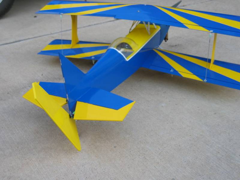

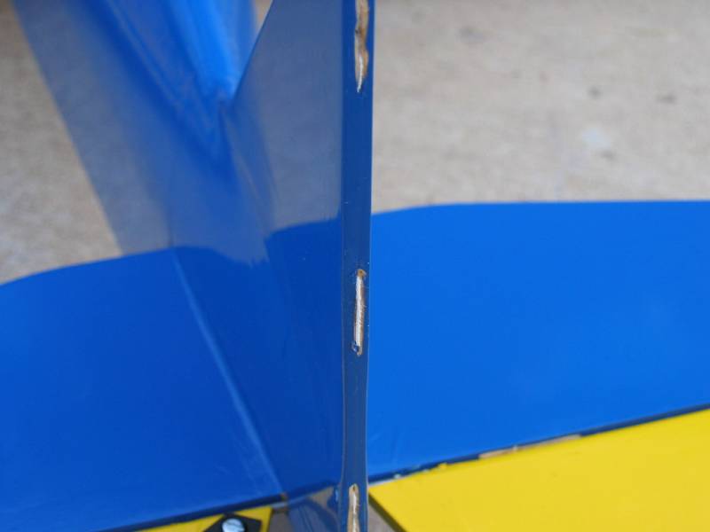

So, up until now I've sworn by CA hinges. Never had a problem, until yesterday. Granted the conditions where not the best with up to 20-25 mph gusting cross wind, but I've never expected this. Take a look at the pictures. This happened mid-air. The hinges look like someone took a #11 exacto knife and cut them off. Luckily I managed to land safely on the runway (not a pretty landing in the cross wind without a rudder
What would have caused this?? Now I'm worried about the other hinges. I have already repaired the rudder by using Robart hinge points, but it would be a pain to do that to the rest of the plane.
The hinges were installed per instructions using a GP hinge electric hinge tool to cut the slots and I did drill a hole in the middle.
thanks,
tychoc

That's why I always fly with pinned hinges - never had a failure with them. Klett, DuBro, etc. I like the hinge points, and if installed properly never seen one fail. I seen a couple of planes have flutter with hinge points and they held tight (flutter was caused by to much slop in the linkage and excessive speed in a dive on one plane).
I lost an Astro Hog last year after it went into elevator flutter - one of the CA hinges looked like it failed causing the flutter and blowing one half of the stab off. The other side had a ripped CA hinge also. (I didn't build this hog - it was from an estate sale, that's why it had CA hinges) I'll only use a CA hinge for a slow flying plane like a park flyer or glider that won't get into the speed range to create flutter.

There's no slop in the linkages, but is it possible that a standard servo is not strong enough for this size rudder?
-tychoc
The servo might be too small. Also, I only use 2-3 drops of thin CA per hinge side. Too much CA will stiffen the hinge and not allow proper flexing. Some people swear at them, some sweat by them. I've used CA hinges for over 20 years on everything from sport to trainers to pylon racers to giant scale. Never had an in-flight failure.
Dr.1
Dr.1
It's possible you may have damaged one or more prior to flight and didn't notice it? I'm not a big fan of CA hinges either but they usually seem to do OK. I prefer the hinge points where I can fit them in. Keep an eye on the remaining hinges.

A friend brought me a fuselage the other day. He had jammed the rudder into someones back while carrying it. In doing so he managed to destroy 2 of the CA hinges. I know they were OK that morning because I had looked the plane over for him before he flew it. I cut the remaining 2 CA hinges (one partially torn) and installed pinned hinges for him.
I will never use ca hinges,used them once did not like the way they flexed compared to dubro or klett pinned hinges.I have airplanes that are over 30 years old still flying with the original pinned hinges intalled and no failures or loose hinges.I do check them as part of pre flight each time to make sure,just as on full size aircraft
You said you cut the slots with a Slot Machine - That's good
You said you drilled a wicking hole - also good...
The question that comes to my mind is: Did you have the rudder flexed MORE THAN IT WOULD TRAVEL IN FLIGHT before adding the CA?
I find that this type of failure is almost always caused by this. You can't just flex the surface a little (either in hopes of keeping a small gap or any other reason), it MUST be flexed farther than the servo will move it or this type of failure is almost sure to happen.

It's really interesting that the hinges failed after only three flights. Never seen any that failed that quickly.
It appears that at least some of the CA hinges that fail were not installed in slots that were straight along the hinge line. If the slot isn't cut in line with the surface the hinge can't easily flex along just a simple fold. It'll stress from each side. I've seen a number of prehinged "you get what you pay for" models that had hinge failure and two things were common in each case. There was at least one hinge that wasn't in line, and the hinge material was the naked or slick plastic. They weren't the layered CA hinges that have wicking material on both sides.
I would hazard a guess that either one of the outboard hinges was not in line or had been nicked. Some plastics will tear easily if given a starting place for the tear.
I also wonder if some of the plastic used might not be weaker in one direction and more likely to tear across than lengthwise (or vice versa).

I have found that for me, it's as quick to use Dubro flat pinned hinges as it is to use CA hinges. I use hinge glue and it's dead easy and quick. And I've yet to assemble a pre-sliced ARF that didn't have a couple of skewed slices or slices that were above or below the hinge line and was going to need correction.
I discovered through autopsies, that CA hinges that're simply slipped into the slices through Monokote don't always wick CA into them. And drilling the wicking holes takes time that isn't needed with flats and hinge glue, so that balances out. So if I do use CA hinges, I spend time slicing away covering, and drilling wicking holes. If I use flats, I spend less time with a piece of hacksaw opening the slits. And can easily correct skewed slices or off line slices, and the covering "closures" are actually a positive. The glue gets into the slots because it's mechanically put there and the covering closing back simply helps fuelproof the area.
