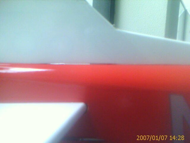

Hey guys,
I'm still trying to set up my Nexstar and I've come across a problem when installing the horizontal stab. When installing using the screws provided the stab won't sit securely, but it can wobble slightly from side to side.
Basically the screws slide in from the bottom of the fuselage and up through 2 holes in the stab which is meant to secure it. The screw's are tapered, and the rear screw is fine because it slides up far enough for the WIDE part of the screw to be through the hole, which is a snug fit. However for the front screw, it only slides up enough for the tip of the screw (the skinny part) to be through the hole, which allows for left-to-right movement. Even after I install the fin it still moves.
Any ideas on how I could fix this? Or has anyone else had the same problem?
I'd really like to find a solution without having to strip the covering and gluing it, if possible. I hope theres another way around it.
Would love to hear some suggestions. Thanks!

When you insert the forward screw through the horizontal stabilizer (without the vertical stabilizer in place) does the screw insert all the way up into the hole?? Meaning that the head of the screw is sitting firmly against the bottom of the fuselage?
Can you take a picture of the problem and post it? That would help a lot if we can see what you are talking about.

Yes, but I have to screw it in quite tightly to get the vertical stabilizer to sit flush against the fuselage. Once this is done, the horizontal stabilizer still moves.

Actually I've just checked it again. There is a small gap of maybe 1 - 2mm between the vertical fin and the fuselage. See pic.

As I understand it, the tapered plastic screws pass through the holes in the stabilizer and the clamping action is supposed to be done by squeezing the vert stab down on the stab. The plastic screws acting more as alignment pins as they go thru the stab.
Does this sound correct?

Yes in terms of the horizontal stab they act as alignment pins. The vertical stab has two threaded metal rods that stick through the holes in the horizontal stab and into the fuselage. When the screws are inserted they screw onto those rods. (the screws are hollow in the middle, thats where the metal rods go)

I dont have an o-ring but I do have sticky tape! I've wrapped it around the end of the screw therefore increasing the diameter to match that of the widest part. This worked in terms of securing the horizontal stab and stop it from moving, but is it a good enough fix ??
I'm also now wondering about the gap underneath the vertical fin as seen in the pic before, is this a problem?

The screws should be pulling the fin down tight on the top of the horizontal stab and pressing it tight against the lower surface of the groove cut into the fuse. I'm not too worried about the gap between the vert fin and the fuse if the other part is good. I'm just wondering it the bottom of the vert stab is hitting on something and not settling into place properly.
I don't know about the sticky tape. I would have used a layer or 2 of heatshrink tubing. But I have a lot of that available and many people don't. Tape SHOULD do it as long as all stays tight.

OK I've decided I will probably just secure it with epoxy after all. Seems to be the best way, plus i checked the alignment of the horizontal stab to the wings and it doesn't even align when the holes in the stab/fuselage are lined up anyway. I guess that means I need to drill the holes again as the bolts still need to fit through.
