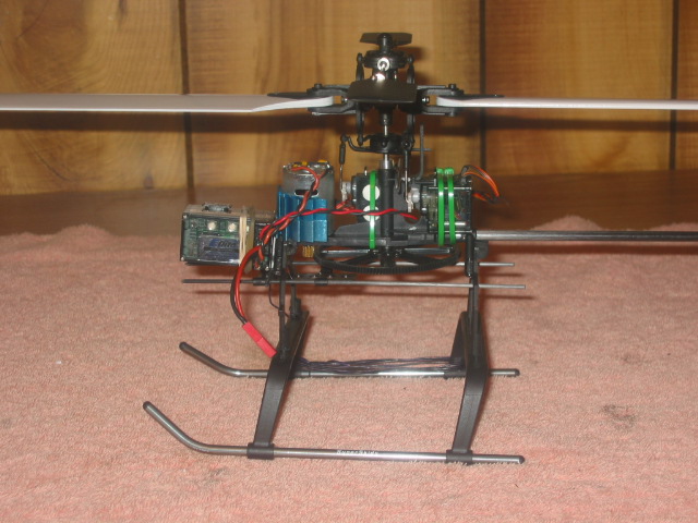

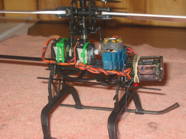

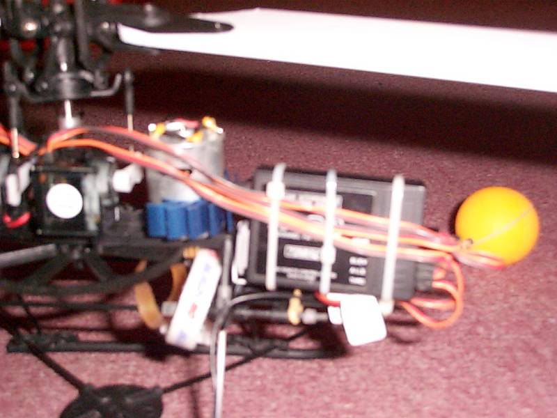

Mentioned in a few posts ago, got my heli back together.. See Pictures..
Reason for post, twisting the wires... By twisting the wire, Main Motor, Tail Motor, and all Servo wires you will get less interference. An old trick from 29 years at the phone company... Twisted Pair.
TIP OF THE DAY,
Dave / Choppersrule

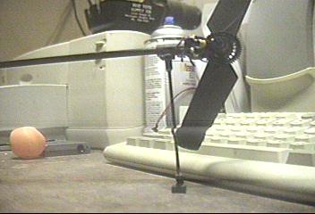

Mrasmm,
Two things to check,,,
1) make sure that the tail rotor gear is on properly, meaning that there are two ways for it to go on. The tail gear has two sides, one side has a smaller collar than the other, make sure that the smaller collar is against the tail motor.
2) Check the tail blade closely, it has two small pins protruding that align with the small holes in the tail gear. If one of the pins is missing/broken off. Get a new tail blade. Make sure everything is smushed/aligned together properly... Also, make sure that the silicon tube is tight.
Dave / Choppersrule

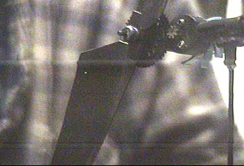

Here's a couple pics. I snapped off my tail skid yesterday...made a new one and it works fine. Also, the canopy button being used as a tail rotor nut.

Good pictures, love the idea of using the canopy grommet for the tail rotor thing.. Good tip..
Dave / Choppersrule

Actually, I think you have a great idea, I'm gonna do it.. Canopy grommet on the tail rotor... Simple and easy. Great thought.
Dave / Choppersrule

Choppersrule Here:
TIP OF THE DAY,
Dave / Choppersrule

Good tip - I'm getting more and more glitching with each flight. One of the used airframes I got had all the wires twisted and I had no idea why.
Has anyone tried one of those ferrous rings for interference?
Also I found this, don't know if it's worth the cost but there are main shaft straightening tools out there.
