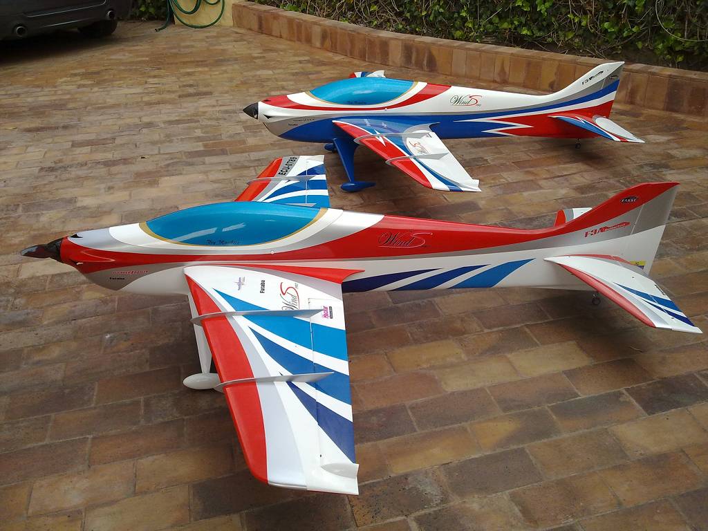

Hi guys:
Here in Ecuador we have recived now more then 5 Wind S Pro and all have the same problem. On up line the plane will go to the cabin. CG is set like in the manual 190mm - 200mm. We can´t move any more the incidents of the elevator they are all the way up and still the plane goes to the cabin in the up line. We have try to give the motor down thrust and it fixes the problem a little but it still will go to the cabin in up lines and now the spinner is not aling and looks wierd with down thrust. The only way to make the plane fly good in a up line is to give it a Th-Ele mix on full th like a 4.5% of down elevator.
General flight very good; Snaps OK, Spins perfect, Rolls very good, Stall turns perfect; only problem is with the up lines. I bought 2 planes and both are doing the same thing in the up line.
I really don´t know what elese to do.
[:@] I´m thinking to put incident regulator to the main wing to fix this problem. [
] Has anybody else had this problem? Any ideas on why and how to fix this problem?
Hope the someone can help me with this.
Regards,
Ney
Quito-Ecuador

Hello!
On the two Wind S Pro´s I`ve built this was not a problem. With the wings mounted i rigged the airframe so that the leadingedge of the wing was 2.5mm higher than the trailingedge measured just outside the fairing. The stabs where then adjusted to zero difference between leading- and trailingdege. The stab adjusters were however near their endpoint. Engine thrust is exactly as built into the nosering. CG is at 210mm from leading edge according to manual. This gives neutral elevators and perfectly straight uplines. On one model I had to adlust the angle of the left wing, the leadingedge was to high. I simple pulled out the antirotationpins and moved them as needed.
Regards Anders Johansson.

Anders:
Thank you for your rersponse. So this means that there are bad kit out there in the market. That is way all of the plane here in Ecuador have the same problem with the up lines.
This really sucks [:@] [>:] If you buy a plane that does not have a main wing regulator, quality control should be sure that the wings are 100% correct.
Now to fix the problem I have to make changes to the main wings. I´m so F..... mad. I´ve waisted more then 30 flight on each plane.
It realy sucks, now fix main wings and start all over.

Ney!
I think you are overreacting. The error was very minor. If you dont have a visible amount of aileron trim are your wings probably alwright. The error would not affect upplines as much as aileron trim
If your CG is at 190mm I would call it nose heavy. The manual says 200mm at windy conditions and 210mm at calm conditions. I`ve flown the entire season with the rerward CG witout problems. CG 20mm forward would give some up elevator trim giving you problem with uplines!
Regards Anders J
Regards Anders J

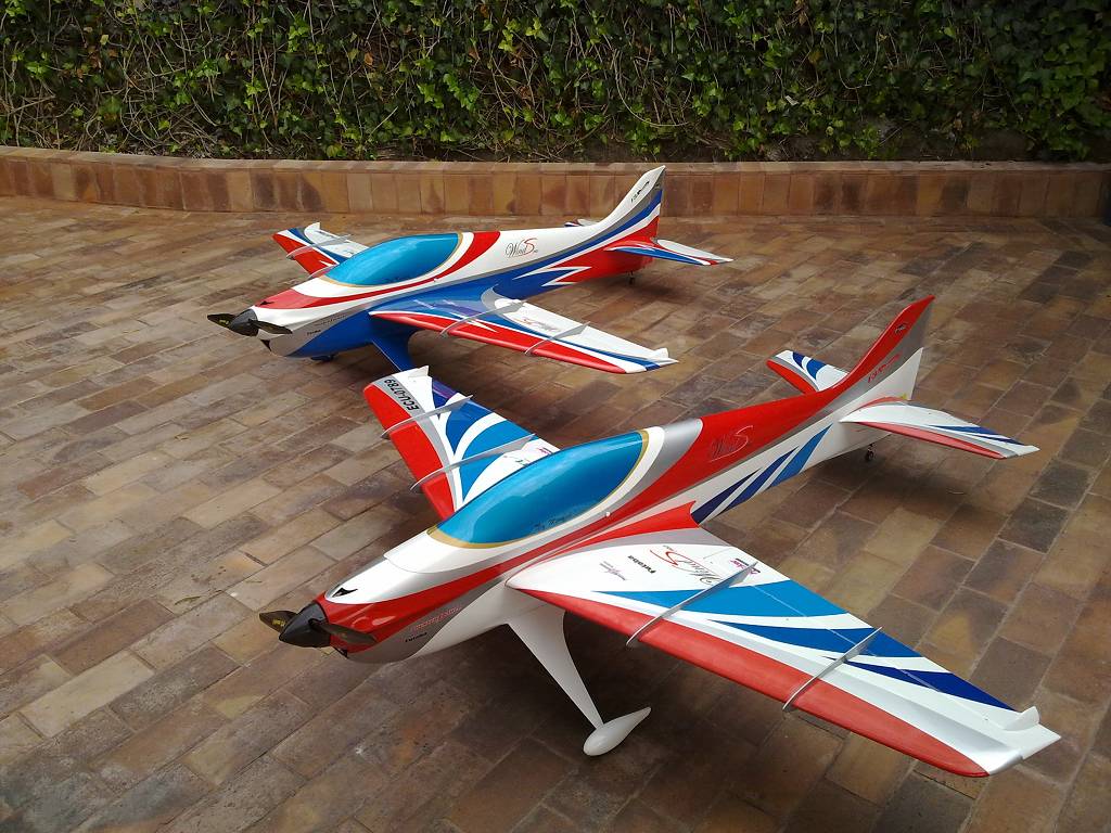

Hi Arch:
We made them all by hand. I talk to Sebart but they do not have this for the kits.
We made them from zero, only guide line was the photos I took in Portugal to Sebastiano´s planes. They really work. I love them. You will fell that you have to cut your rudder movement by almost half.
We had to do it in a try if it fits way. It took a lot of time to get them right.

hi ney,
any chance of the dimensions of the wing fences , i have 2 wind`s` pros and they both are great models , sorry to hear of your problems, your models look great!!.
regards

Hi Neil:
Your 100% correct. My main wings are all f...... up. Plane1 has the left -.02 and right side is +1.1. Plane2 has left side 0 and right side is +0.6. [:@][X(] [b] No wonder the planes have the problems that I´m having in the up lines.
Both planes have max out the elevator. It never cross my mine that a plane that come without any wing regulator can be so off in the degrees of the wings.
Now to fix the problems I will take off the down thrust I gave the motors and installed the wing regulator and put on both side of the wings +1.0.
My planes know have a CG at 210
Do you have a measurement when the elevetors ar max out, what degrees do you have?????

Steve:
I´ll do my best to try to give you the dimensions of the fences. Like I said we made them in a try if it fits way and I never put them in paper.
I will do this today in the evening and will post it tomorrow.

ORIGINAL: woodie
With the wing at +1 degree positive to the stab, what is the relative downthrust in the spinner ring?
Woodie
Team Acme LG
Woodie
Team Acme LG
My motor is at -0.3 deg (down thrust). ...That's with the spinner aligned to the nose. (...And +1 deg in the wings, 0 in the h-stab)
