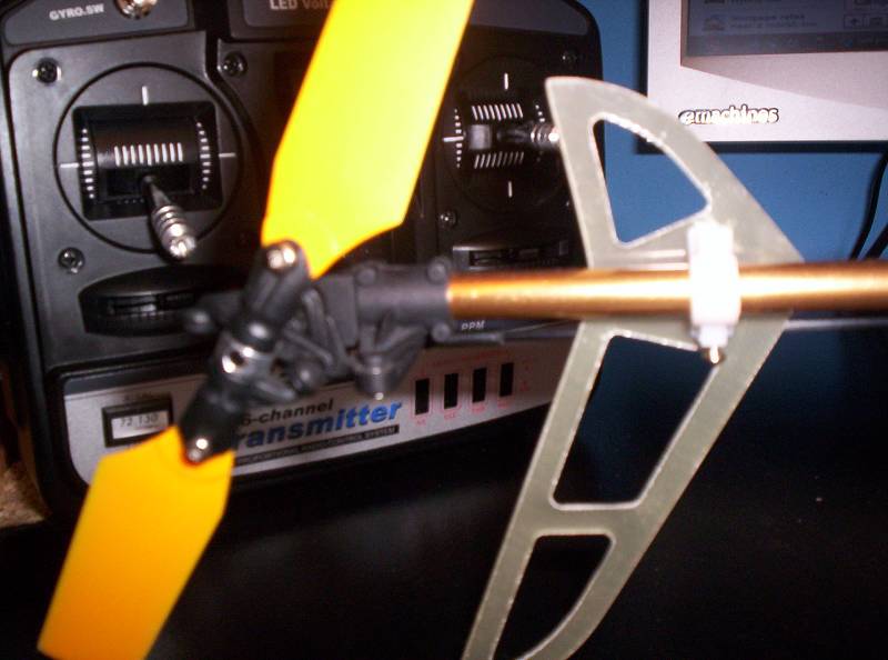

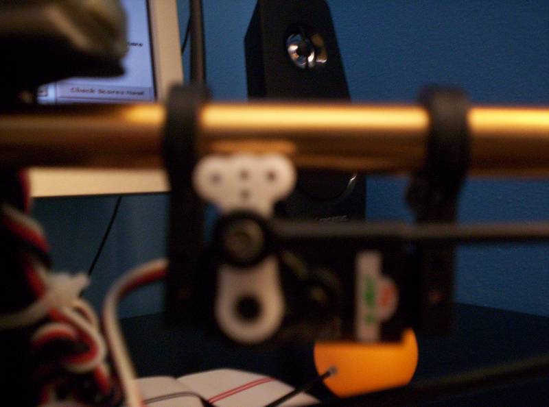

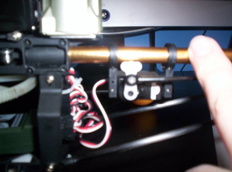

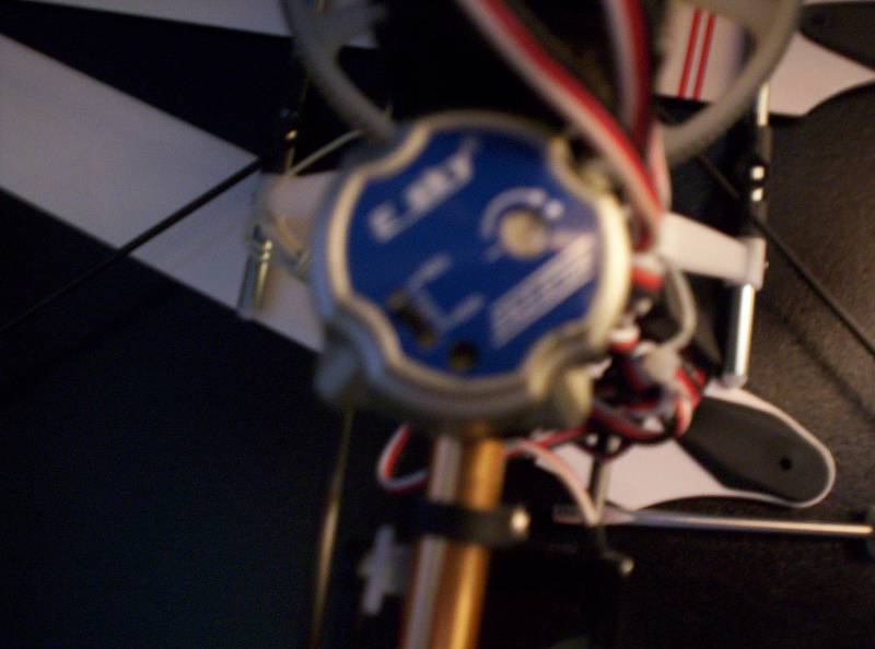

My Honney Bee King 2. Whon't Stop spining around when before Leaft. it will only spin one way. .............How Can i Make It fly Whit Out Moving to The sides Alot?

Here is a good place to start. Read from the beginning.

ORIGINAL: .:GAME:.
I was talking with this young man on another chat room. he usnderstands what and where all the swtiches are and we went over some things. The basic problem is what I had. Spool it up and the heli spins around and around. All I did on mine was put the gyro in "rev " and that was it. Not working for him. He would appreciate more help if you know.
Old 01-21-2008 | 11:22 AM
Joined: Aug 2007
Posts: 7,441
From: Edmonton, AB, CANADA
Default RE: E-SKY honey bee KING 2. tail problem. and how to make it staty.
hmmm, i was also thinking it was a gyro issue (it may still be a bad gyro but we'll check some other things). other than that it may be the tail servo is not centered.
check the position of the slider on the tail shaft and see if you have full range of motion when moving the rudder stick back and forth on the tx. the tail servo should be positioned such that the arm on the servo is at 90 deg and the slider is at the mid point on the tail shaft.

ORIGINAL: .:GAME:.
i'm just hoping that your problem has a simple fix...to see if you have a simple tail rotor rigging problem (as druss described) just feed in a lot of right rudder as you increase throttle and attempt to get light on the skids...if the right rudder stops the spinning, your problem is probably mechanical instead of electronic (which scares the heck out of most beginner eheli pilots.)...btw, if you're trying to lift off on a slick surface, with after-market heavy plastic or carbon blades, the spinning problem will be worse...just trying to help...ken

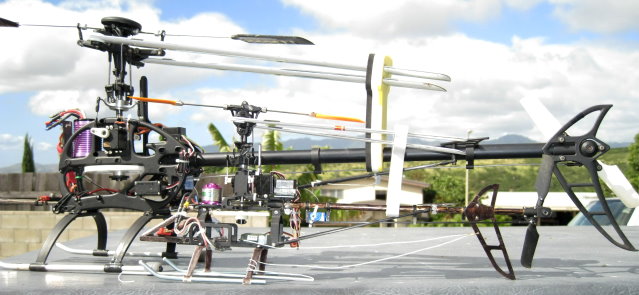

here's a pic of my hbk2 with tail mods, and one of my logo10s...amazing technical similarity...

JUST SLIDE THE RUDDER SERVO FROWARD A LITTLE AND PLAY WITH THE RUDDER TRIM VERY LITTLE ADJUSTMENTS IT WORK FOR ME!!!
all right i got it to work thankx to you all expecialy Cyclic Hardover. THanx

Interesting to see that I'm not alone with the spinning problem. I have the gyro in Reverse. Tail rotor is neutral. I start the left spin while on the floor (carpet) and if I lift off I have an amazing spinning top in the air. I have tried by passing the gyro, looking to control it manually for a test run. No difference. I moved the tail servo forth and back. No difference. Belt is tight and rotor turns counter clockwise. Using right cyclic during lift doesn't help. Everything else on the bird is set carefully to tolerance. It should fly as well as my T-Rex 450. This has me totally wiped out!
The only thing that I can come up with for a fix at this time, is that I am planning on swapping out the belt. I recently applied a lot of pure silicone lube to the belt. Although it seems tight, perhaps there is slippage. However, in watching the rotor as I am running it up, it appears to be moving fast enough. That is....it appears to be.
My guess is that the problem relates to tail authority or that is the lack of it. After playing around with the gyro setting I don't know where or how to set it properly at this point. There doesn't seem to be any mechanical end points on that setting. But then again, I don't think that the gyro is my imediate issue. Or is it??? I welcome your thoughts. Thanx.....Rich

Thanks for your responses guys. I did what you suggested and all was OK in those areas. Today I was lucky enought to have an experienced pilot give it a go. After thoroughly checking it on the bench he spooled it up on the floor. First thing was his amazement as to the high head speed. He could not believe what that ESKY BL was doing. He dialed down the throttle curve a whole lot before he found it suitable. He also did some trimming and added expo. Then he was able to do a decent hover and pronounced it flyable. All during this test run the tail remained quite solid and he said that the gyro was doing OK for a rate gyro.
When I got home I powered it up and.....surprise!. The gyro would not lock in. The light flashes very, very fast for a few seconds, then goes into flashing about each second with a strong flash. That's it. No steady light. My guess is that this gyro is a bummer. Perhaps has been intermittent? I can get a replacement under warranty. However, should I upgrade this now. I am just a beginner and perhaps not able to appreciate the finer performance of a quality gyro anyway. But reliability is important. So, do I just replace with stock and see what happens.....or put more money into it now? What do you think???.....Thanks again for your help...Rich

hi dutch...all of my helis have futaba gy401s -- except the hbk2 which uses a gy240 that i had laying around...both are heading hold, and really lock the tail, unless you give input to move the tail...wind, turbulence, or the normal wishy-washiness of helis won't move the tail --unless you command it to move...sooooo, imho, you should seriously consider a good heading hold gyro...do some research because there are quite a few satisfactory ones that hbk2 flyers use...you should be happy about this 'upgrade opportunity'...most upgrade opportunities require ordering a lot of repair parts, and cause you to regress until you regain confidence to try whatever you were doing when you crashed...lol...ken
