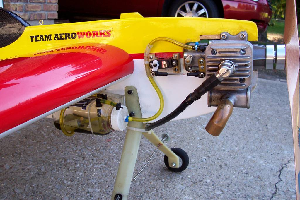

For an example of what ahicks speaks of regarding that Post #21, look over my photo showing the throttle linkage. The servo arm originally had 4 holes, but I connected my linkage closer to the shaft - cutting off the outer 2 holes of that servo arm. The throttle shaft arm on the DLE20 carb has the included fiber arm extension on it. End result - closer at the servo....farther out at the carb to get a more linear throttle response.

OK, there's 2 very different things going on here. They're addressed separately, but must be combined to smooth out what's going on.
The reason you can't duplicate that "drop" when you're on final, while on the ground, is because of the amount of heat in the cylinder/combustion chamber. It's hot from the flight, and it's either got to run rich enough to cool more quickly (my preference), or you can pull the power back soon enough to let that "drop" happen sooner on your flight path. The problem with that plan is that "drop" can be unpredictable. Jim and I have said repeatedly that the engine's low speed needs to be on the rich side, with idle speed trim adjusted to compensate. This is the problem we're addressing talking about this.
The other piece of this is the ballooning tendency when trying to use throttle to flare for a landing. That's where you need to know full power from the gassers are typically nearly all in by time the throttle is half way open. The last half of the throttle movement produces very little extra power! That engines power IS NOT linear when compared to the throttle opening! The first quarter of that throttle travel needs to be spread way out on your stick! That's the reason we're talking about having the throttle and servo arms placed the way they're suggested in the drawings posted earlier (go back a couple of posts).
In short, the most important piece of those illustrations is the fact that the SERVO arm is pointing nearly straight at the engine when on idle. Set up like this, there is going to be very little THROTTLE arm movement at first, even though the SERVO arm (and throttle stick) are moving much further.
When both of these problems have been addressed, that step in the ignition module's timing curve is not a big deal. It's not even apparent. It does take some screwing around, and the knowledge that the engine's power output does not match up with the throttle opening. It's not even close.

One thing that has not been mentioned is getting rid of a throttle with the conventional detents and going to smooth friction such as used on heli transmitters. I did this years ago for most of my radios. I firmly believe in a good mechanical throttle curve (differential) but even with that, with a course detent on the throttle stick, one click more or less throttle can be way too much. With a smooth throttle you can put it exactly where you want it. It would be nearly impossible to fly a heli smoothly with a ratcheted / detent throttle and collective stick and the same logic applies to an airplane throttle. Try it, you might like it.

The solution to your problem is really easy. First of all you have an excellent TX. The 9CAP have two mixes with curve, i think they are mix number 6 and 7. You can set the throttle as a master and one aux channel (7,8) as a slave, you can connect your throttle servo to the slave channel and program that curve. This trick works perfect to me.
