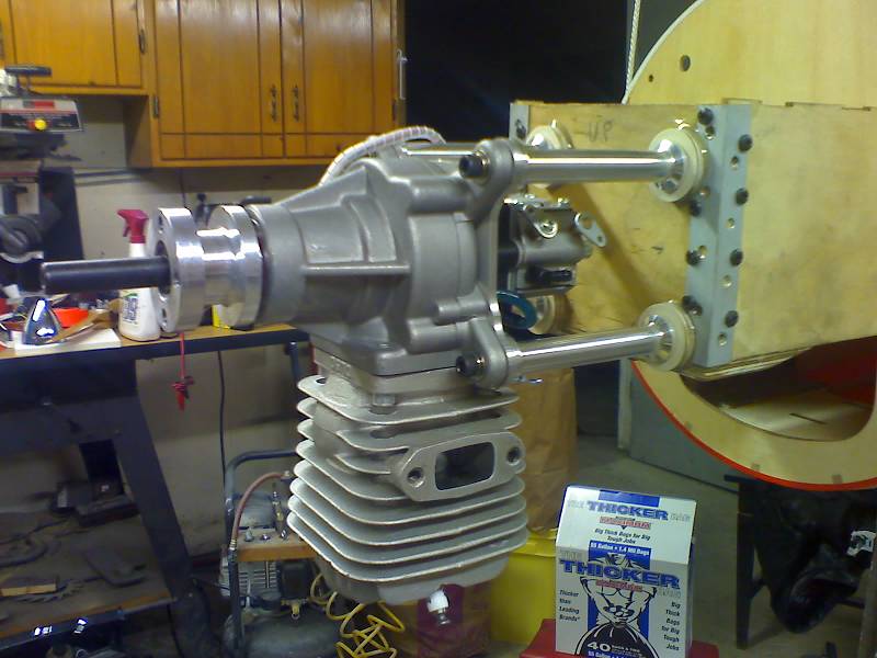

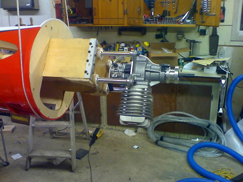

When I mount my new DL50 should I cut a hole in the firewall for carb air? If I do need to cut a hole will I get gas spitting back through the carb to soak my motor box? This is my first rear carb (reed type) engine.

This questions came up earlier. I cut a hole in my firewall just in case, but others have said that if you are at least 3/4 to 1" away it shouldn't be a problem. I probably would have been OK without doing it. Maybe Bob P will chime in.

I have "assembled" eleven DL50s in a variety of ARF airframes (none were mine so far). If I find the clearance to be less than 1" I cut a 1" diameter hole in the firewall. I seal the hole with CA and then glue a 1/4" thick peice of open cell foam on the inside of the firewall to keep the inside of the motor box clean. The foam will catch any fuel spray and dirt from entering through the hole but still allow air flow to the carb. The foam is replaceable if ever it need be.

I have two of the Dl's and i do not cut any holes in the fire wall for the carb if you use the stock standoffs or longer. I don't think you will need a hole. I mounted one in an airframe that already had the hole and got alot of fuel inside the fuse from spitting fuel, so i cut a piece of balsa and caped the hole off and sealed the wood. All is fine with mine now.

I cut no holes.
