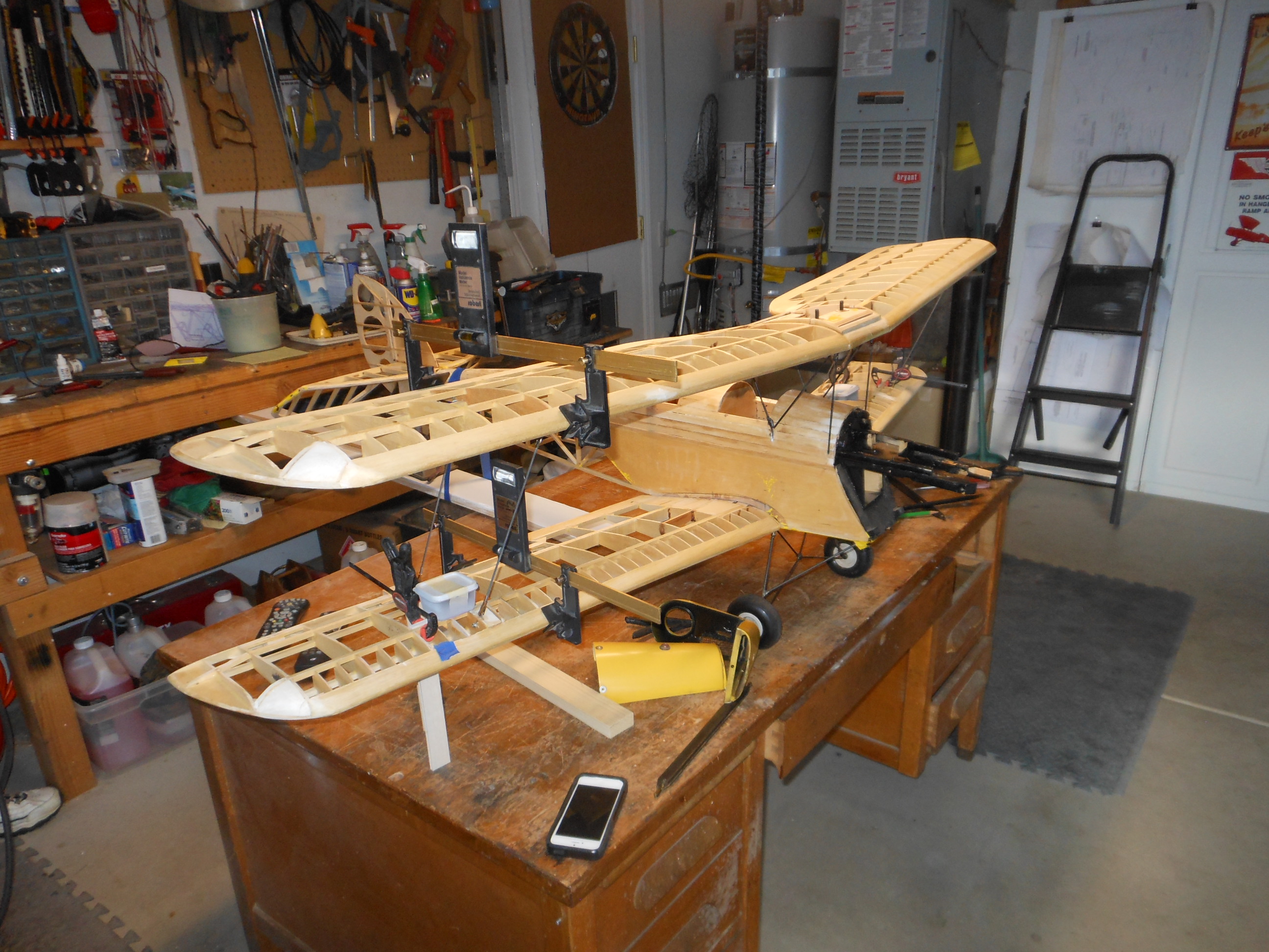

Hello all, I know this is an old thread but I thought I would give it a go, I have what I believe is a Premire Tiger Moth, the structure was mostly built by a pro and finished by someone who had no experience. So I have removed the covering and am repairing everything and found that with the stab a 0 deg I have an upper wing incidence of -6 deg and a lower of -2 deg. I think this is incorrect but I have no manuals or plans, it should be about 0 on the lower wing and a minus 2 on the top, sound about right? I would gladly pay for a copy of the manual for this plane as I need control throws also, thank you.

It's been too long ago so I can't remember the build but it seemed to me the bottom wing and stab were both at zero and 2 degrees on the top wing.
I also don't recall the nose/fire wall on mine looking like the one you have. Doesn't mater if it's the same kit or not though, it's a Moth. The sides your missing were just 1/16 ply cut to shape.

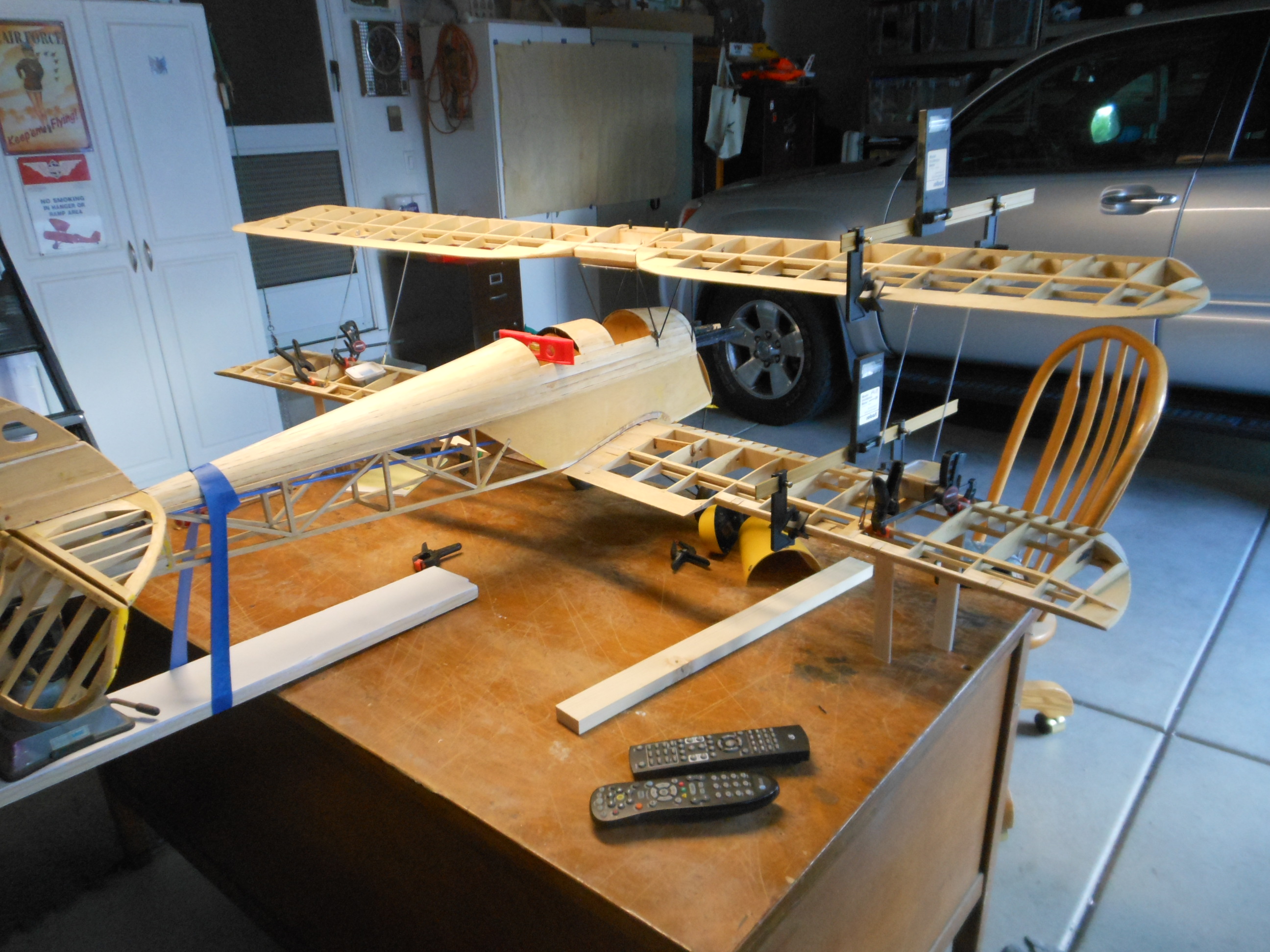

The top wing on mine I THINK ended up as +2 degrees with everything else set at zero but it's been 10 years sence I built that plane. As I recall I had the blue prints tacked to my wall level at the datum line then measured the incidences with my meter and set the plane accordingly. I don't recall the incidence stated in the instructions.
During my Bipe years I often set all incidence at zero then changed them during the trim flights until I gave the planes what they wanted.

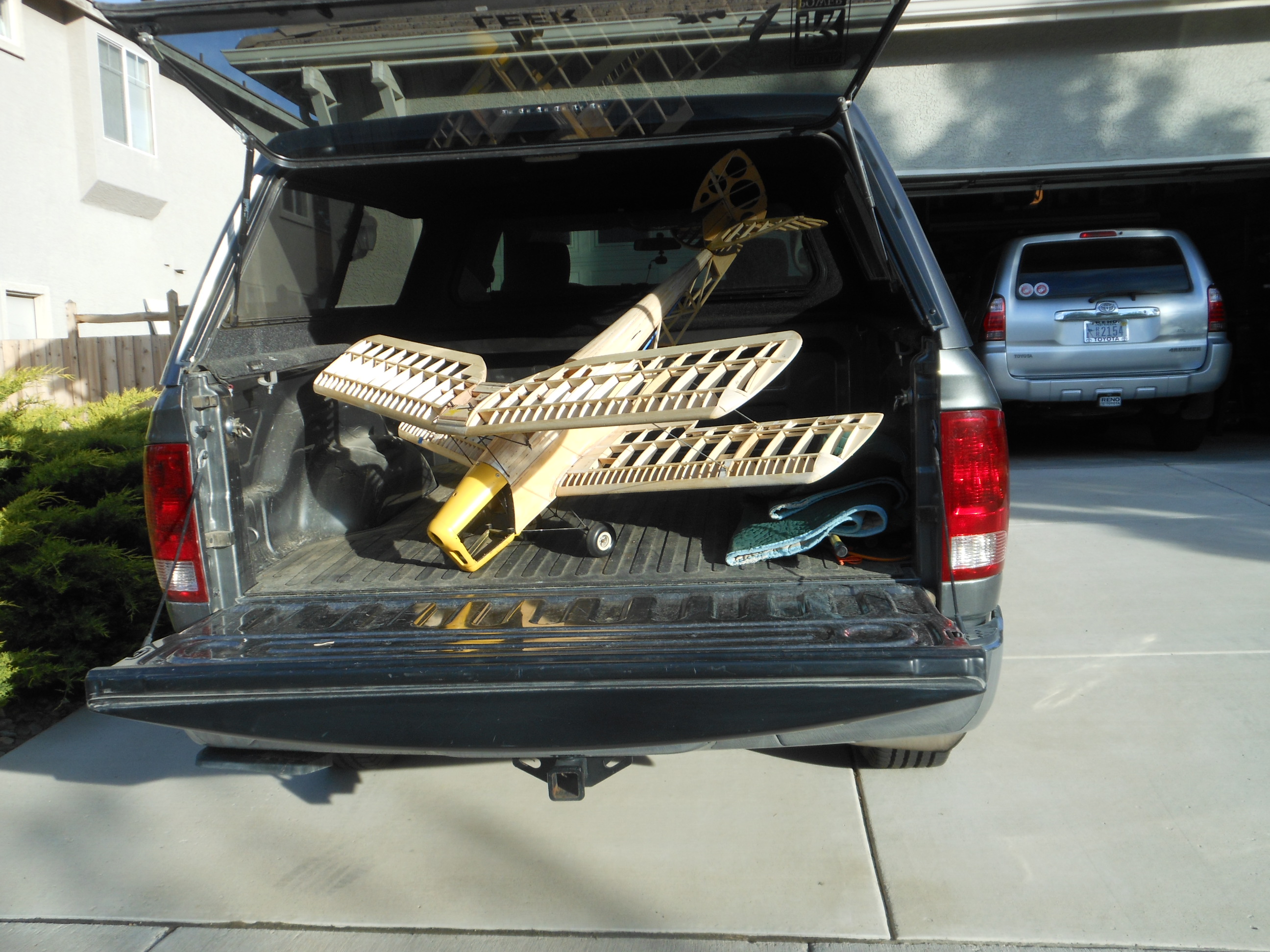

This airplane will fit assembled in the back of my truck with a shell, nose down kitty corner type deal, I am hoping, I had a BUSA 1/4 Pup that would fit that way. I removed the wing to fuse fairings as they were misaligned and I thought stopping the wing from seating all the way, no help. What I did find was misaligned and "wallered out" holes to accept the wing L.E. dowels were keeping the LE from seating all the way into the wing cutout, gonna go mess with them and I should be able to hit that target 0 deg. In the past few years I have had a love affair with British airplanes, Have a TF Sea Fury, scratch built a Brian Taylor Hurricane that took forever to build, re-learned the density altitude lesson on it's third flight and put it in. When this Moth is done I want to build a DH Dragon Rapide while a Byron Corsair I waited forever to get sits neglected in the corner. Thanks for your input Gray Beard, ever in Reno check out our club, we have a beautiful paved runway out in the desert, John.

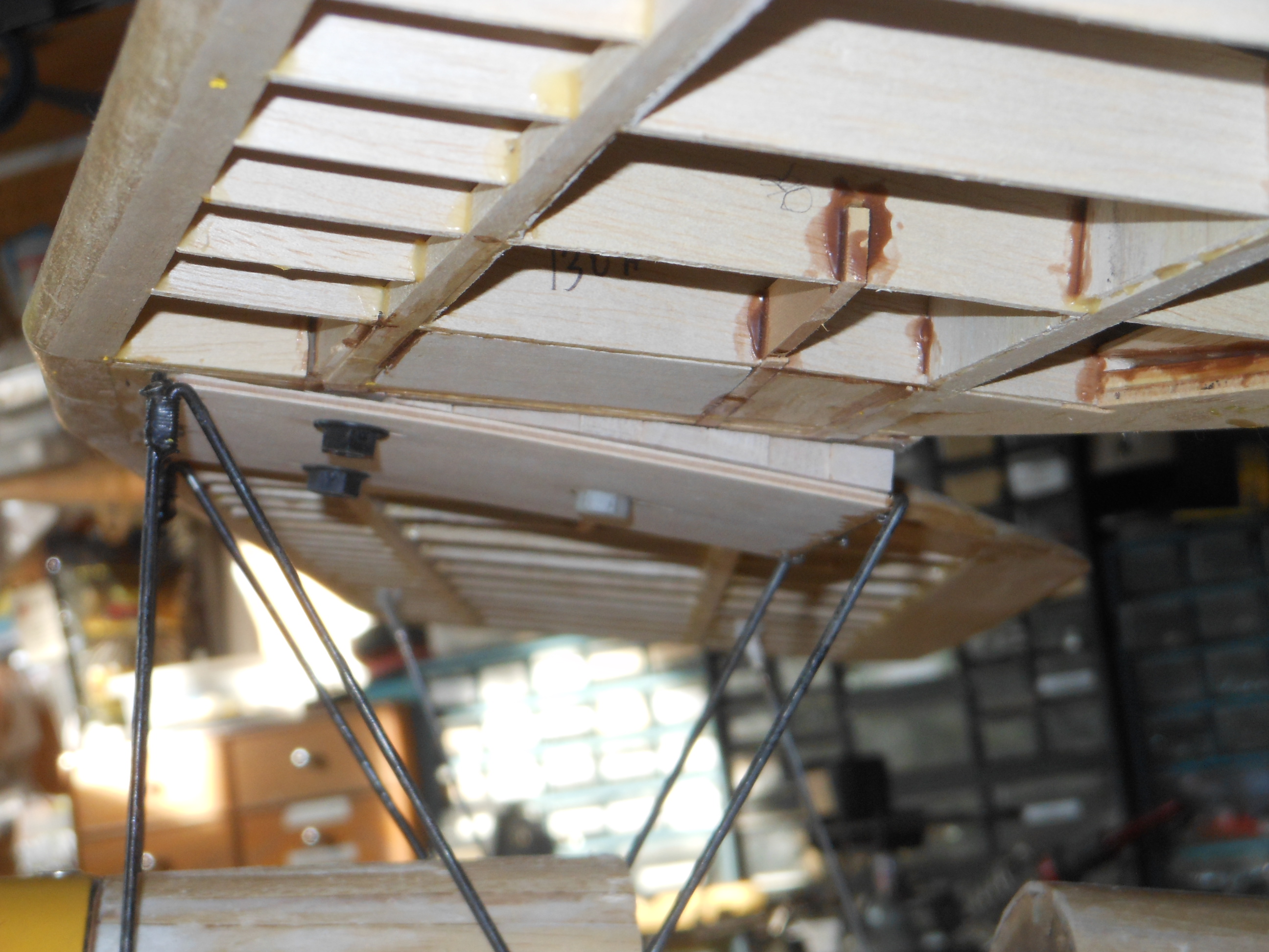

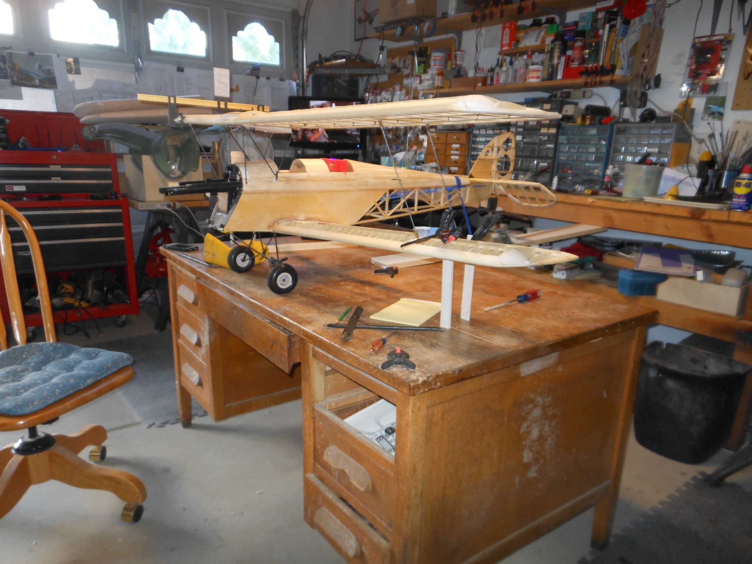

Finally got the incidence set correctly and strut length correct. Just have to add the strut wood. I didn't think about it before hand but look at the size of the shim I had to make for the top wing to hit -2 deg. Maybe this is not a Premire kit as the cabane struts are fixed at that angle, Flair 1/4 scale has odd wing incidence but I don't know if they made one in this size. Either way the stab is 0, lower wing 0 and top wing is -2 deg. Made sure it will fit assembled in the truck so I can go ahead with the rigging etc. Thanks for your help Gray Beard.

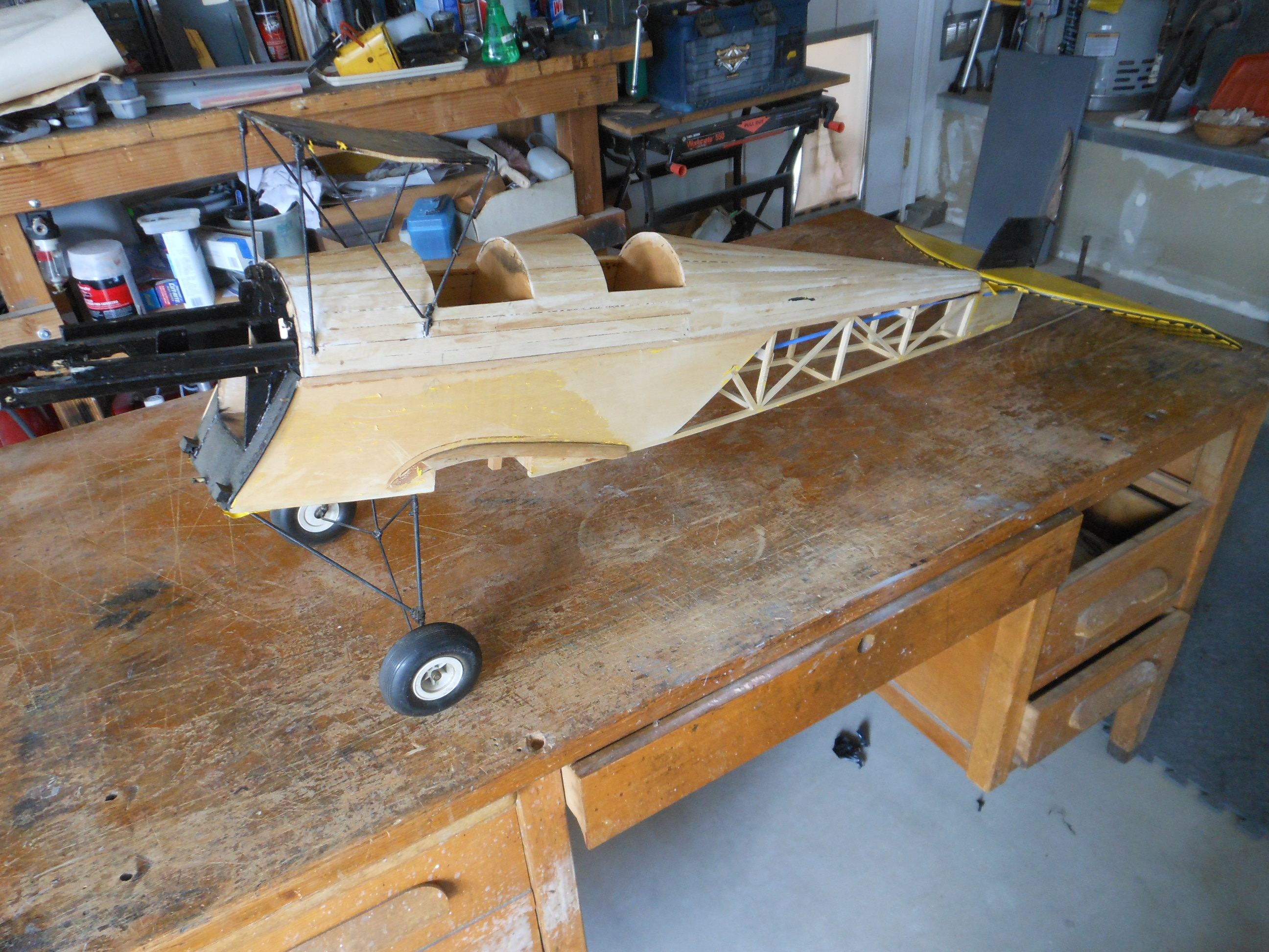

Hello Nick, no I did not, I have one very faint side view drawing is all. My model was started by a very good builder and finished by an arf foamy guy, no building experience at all. I bought it and did the best I couuld with using the pre-soldered center cabane incidence angles and some down in the motor mount. Did not fly well, climbed with anything much past 1/4 throttle. I believe the stab incidence is way off, if I remeber right it is about 5.5 degrees leading edge down. I am about midway thru on a Byron Corsair build and when that is done I will remove the stab and reset at 0 deg. The airplane is about useless as it is, but very pretty in the air, John.

Hi John,in the instructions it shows as 5deg right thrust but no down on the engine, just the engine mounted on the engine bearers which probably why you are climbing when you go past 1/4 throttle,and i believe the right incidence is 0 for lower wing and Stab and the top wing should stall first at +2 or minus 2 , i am not sure which it is that makes the wing stall first , i have recently purchased 2 of these kits of Ebay as i think i got lucky so i do have plans as well as instructions, i have taken pics of the instructions if you want them just email me and i will send them to you no worries.
