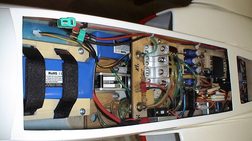

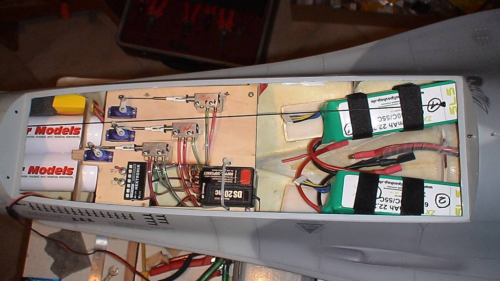

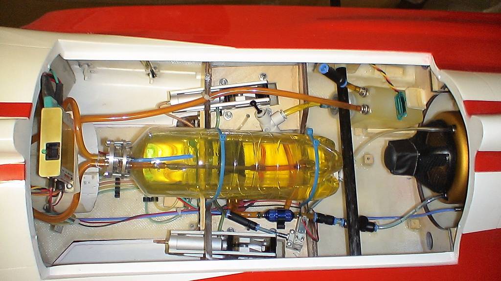

Hi from Germany,
yesterday i had the first tubine flight ever with my Skymaster JAS 39 Gripen and Kingtech K80E
. The flight itself was awesome, very good combination with the Kingtech.
I flew from our local Grasstrip and had no problems at the start, but after landing and cool down phase i tried to start the turbine again but unfortunately the Starter Motor blocks.
I put the turbine out of the plane and see that the front Turbine wheel rubs a bit on the side. I now wait for an answer from Chuang what to do. I use Diesel with 5 % Aeroshell Oil.
I think i must send it back to Taiwan for repair [
I attached some pics from my installation.
Best regards
Reinhard

Rliebl.. you're using HXT9g servos for your actuators? Are they performing ok? just a little surprised they'd be on a turbine.... but gotta say i do use them alot myself alot as they're hard to break....

i got a message from Taiwan, they send out a new Turbine this week. I would say this is a top notch Customerservice, what more can i say, unbelievable.
