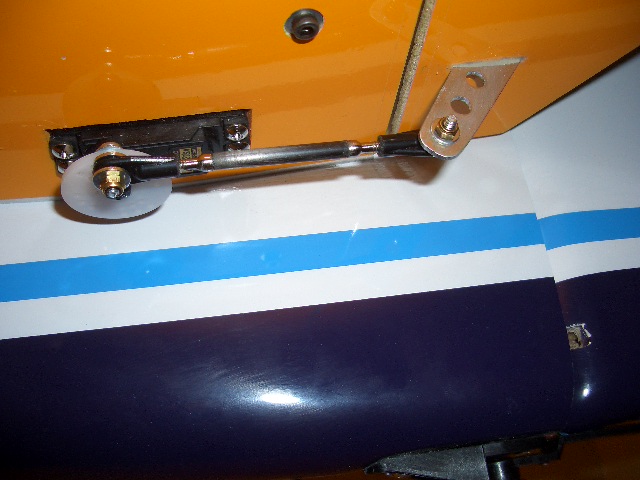

Hi Rune,
I mounted the servo`s in the tail as you can see ( JR 3421SA ), with ferrith filters. I also mounted the battery-pack far aft . (picture shows an early stage of the building process ).
I did an initial test of the CG, and now it seams ok for test-flight ( hope next week if the weather keeps ). It balance at approx 180 cm, which i think is a good starting point ...

Hi Guys,
The reason for this set up is that i am using YS 160 with hattori short muffler ... I have carefully measured the CG under the hole building process to avoid additional weight. The target for the CG have been 180-185cm , that seems a good starting point ...
The JR servos weight is 1.0 OZ each ... good performance for the job and fit perfectly without any cutouts in the stab.
The last thing i installed was the battery-pack which are a Lithium-Ion 2200 mah , weight 100 gram ... The fastener of the pack will also reinforce the horizontal web , but i would have no problem without also ...
Now the CG is 180cm without any additional weight installed ...
The rest will show when starting the new program FAI- P-09
Kjell Olav
Kjell Olav

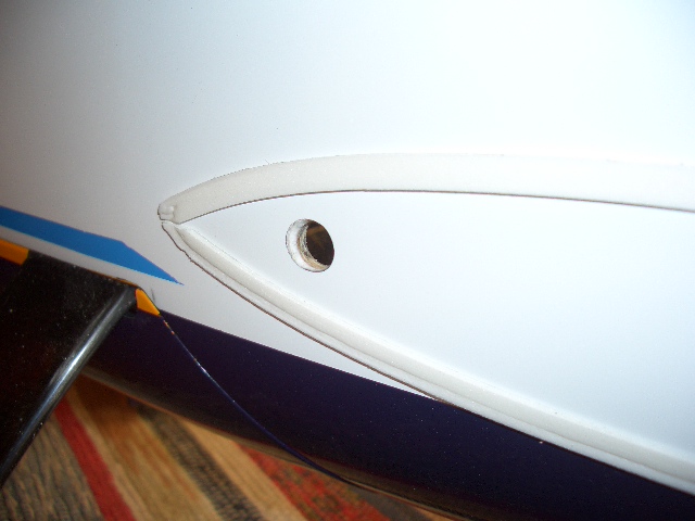

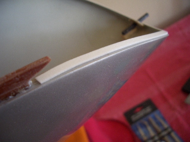

#419
Hi Ram,
Here you can see the main wing and the canopy isolated ... The stabs is done in the same way.
To me, the band seems made of a rubber/foam combination. It is a Hayes product sold by Tower Hobbies and my Impact have got this for about 2-years / 200+ flights and still keep the band like new , and it have resisted the oil/fuel ...
The installation is straight forward my cleaning, marking the contour with a tiny pencil and attach the band.
A trick on the canopy, since the clearance are small, is to attach only one-end of the band, then stretch it about the twice the lenght, and you can easily adjust the thickness of it. Now It will stay in this position, not flex back like a rubber band , and then you attach the rest of the lenght.
In my opinion, this isolating is highly recommended . The construction will be a lot more quiet, and you save it for dangerous frequensys by a stroker, specially the 4`s.
Hope this help
Kjell Olav
Hope this help
Kjell Olav
