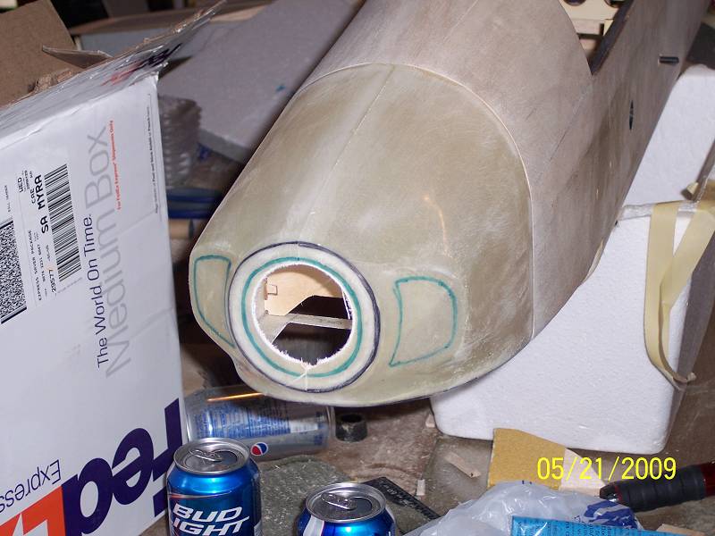

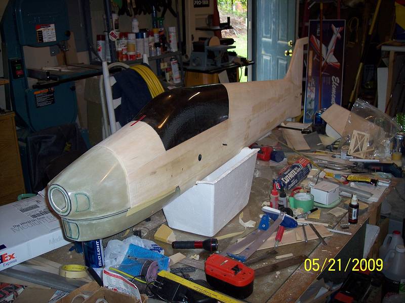

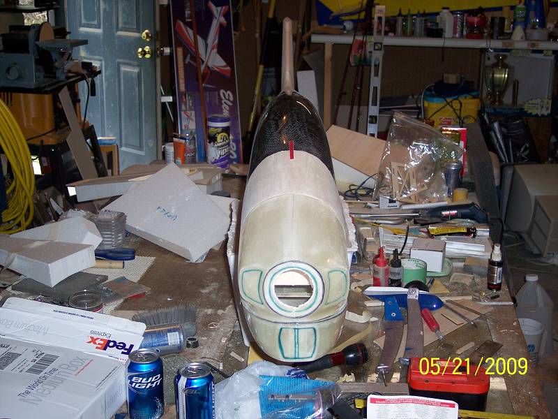

Some photos of my VF3,...I did not do the hard stuff like the frame work, sheeting etc.Here are some of the things I've finished so far and now I have to pull the YS170 out of the Partner to get the cowling correct.
Best Regards,
Bill Holsten
Advantage Hobby &amp; Fliton Field Rep/Duaralite Batteries/Custom Airframes of America/Dragon Fire Customs/Guardian America.

Old 05-21-2009 | 06:20 PM
  #1146
MHester's Avatar
Posts: 2,707
From: Woodstock, GA
Default RE: Black Magic VF3 Build Thread
Slow and steady. Working on planes and new stuff. Keeping kits available. </p>
Right now, trying to get one built for the Nats for me. The VF3 prototype was totalled at Lakeland. So, after building 22 of these 3s, it's about time I had one for myself. That's priority one. Right this minute I don't have anything to fly. THAT ain't gonna work.</p>
There's stuff cooking over here, but I learned my lesson about saying anything too soon. So, I just haven't had anything to say really. Nothing before the nationals in July for certain. And more than likely not then either. But rest assured, I'm not sitting around watching TV over here, I'm busy [8D]</p>
-Mike</p>
</p>
Old 05-21-2009 | 06:21 PM

Oh yeah, looks GOOD Bill! You may beat me after all!!!! LOL</p>
</p>
-Mike</p>

Old 05-21-2009 | 06:53 PM
  #1148
AmericanSpectre505's Avatar
Joined: Mar 2007
Posts: 1,238
From: Fayetteville, NC
Well Mike,...I had a huge head start,..........thanks. You need to take some time for yourself to get yours done. I know it's a difficult thing when you have to fill orders. You are always welcome to fly mine at the NATS if you need it,...really. I hope to have #2 painted before the NATS and done if I can get my hands on it in time.</p>
You can always fly my secret weapon,..........I'll bring the Partner for you,...LOL!!!</p>

That looks real good the Bill and the mount thing, was it on the money? I looks like it to me. I hope to get mine ready by Andersonville, it may be more of a back up for Chris at NATS. Great job and get some pics up soon.
Larry
