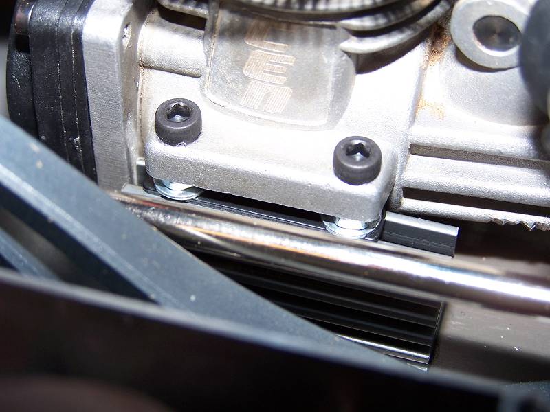

OK, next problem... The Mach backplate seems to require quite a bit of extra space over what is offered by the engine mount...
I was hoping 2x of these little brash washers(which I was planning on using with the Picco 28 in the LST2...) on each screw, but I would need to use four on EACH screw.. Furthermore, I would need to use 20mm screws for the mounting to the engine, instead of 15mm... I have neither enough washers, nor enough 20mm screws...
What would be the best solution here?? Go get some more washers and screws?? Try to find some extra spacer plates, or what... The difference that needs to be made up is a good 3mm.. Is that too much to raise it??
Here's what it looks like with enough spacers for the engine-mount to work..:

same thing I did and it works fine, look

Mine is not a mach it is a cen.28. What I found out is with the kits they come with motor mounts to use bumpboxes therefore you would just have to put a block off plate on the back of the motor and it does not hang low but the motor is lower so the bumpbox can reach the flywheel easier. They were not designed for rotostarts or pullstarts. Had this problem with me Losi 8ight buggy.
That spacer might work but its from a different car. What would be easier is to get the motor mounts from the hyper ST RTR. They would be taller and let you use your rotostart without spacers. I had to buy the RTR mounts for my 8ight buggy to solve that problem.
What you have already done will work just fine if you leave it like that. Yes I did use loctite but do not know what size screws, they were longer than the ones provided though.
Old 11-27-2007 | 09:03 AM

Well I just tried with both my Axial 28 and my Picco 28, both with PS backplates, and they both fit perfectly...
That suggests that maybe the RTR mounts are just the same.. If the stock - what is it, SH 28? - engine doesn't have a huge backplate like on the Mach, maybe the RTR mounts are just the same as the ones I have now...
I measured about 3mm difference with the MAch, and that spacer is 3,15 mm... Sounds right...
I think I may throw one of my Axials in the Hyper to just try it out in the winter, etc.., and wait to break the Mach in in the spring, so I've got time to find the solution..
I bet the solution is just that plate too...
