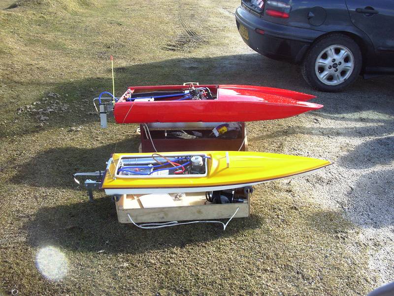

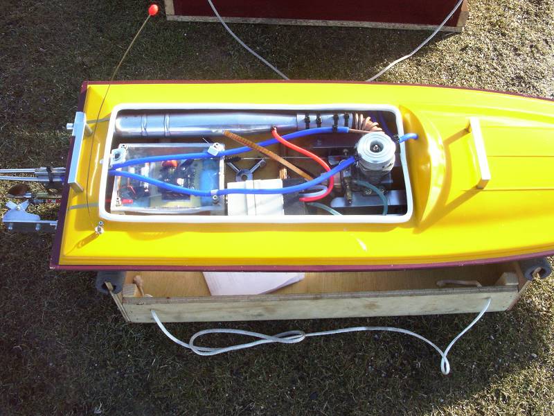

Its A Cirrus 44" Super Tigre 90 Converted to marine
I tried it today and still no joy

Here are the pictures of the cirrus
